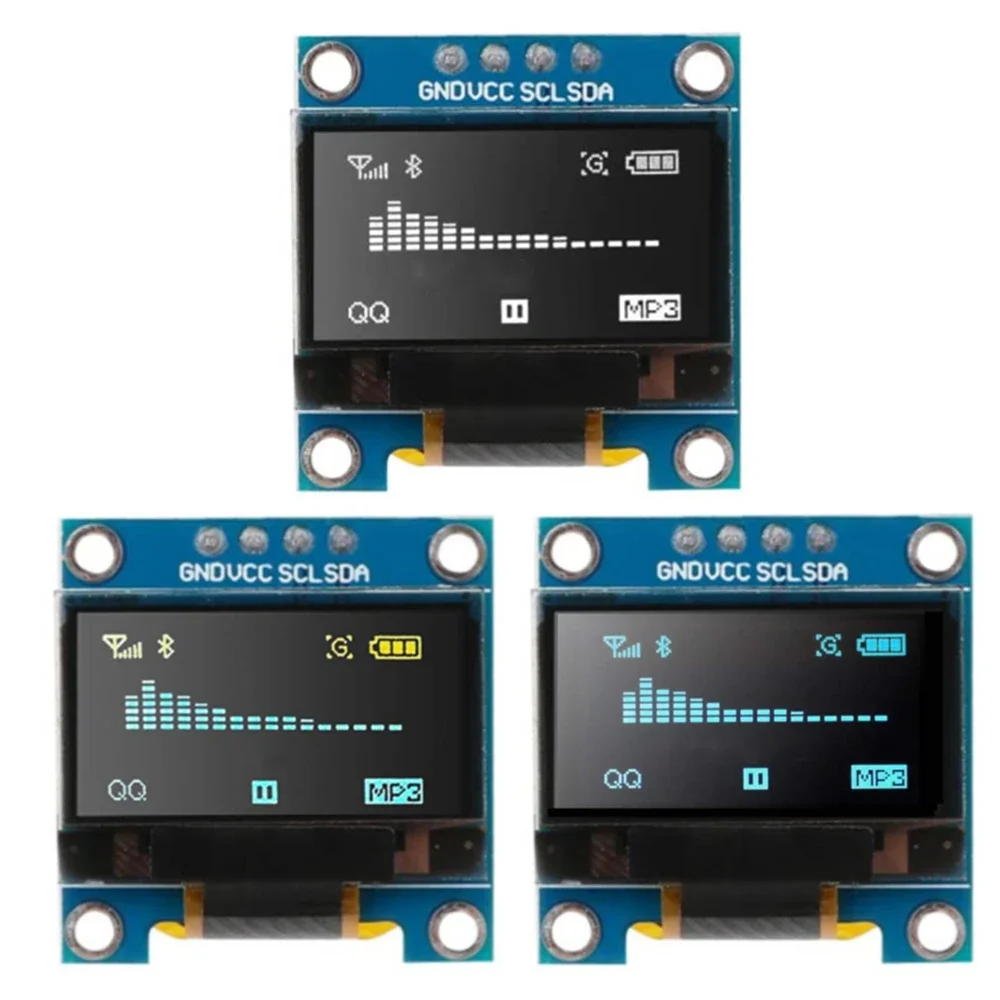

OK . I’ve never seen anything under 2 euros. but at Ali it’s around 3.5 euros.
Thanks .
But this is 0,96 inches.and no ship to Germany from this seller
I have 1.3 inches.
