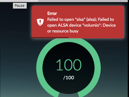

version 1.0.14 installed now also the mpd oled does not turn on again that alsa error.

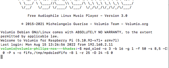

Does this work? mpd_oled -o 3
where do I enter/check that via ssh?
Just into the SSH terminal. I want to check that mpd_oled actually runs. You can copy and paste the command into a terminal window.
nothing happens, not even with sudo in front of it.
Schermafbeelding 2022-08-15 om 15.31.02
Nothing happens on your OLED? You should see a clock on it.
yes the screen turns on (clock) after that command.

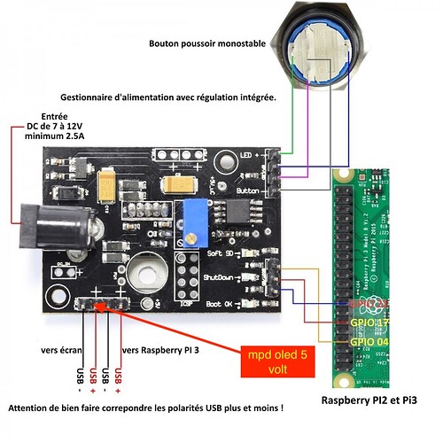

I use the 5 volts of an audiophonics power module, maybe this is just a bit too much voltage, but according to the specification OLED should be possible.
