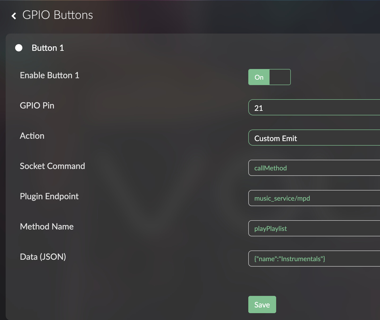

Please forgive me being BRAND NEW here, I think this plugin and Volumio is the exact thing I need to make a super simple music box for my father-in-law who’s on hospice and dealing with mild dementia. I’m trying to make something that will allow him to pick from maybe 3 playlists just by pressing a button for each. Maybe one more button to pause/stop playback.
I’m waiting on my buttons and jumpers etc to come in, but trying to wrap my head around the setup beforehand, and I’m hoping that this is exactly what the “Custom Emit” setting is for.
This is what I’ve come up with based on a couple of days of forum reading. I’m not seeing how to access the plugin config files that everyone is posting so all I’ve got is a screenshot of the GUI. Should this work in principle? (I’ve got the music collection on the SD card in the RPi and it’s indexed and working fine)

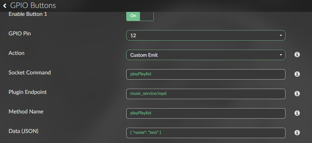

Replying to myself here, it looks like I don’t need to actually use the callMethod to mpd, I can just use “playPlaylist” as the Socket Command. Still don’t have my buttons set up to test. Makes me think it would be amazing if you could test the button functions from the UI at some point.
I’m BACK with buttons. And trying to use the playPlaylist function when setup exactly as described in the documentation (leave endpoint and method empty") throws a red on-screen error in the webinterface “custom emit requires endpoint and method” when I press the button.
Is this a bug with the settings menu for the emit function that I could work around by writing the config correctly myself?
Try it like this:
Socket Command: playPlaylist
Plugin Endpoint: music_service/mpd
Methode Name: playPlaylist
Data: {"name": "Instrumentals"}
That did it! Thank you!

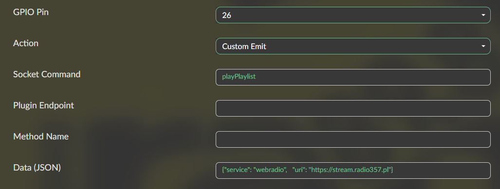

Hello All,
I have a problem controlling internet radio playback with GPIO buttons. I’d like the button press to start playing internet radio stream. GPIO wiring works fine (controls volume up or down).
I’m trying custom emit with following parameters:
It seems not working, how to investigate that?
Any other ideas?

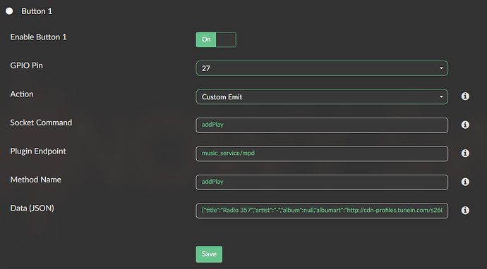

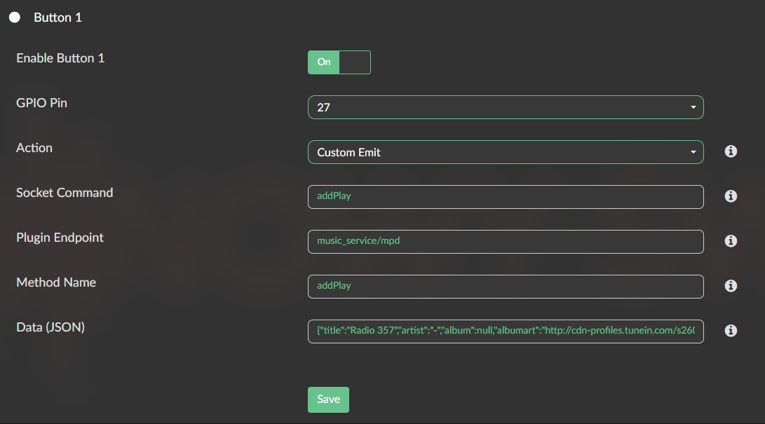

Answering to myself as apparently playPlaylist is not a proper command. It always plays Pos 0 from the current playlist ignoring specified uri.
addPlay does the right job even when other streaming is already playing in the queue.
Is there a way to clear the queue and add new stream in one button command?
