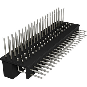

Did a quick check and the problem is that the script reads/act on GPIO status, which breaks peppy_meter. Don’t have a quick solution in place. (Placed some test code below in this topic)
Get a silent FAN, so the noise is very low and you don’t need to bother on the coding part.
Or get an extension cable, so the hat can be place sideways and you don’t need a FAN.
