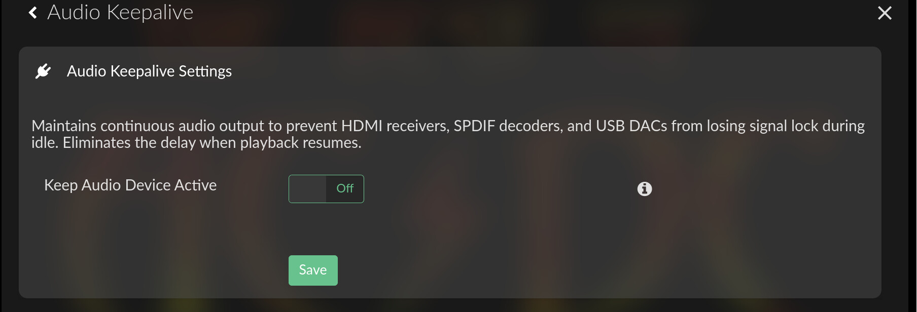

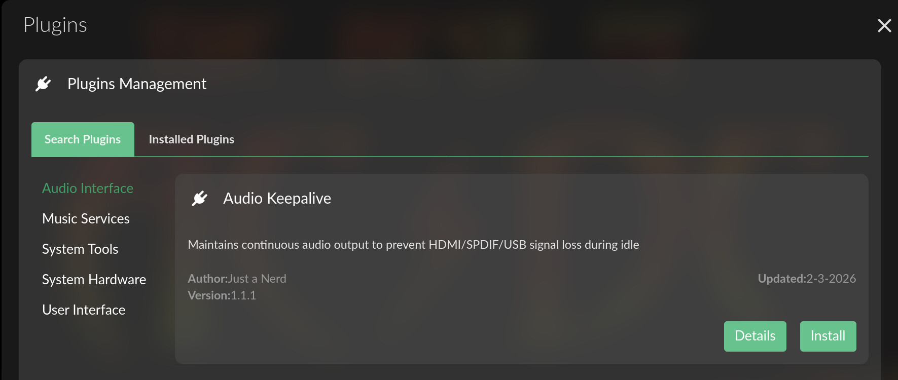

The plugin is in the store as beta, v2.0.1. Same install process as before - plugin store, Audio Interfaces, Audio Keepalive, install, enable, toggle on. The plugin now also installs a system service that runs independently of MPD, Spotify, AirPlay, or whatever else decides to make noise. If MPD restarts, the daemon does not care. If you switch from Tidal Connect to local playback, the daemon does not care. It has one job and no opinions.
