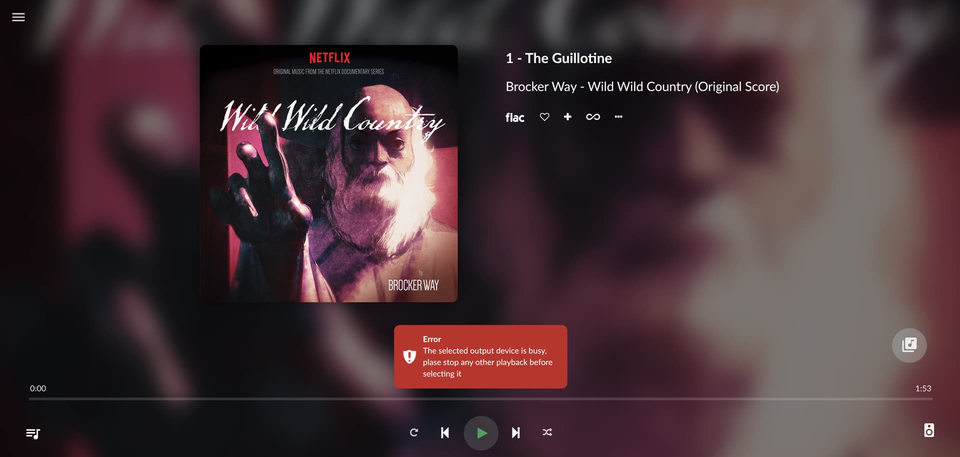

Well, I forgot to do the steps one by one, but basically I removed the previous version, rebooted, installed the new version, rebooted (maybe it’s not needed, I’m an old guy so it’s a habit I picked up from the Windows 95/98/2000/XP/Vista/7/8.1/10/11 days), and proceeded to press play on random albums I remembered starting with sound from the very first second (classical music is not always great to test this, because the guys that produce those albums are smarter than most, so often times they leave 2-4 seconds of silence on the first track).
Unfortunately, nothing happens. The receiver receives a PCM 2.0 signal, but there’s no sound coming out. I did several reboots, and by the end I had disabled Fusion DSP and resampling. But it seems clear: if the plugin is enabled, nothing happens. It also seems to butt heads with something, because I got this error many times when trying to load some other song:
This never happens if the plugin is disabled, or with previous versions, but since you mentioned that you changed everything, that makes sense.
I did generate a log, which you can find here: http://logs.volumio.org/volumio/nC7XUFI.html

Sadly I don’t have a lot of time today, but just tested the new version, and there’s nothing coming out yet.
I just sent you a report: http://logs.volumio.org/volumio/gzF0Y8J.html
