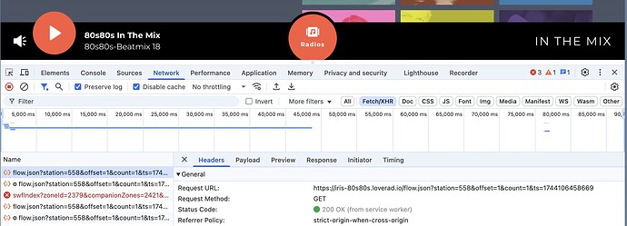

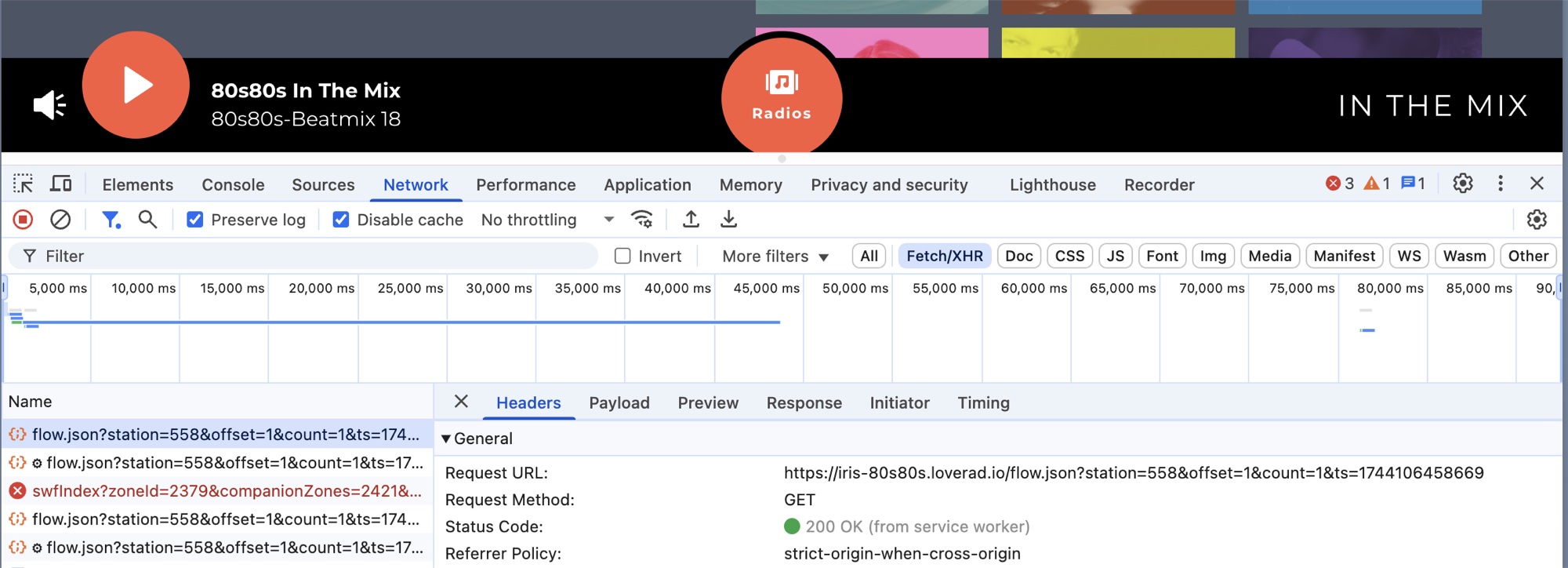

Concerning your question: you can just open the web developer tools in your browser and then navigate to the 80s80s homepage and start the needed channel. This way itās quite easy to find the channel number and api endpoint URL. For āIn the mixā, itās this one:
https://iris-80s80s.loverad.io/flow.json?station=558&offset=1&count=1&ts=1744105992560
The āIn the mixā channel doesnāt have detailled track information, itās basically always something like ā80s80s-Beatmix xxā.
