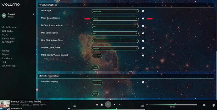

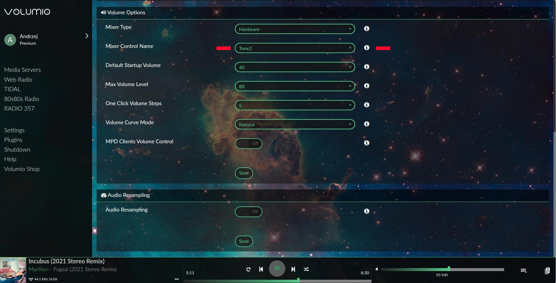

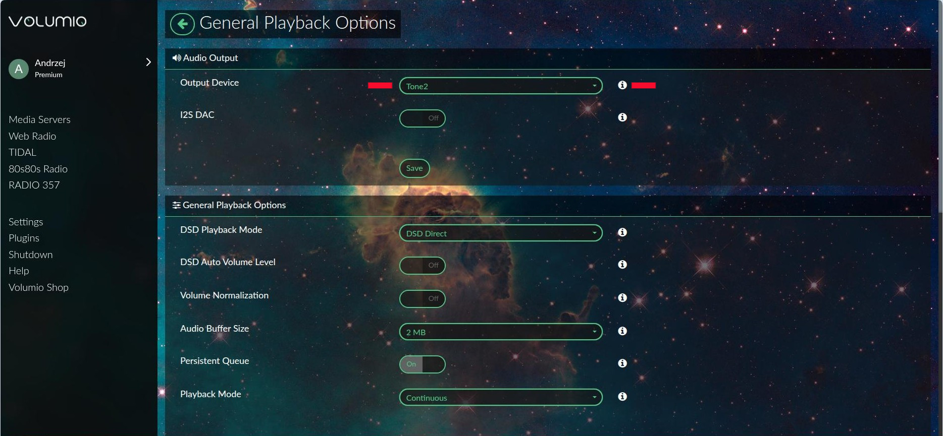

I have a Khadas Tone 2 Board Kit DAC connected to Volumio via USB - Photo.
Connect the Raspberry Pi to the Yamaha via USB.
On the Yamaha amplifier, select the USB DAC playback source.
Then, in the General Playback Option section of the Raspberry Pi, select the Output Device (your device, i.e., the Yamaha, if available).
The Raspberry Pi will only play via the Yamaha USB DAC if the USB DAC source is selected on the Yamaha.
After switching the Yamaha amplifier’s source to a different source, the Raspberry Pi may not detect the Yamaha USB DAC.

Success via USB!!! Once I set Playback Option > Audio Output: I2S DAC Off, Output Device listed the Yamaha USB DAC as an option, selected that and it works! Sounds fantastic, though I can’t say if it’s better than Digi coax in. Using USB IN frees up the single coax input on the amp for something else.
