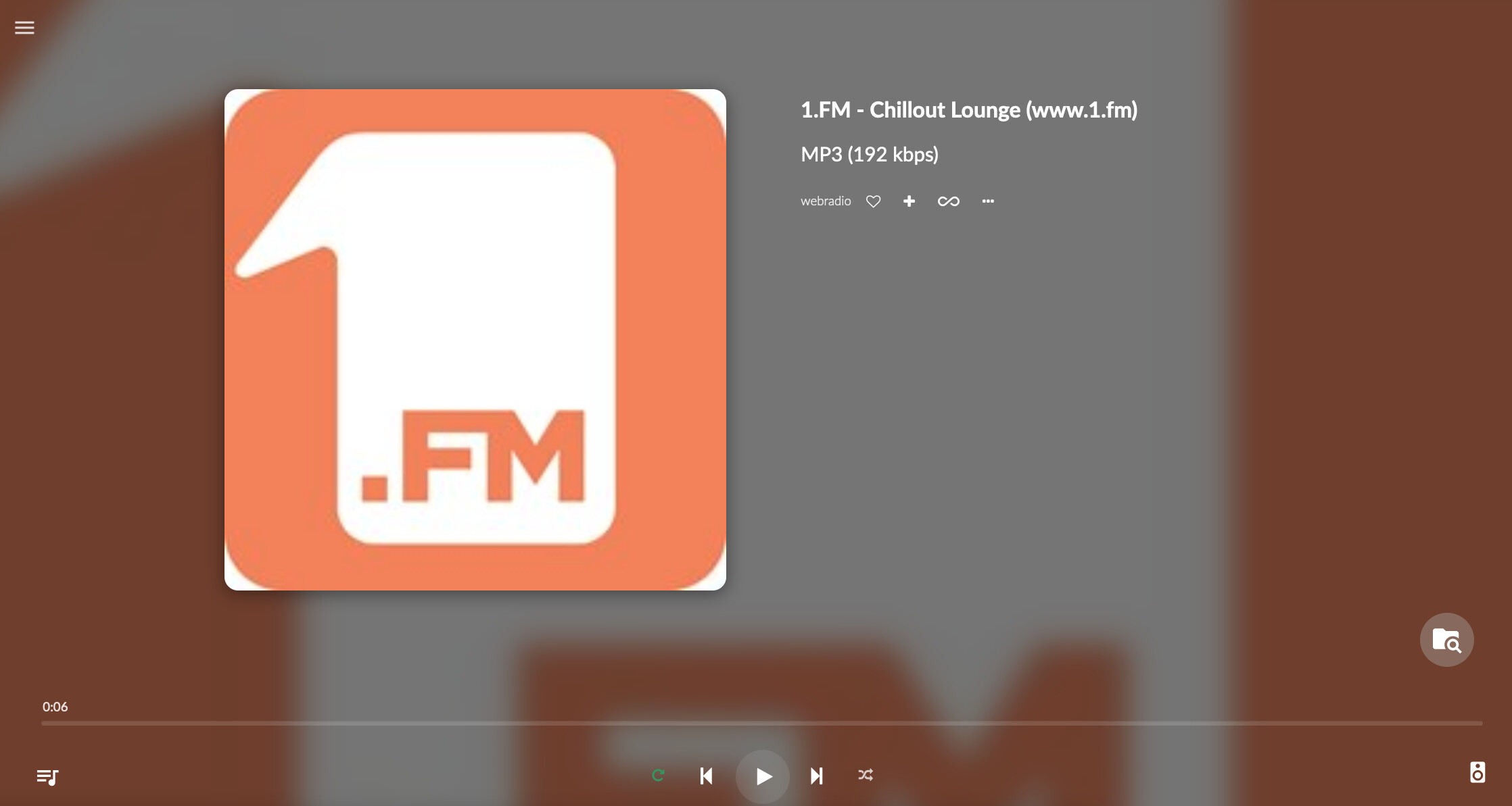

Can you test what happens if you select the “Hifiberry DAC”
Then reboot and test.
Made the change … see screen shot. No sound, notice the song shows .06 sec. Wehn selecting the channel - seemed to be slow.
Reboot was done
Update - I have noticed the screen shows the song being played - but no sound. I’m reading up on how the volume gets changed. The powered speakers are connected to the Hifiberry DAC – This same setup does play the Volumio startup sound. -AlsaMixer shows: Card: HDMI — when I change and view again… still shows HDMI

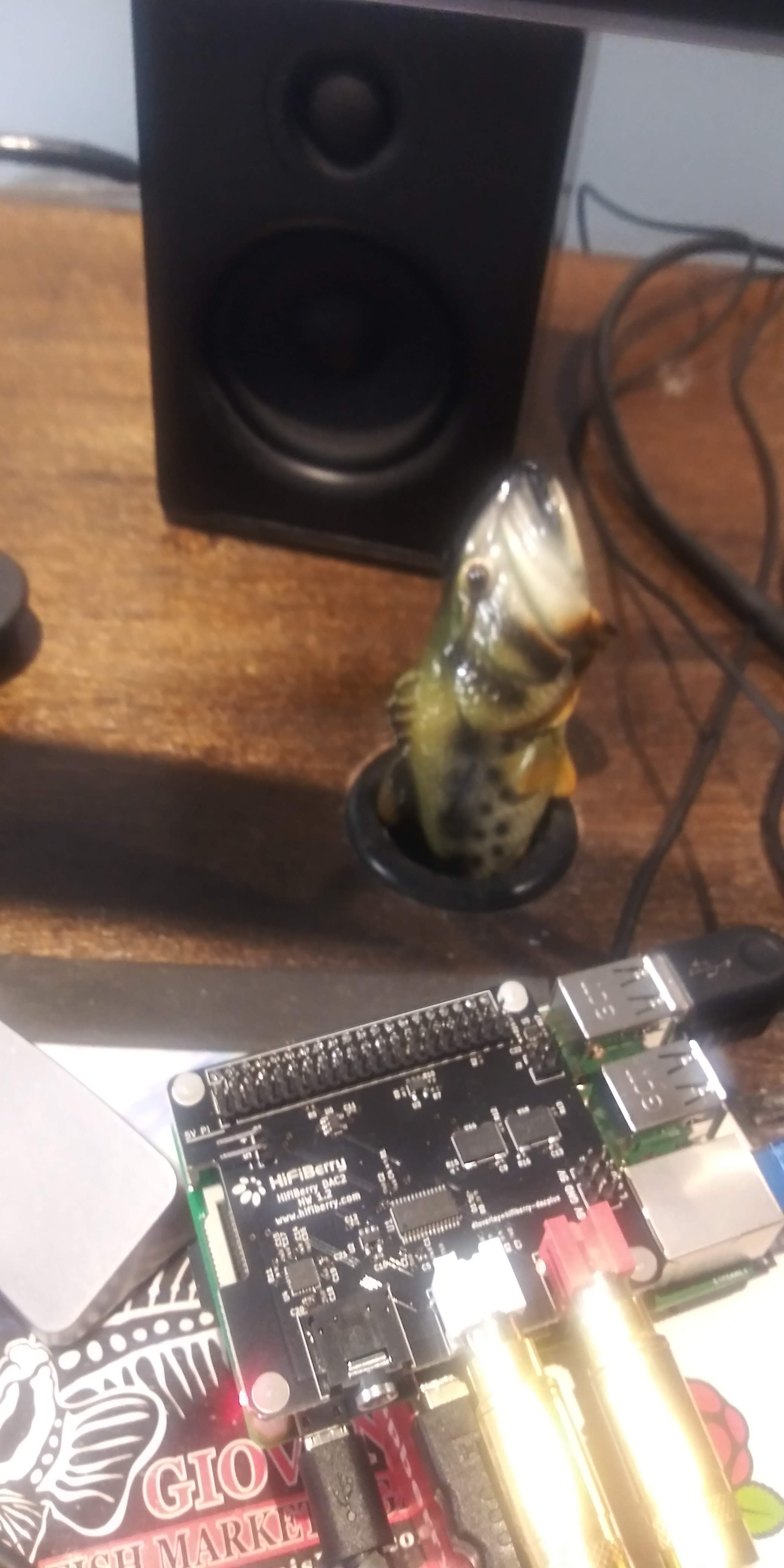

please post a picture of your DAC too

Forgot image of DAC card

your DAC is a HifiBerry DAC2 HD
To have Volumio loading the correct driver, you must select HiFiBerry DAC2 HD, that will load the dt-overlay hifiberry-dacplushd

I had a better look to your picture, sorry I gave you a wrong information yesterday
your PCB is a HifiBerry DAC2 Pro, not a DAC2 HD
Your DAC requires the dt-overlay hifiberry-dacplus to be loaded.
Unfortunately there is no entry for your DAC in the list, but there are other two that will select the required dt-overlay, with slightly different parameters regarding the eeprom name
HiFiBerry DAC Plus
HiFiBerry DAC+ Pro
could you please try with both?
