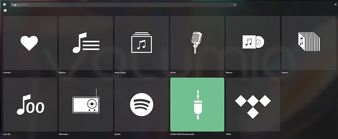

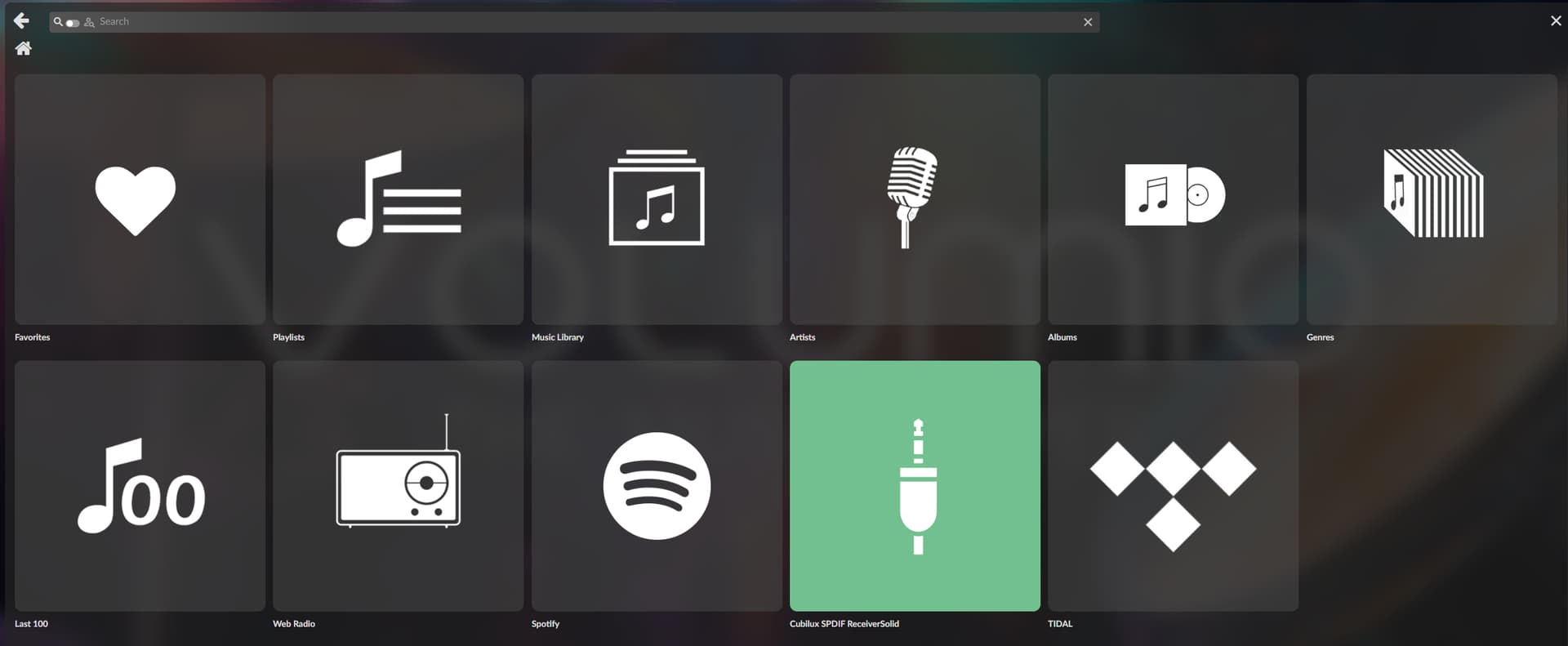

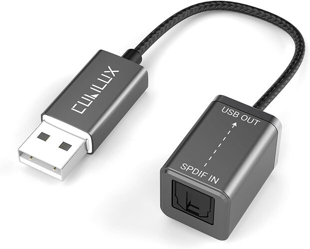

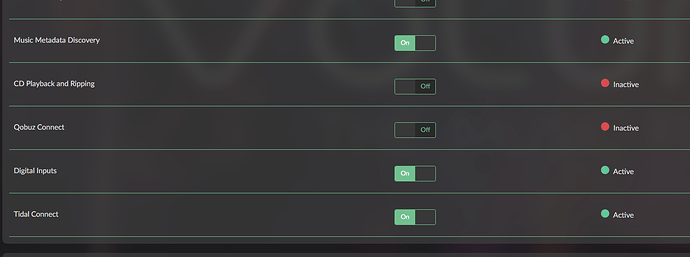

I’ve bought a SPDIF to USB adapter so that I can connect my TV / Chromecast Audio, but i get no sound output. The device IS recognised…but i don’t get any sound out of it when my TV is connected (and optical output is selected). before i go and find another source with optical output and buy some new optical cables, is there anything simple that I’m missing to get this thing to work properly? I am a volumio subscriber and ‘digital inputs’ is enabled.

In my opinion The Cubilux adapter is for recording, not for playing audio through Volumio and Volumio currently does not support SPDIF input > USB input > audio playback through its UI.
I have the same Cubilex device and it works perfectly: am using it NOW to play the sound from TV: TV → spdif → Volumio → Hifiberry DAC2 Pro → tube amplifier
