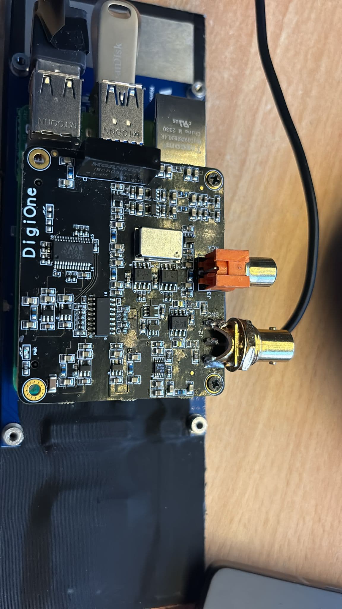

I have a problem that I have been experiencing randomly since I installed an Allo Digione board (two years ago) on Raspberry Pi3b+.
When I switch from one song at a certain resolution to another with higher resolution (e.g., from a 16/44 file to a 24/48 file, or from a flac to a dsd) I don’t hear sound.
I have to either restart the player, or make numerous switches between files until the playback of the file with higher resolution finally emits sound.

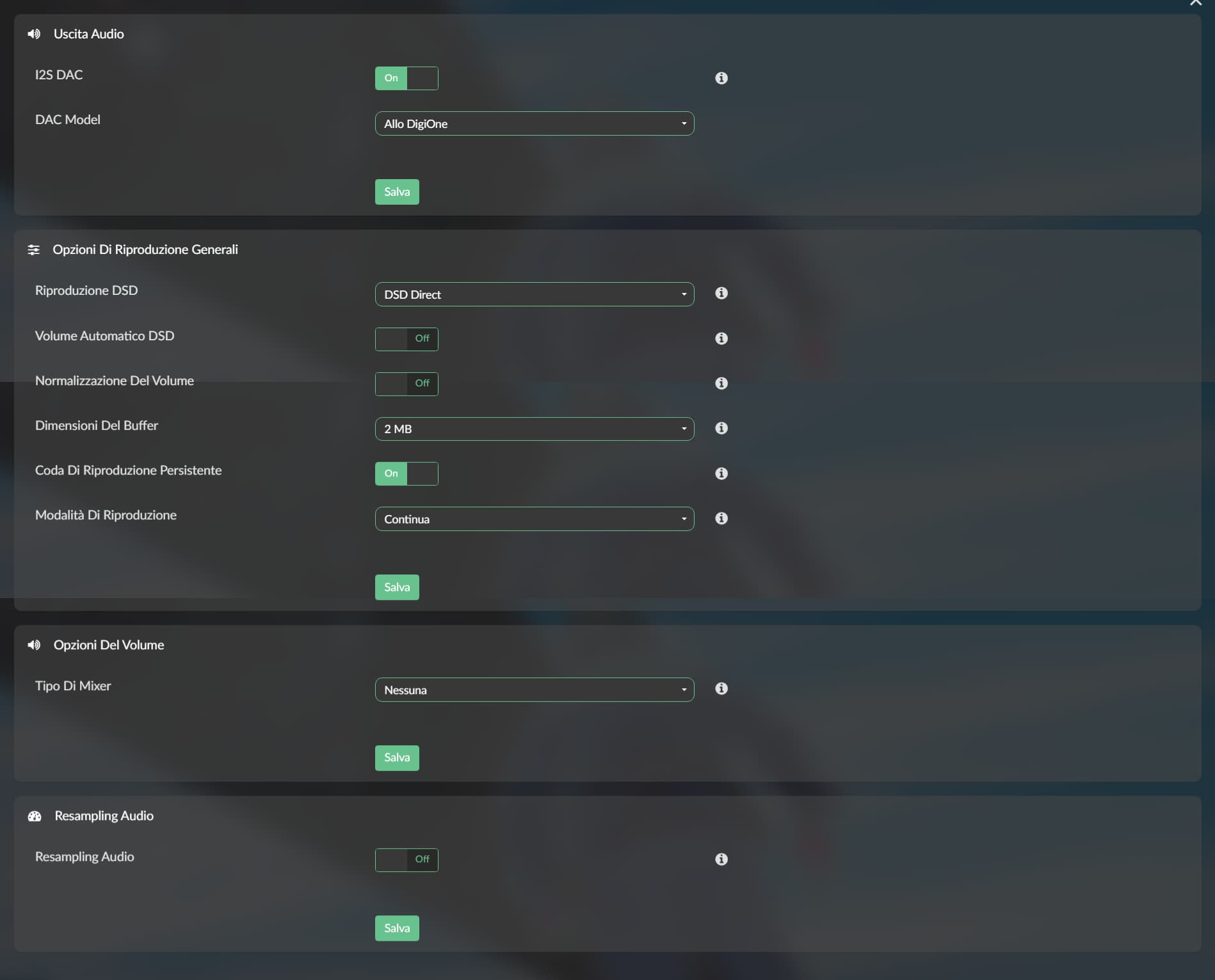

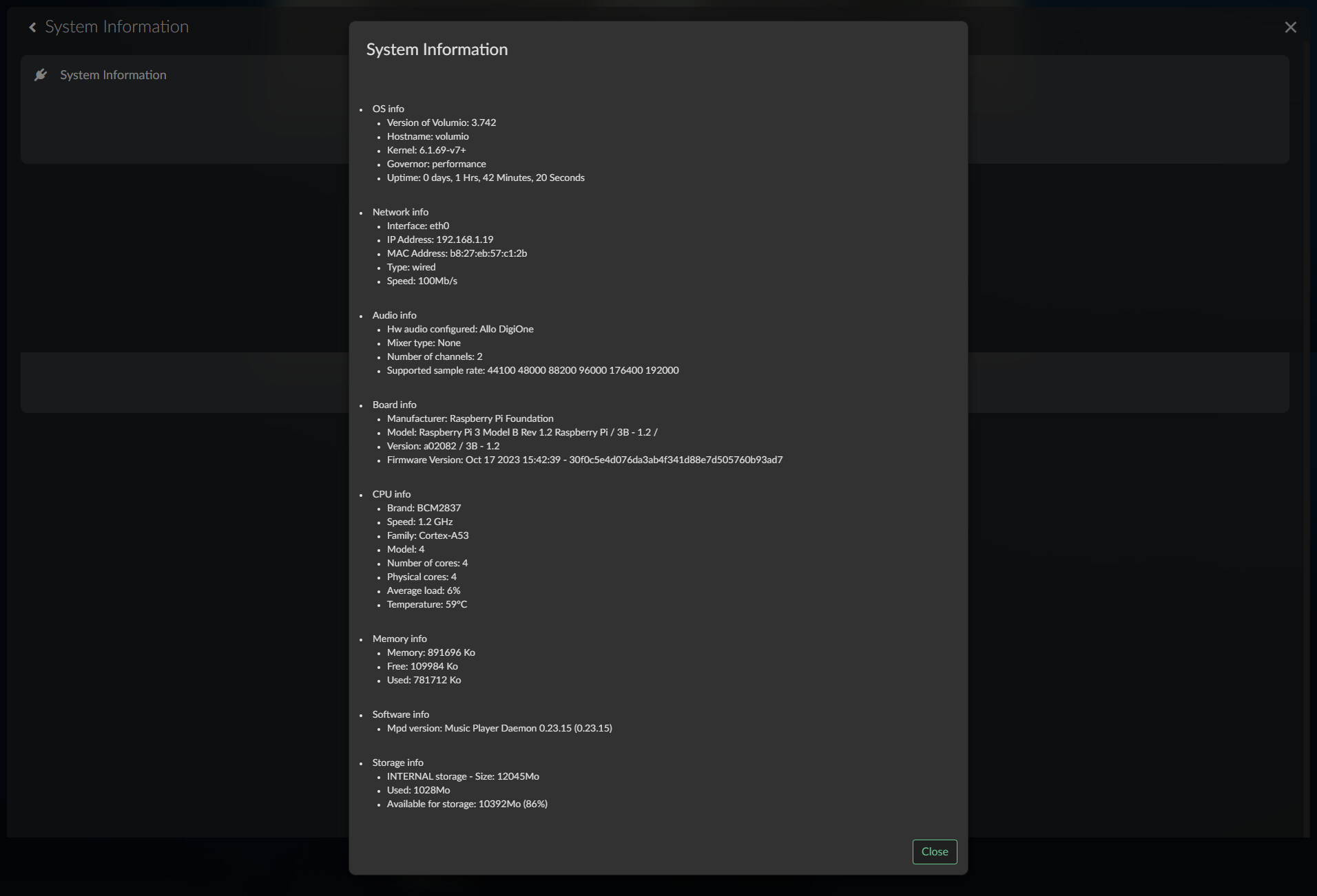

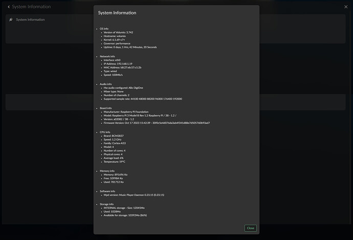

Currently this is my configuration (Volumio 3.703):
and here’s the log: http://logs.volumio.org/volumio/GGZhD5f.html

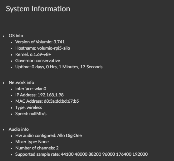

I think it is, running it here on a rPi5.

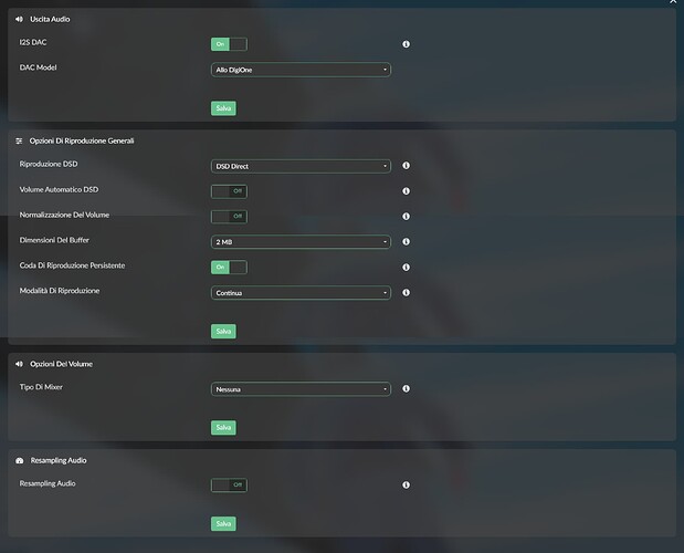

This is my config.
Which version of the Allo DigiOne do you have on your RPi5?
I saw on the Allo website a RPi3 version and a RPi4 version.
I have the RPi3 version, and I doubt it can be mounted on an RPi4 or RPi5 :confused:
I don’t know, I guess it’s for the 4. But since the GPIO pinout for rPi3 and rPi4 are identical, I don’t see much issues.
