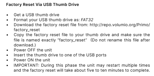

It sounds like your Rivo+ encountered a critical error while booting.
This usually means:
- Power check: Use the original power adapter and cable.
- Corrupted image: you can restore this using a USB thumb as described in the manual.
I will try that. Thank you.
I tried these steps and it did not work. Thank you.
