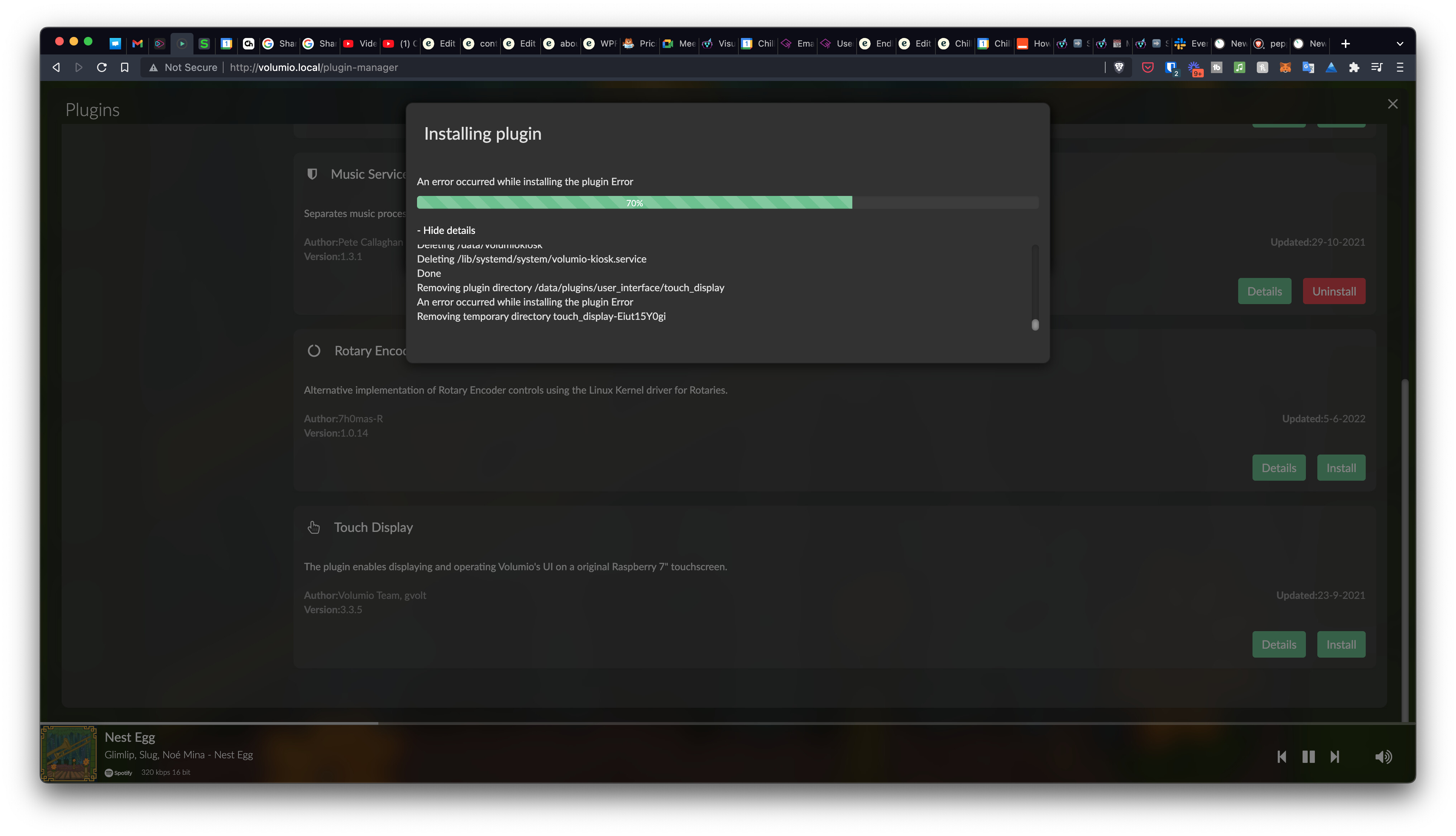

Will this work on a raspberry Pi 400? Plugin fails to install
Did you see an error message during installation? If so, what?
If I had to guess, I would assume that during the plugin installation the download of a software package failed. This causes the plugin installation to abort. If this assumption is true, I recommend to try the installation again.
Downloading plugin at https://plugins.volumio.workers.dev/pluginsv2/downloadLatestStable/touch_display/volumio/buster/armhf
END DOWNLOAD: https://plugins.volumio.workers.dev/pluginsv2/downloadLatestStable/touch_display/volumio/buster/armhf
Creating install location
Unpacking plugin
Checking for duplicate plugin
Copying plugin to location
Completing "UIConfig.json"
Installing fake packages for kernel, bootloader and pi lib
Selecting previously unselected package libraspberrypi0.
(Reading database ... 35306 files and directories currently installed.)
Preparing to unpack .../libraspberrypi0_0.0.1_all.deb ...
Unpacking libraspberrypi0 (0.0.1) ...
Setting up libraspberrypi0 (0.0.1) ...
Selecting previously unselected package raspberrypi-bootloader.

Err:2 http://mirror.liquidtelecom.com/raspbian/raspbian buster/main armhf keyboard-configuration all 1.193~deb10u1
Could not connect to mirror.liquidtelecom.com:80 (41.84.153.33), connection timed out
Err:6 http://mirror.liquidtelecom.com/raspbian/raspbian buster/main armhf libxxf86dga1 armhf 2:1.1.4-1
Unable to connect to mirror.liquidtelecom.com:http:
Err:13 http://mirror.liquidtelecom.com/raspbian/raspbian buster/main armhf libwayland-server0 armhf 1.16.0-1
Err:14 http://mirror.liquidtelecom.com/raspbian/raspbian buster/main armhf libxcb-dri2-0 armhf 1.13.1-2
Err:15 http://mirror.liquidtelecom.com/raspbian/raspbian buster/main armhf libxcb-dri3-0 armhf 1.13.1-2
Err:17 http://mirror.liquidtelecom.com/raspbian/raspbian buster/main armhf libxcb-present0 armhf 1.13.1-2
Err:24 http://mirror.liquidtelecom.com/raspbian/raspbian buster/main armhf libxcb-sync1 armhf 1.13.1-2
Err:25 http://mirror.liquidtelecom.com/raspbian/raspbian buster/main armhf libxcb-xfixes0 armhf 1.13.1-2
Err:26 http://mirror.liquidtelecom.com/raspbian/raspbian buster/main armhf libxshmfence1 armhf 1.3-1
Err:27 http://mirror.liquidtelecom.com/raspbian/raspbian buster/main armhf libepoxy0 armhf 1.5.3-0.1
Err:28 http://mirror.liquidtelecom.com/raspbian/raspbian buster/main armhf libevdev2 armhf 1.6.0+dfsg-1
Err:29 http://mirror.liquidtelecom.com/raspbian/raspbian buster/main armhf libfontenc1 armhf 1:1.1.3-1
Err:30 http://mirror.liquidtelecom.com/raspbian/raspbian buster/main armhf libxcb-glx0 armhf 1.13.1-2
Err:31 http://mirror.liquidtelecom.com/raspbian/raspbian buster/main armhf libxdamage1 armhf 1:1.1.4-3+b3
Err:32 http://mirror.liquidtelecom.com/raspbian/raspbian buster/main armhf libsensors-config all 1:3.5.0-3
Err:33 http://mirror.liquidtelecom.com/raspbian/raspbian buster/main armhf libsensors5 armhf 1:3.5.0-3
Err:34 http://mirror.liquidtelecom.com/raspbian/raspbian buster/main armhf libgudev-1.0-0 armhf 232-2+rpi1
Err:35 http://mirror.liquidtelecom.com/raspbian/raspbian buster/main armhf libwacom-common all 0.32-1
Err:36 http://mirror.liquidtelecom.com/raspbian/raspbian buster/main armhf libwacom2 armhf 0.32-1

Fetched 27.2 MB in 31s (885 kB/s)
Installation of xinit failed
Plugin failed to install!

Deleting /opt/volumiokiosk.sh
Deleting /data/volumiokiosk
Done
Removing temporary directory touch_display-Eiut15Y0gi
Just hangs at this point
Reason for the failing plugin installation is obviously that this mirror server canât be reached.
You might try again later to install the plugin, hoping the mirror will be reachable then. If that does not work out you may change the repository mirror as described here. I have never tried that myself, so I donât know if that helps.
thanks gvolt. after 5 tries it installed.
