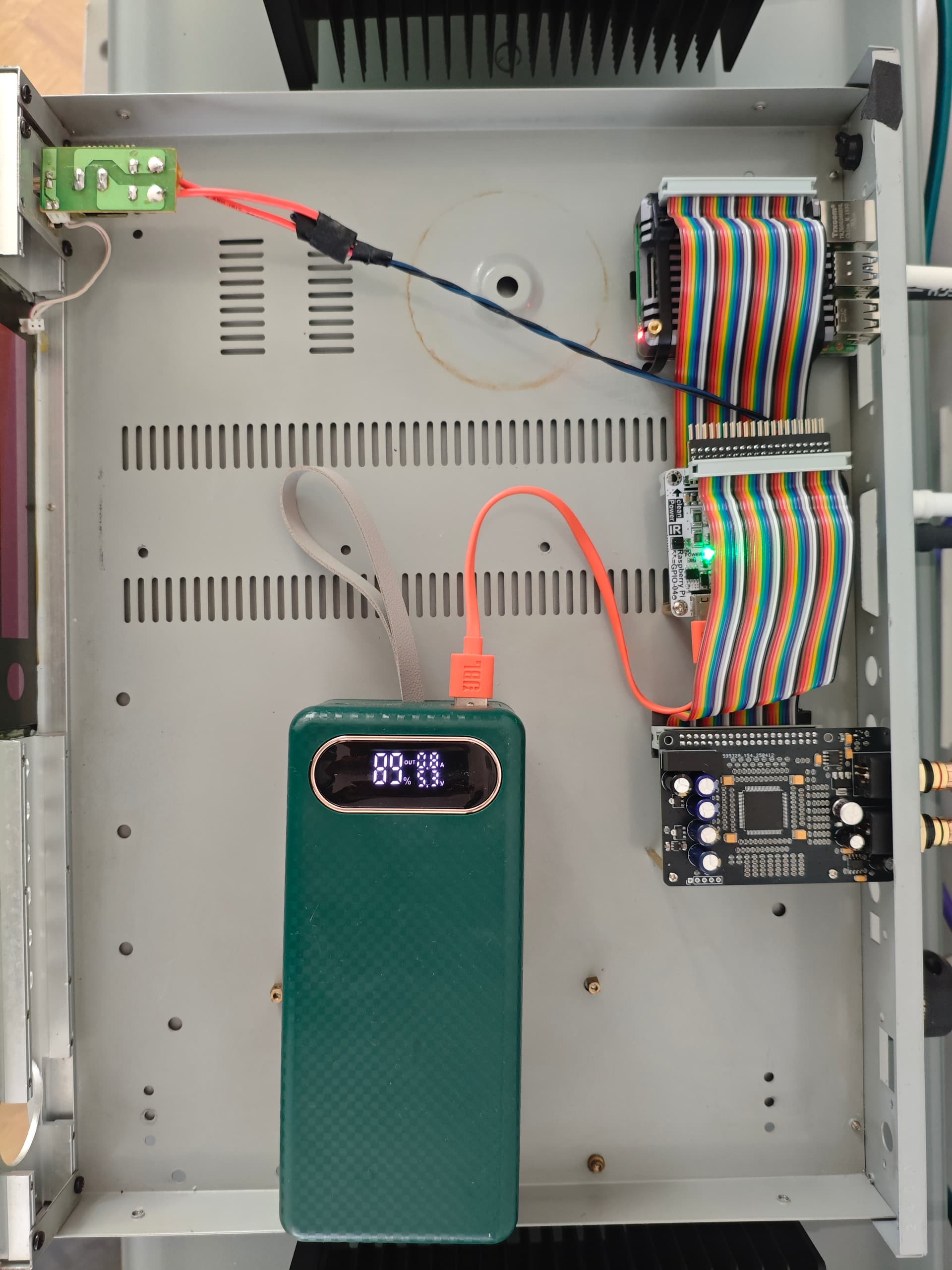

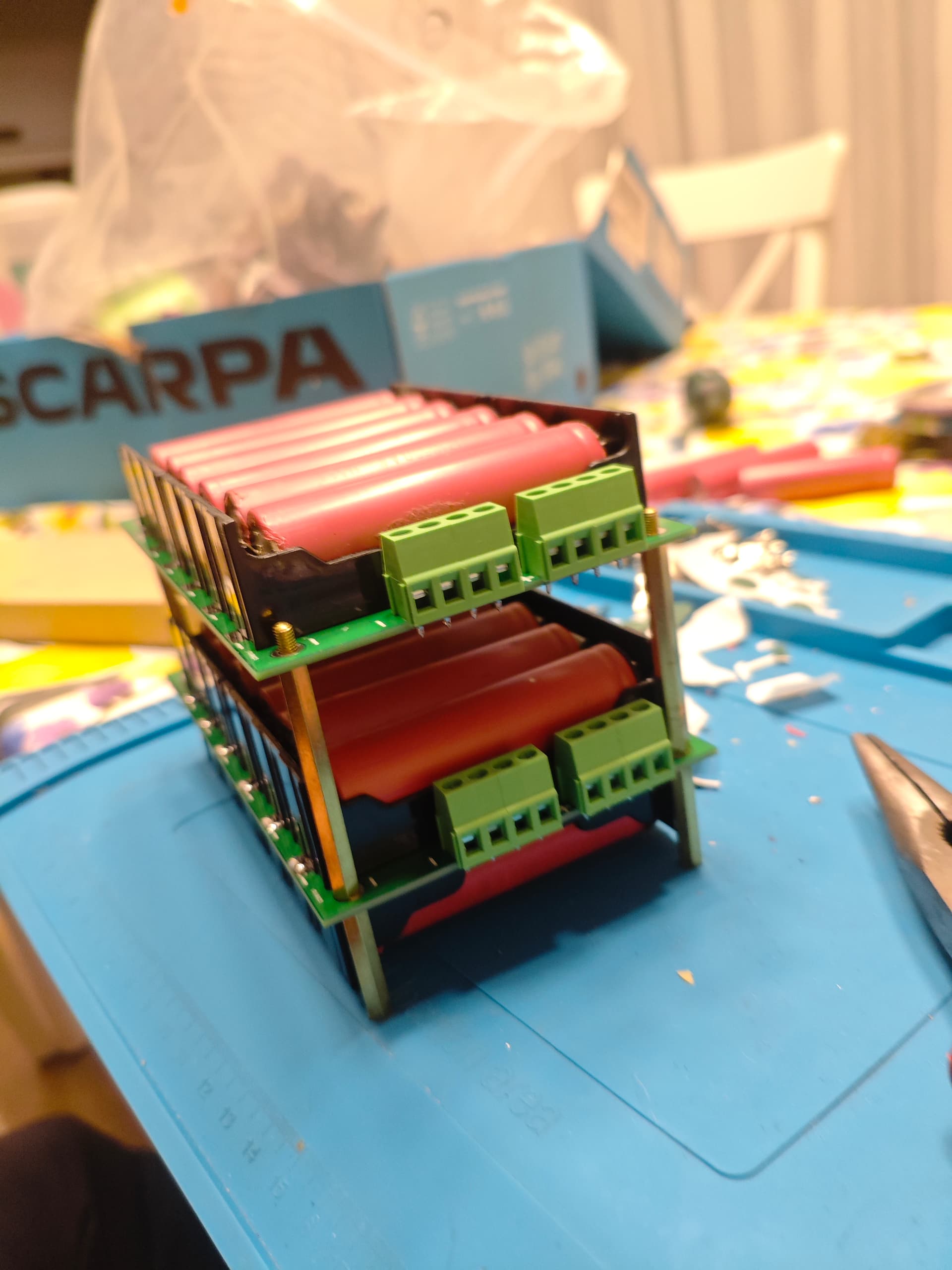

Guys, but why spending lots of money on linear power supply, when you can power on a raspberry with volumio with just a good power bank. In this way you will have the purest dc voltage.
I have a 21 pcs 2000 Ah 18650 used battery power bank with the case ordered from Ali and it lasts more than 9 hours.
More than this my future pream build pass Korg nuTube will be also powered by a power bank for 24V
