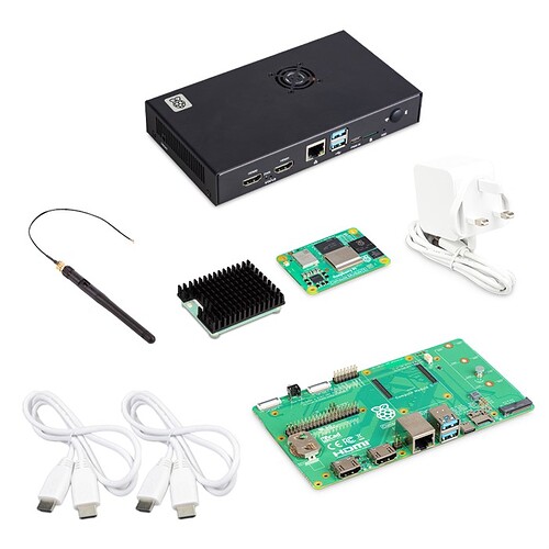

New install on RPi5 Compute Module Development Kit
Got a brand new Raspberry Pi 5 Compute Module Development Kit
Flashed the latest Volumio from here today, on a USB drive
When I try to boot the RPi it’s stuck on this
“Waiting for usb devices this should not take too long”
Wondering this board is compatible. There are only 2 USB 3.0 ports and 1 USB-C for power.
