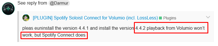

See reply from @Darmur

Spotify still isn’t working for me. I uninstalled the plugin, then restarted Volumio. Then I installed and authorized plugin version 4.4.2. Spotify still won’t play any music.
Please read the topic, prior posting.
Thank you for this new version 4.4.2. I wasn’t familiar with the Spotify Connect mechanism. But everything works perfect. I can use the familiar interface of Spotify and enjoy Volumio at the same time!

the playback does not start on the web UI
Bit rate is set to 160
Only if i start the playback on my Mobil device music plays on my Raspberry5.

I’m not using Spotify Connect, i’m talking about a not working Plugin,
And where is the feature in Volumio to use Spotify Connect

In one thing we both are of the same opinion, that is, the „connect only“ feature and how to use it - could be announced more prominent @volumio to avoid this kind of confusion for all users - many would be happy to get the „all done with Volumio“ option aside, instead of having to control the spotify part from phone only - what - on the other side - does have it‘s advantages too.
It’s not only in Volumio’s hand to have it back - mainly Spotify itself is defining what can be done at the endpoints- and what not.
Also have a look on when the upcoming Spotify Soloist Plugin will be marked as stable - currently in beta phase but already very surprising. It‘s also „connect only“ because of the same restrictions from Spotify - but is able to play lossless !
