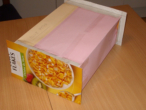

BLUE PETER STYLE MODEL

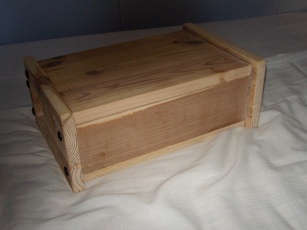

THE BARE WOOD BOX

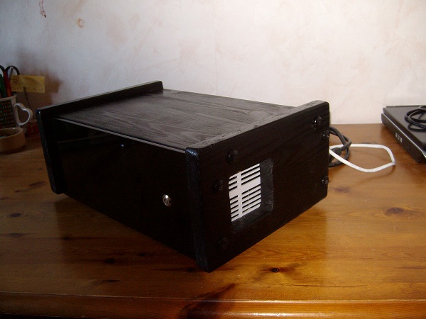

THE BOX BLACK LAQUERED

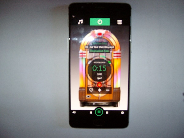

I have managed to take a Oneplus A3003 phone out of service and it has now got no sim card in it. I removed as many other apps as possible and shut down most other installed services. As a result the phone is now just a remote access to my player.
VOLUMIO APP. ON THE ANDROID PHONE

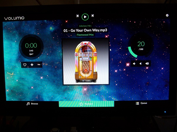

VOLUMIO ON MY PC
