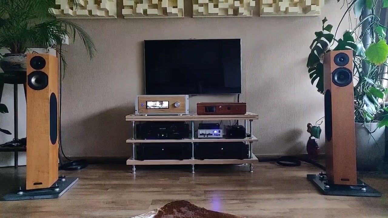

I’ve seen such top plates passing by here before, and I thought I’d start scroll sawing myself.
Fortunately, I paid close attention to manual labor in primary school.
You just shouldn’t look at it for too long otherwise it will make you dizzy😵‍💫
That looks fantastic. You obviously paid more attention in woodworking class than most.
Was thinking the same.
Me replacing a lightbulb:
side covers now ready.
Now finish everything nicely with an aluminum strip so that it fits with the rest.
copper shielding for the transformers, back of the touchscreen, raspberry pi and clocks.
In retrospect I should have taken Mu-metal instead.
grounding has already been done, it is not shown in the photo.
the corners still need to be soldered.
Did you know that copper shielding for the transformers is not a good choice? The electromagnetic field is not attenuated by copper. Use sheet steel unless it is for decorative purposes.
I am aware of it, I also mentioned that in retrospect I should have chosen better Mu-metal.
In any case, I will provide these copper plates with nickel myself, that way it will work somewhat.
