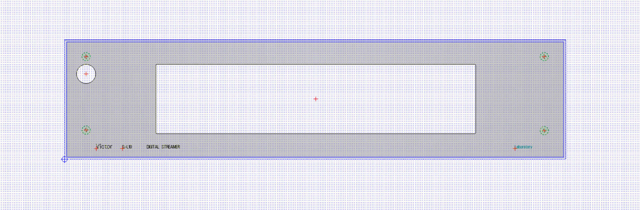

- DIY Frontplate (https://www.schaeffer-ag.de/en/)

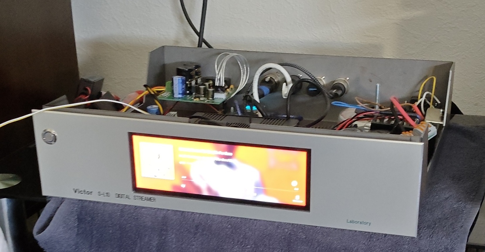

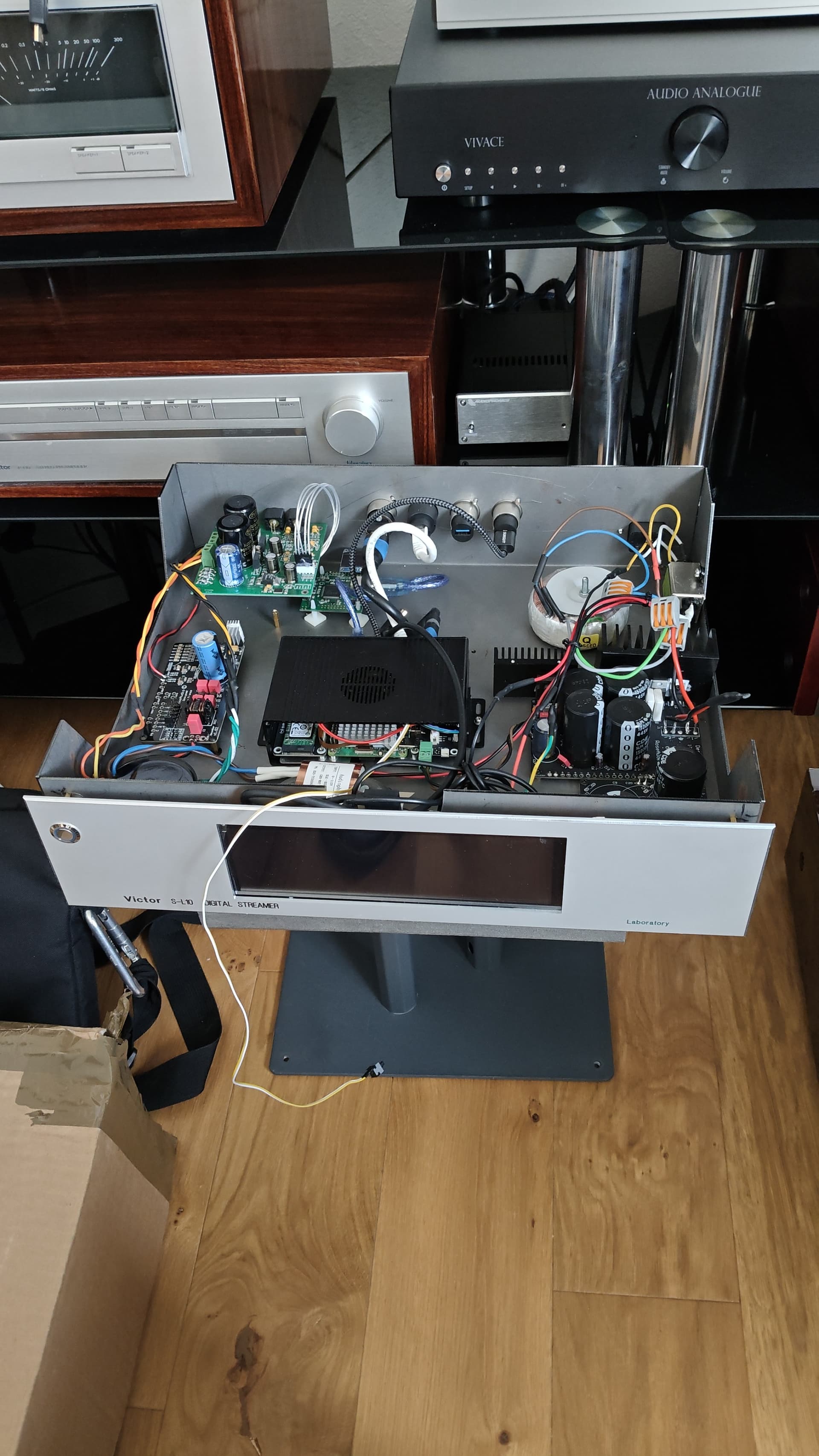

a view of the naked chassis…

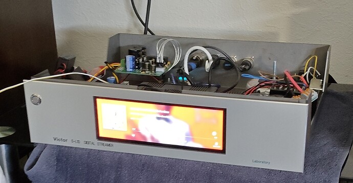

But what does it look like in the end ???
well I wanted to keep the look and feel of the original serie. So I tried to stay as closed as possible to the original design…
The front plate for instance…

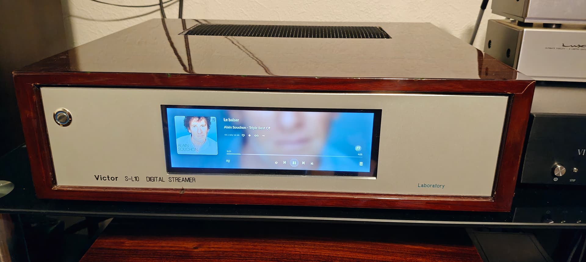

and the final result :

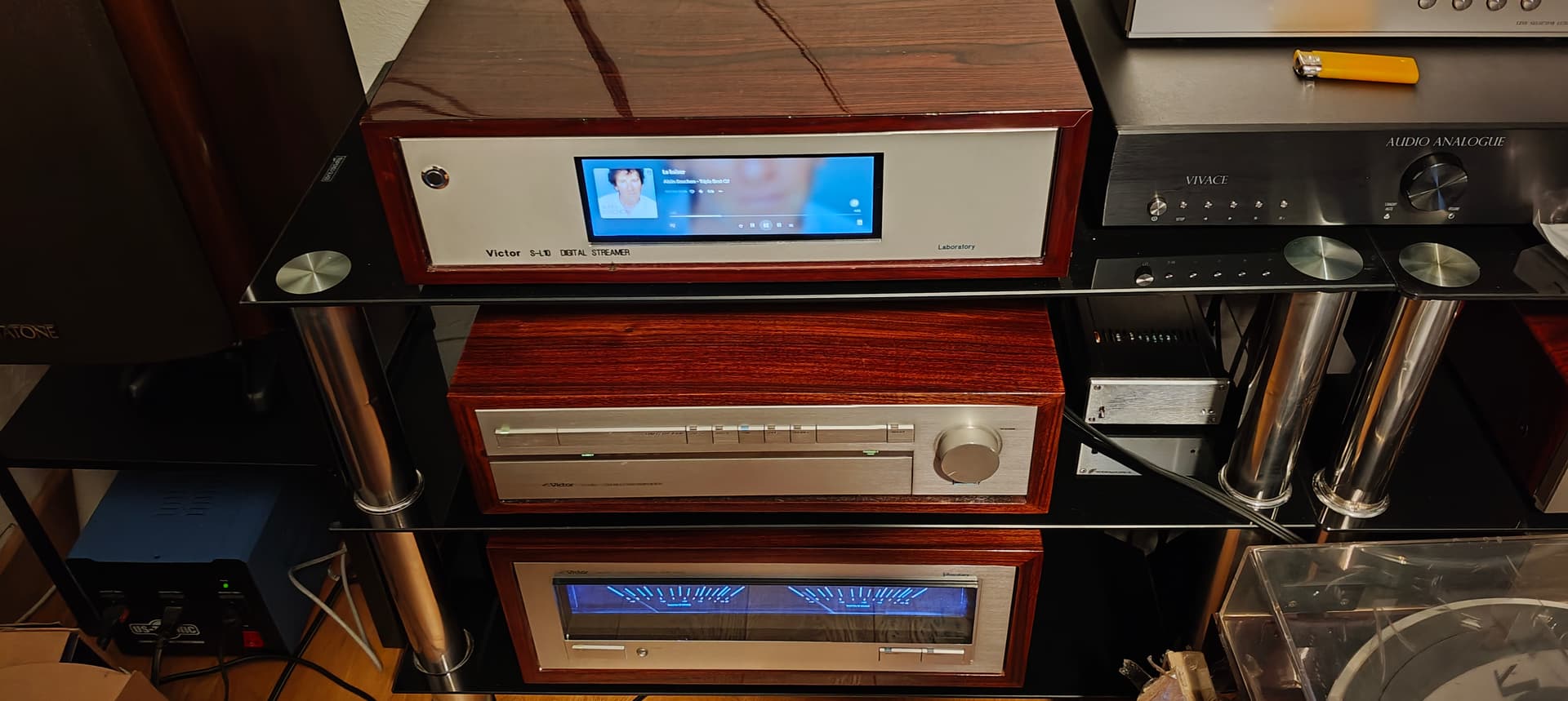

altogether :

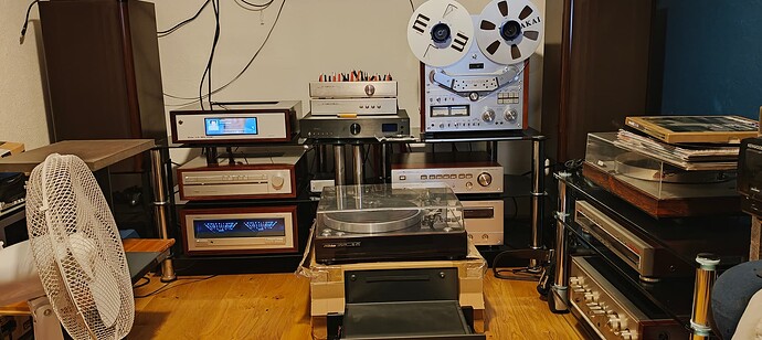

I now need to tidy up the room itself
build up or find a nice rack to host all my vintage gear…
I tend to stack too many systems…
