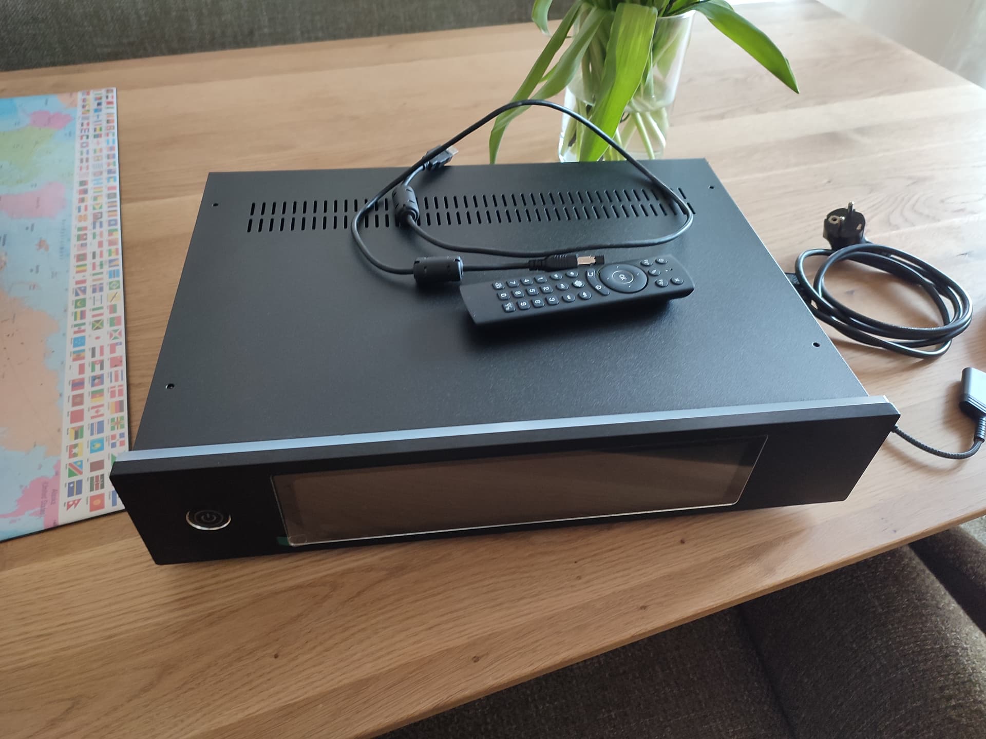

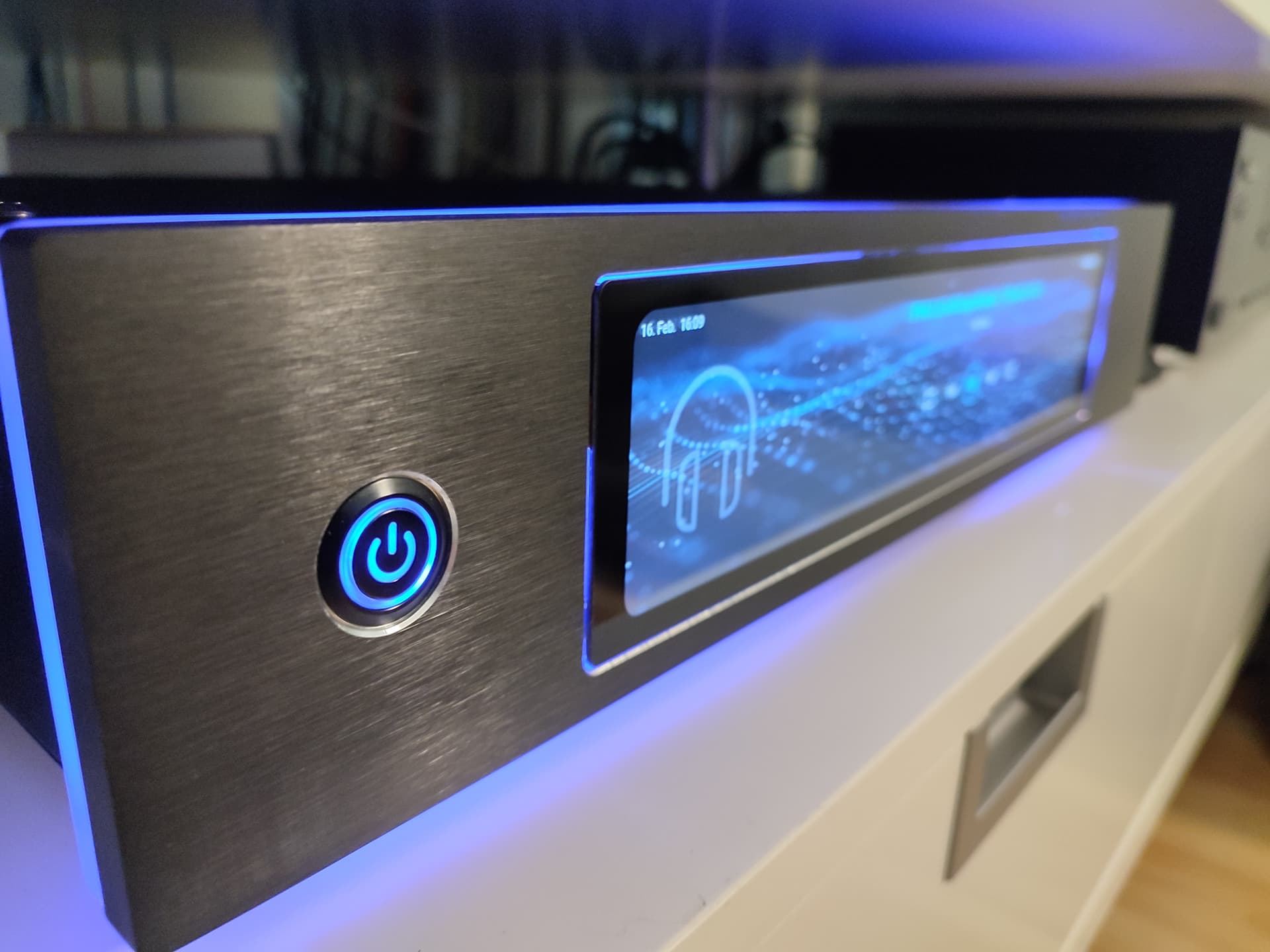

My final Streamer in a great case
I want to share a view pictures of my final Streamer. I’m playing around with Volumio sice - i think - 4 years. So it was now time to built my final version for the living room.
Thanks to Volumio und the community for this lovely peace of audio-gear!

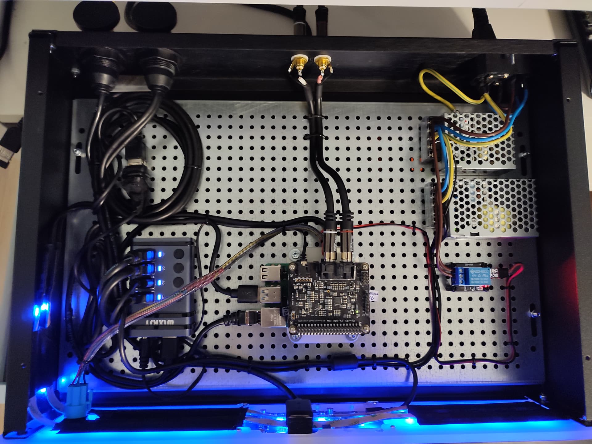

components:
Volumio 3.6
Now-Playing plug-in
RPi 4
Waveshare 11,9" HDMI LCD touch display
IQ Audio DAC pro HAT
RPi-Power filter HAT (China-thingy)
Witty Pi 3 Mini for shut-down/powering

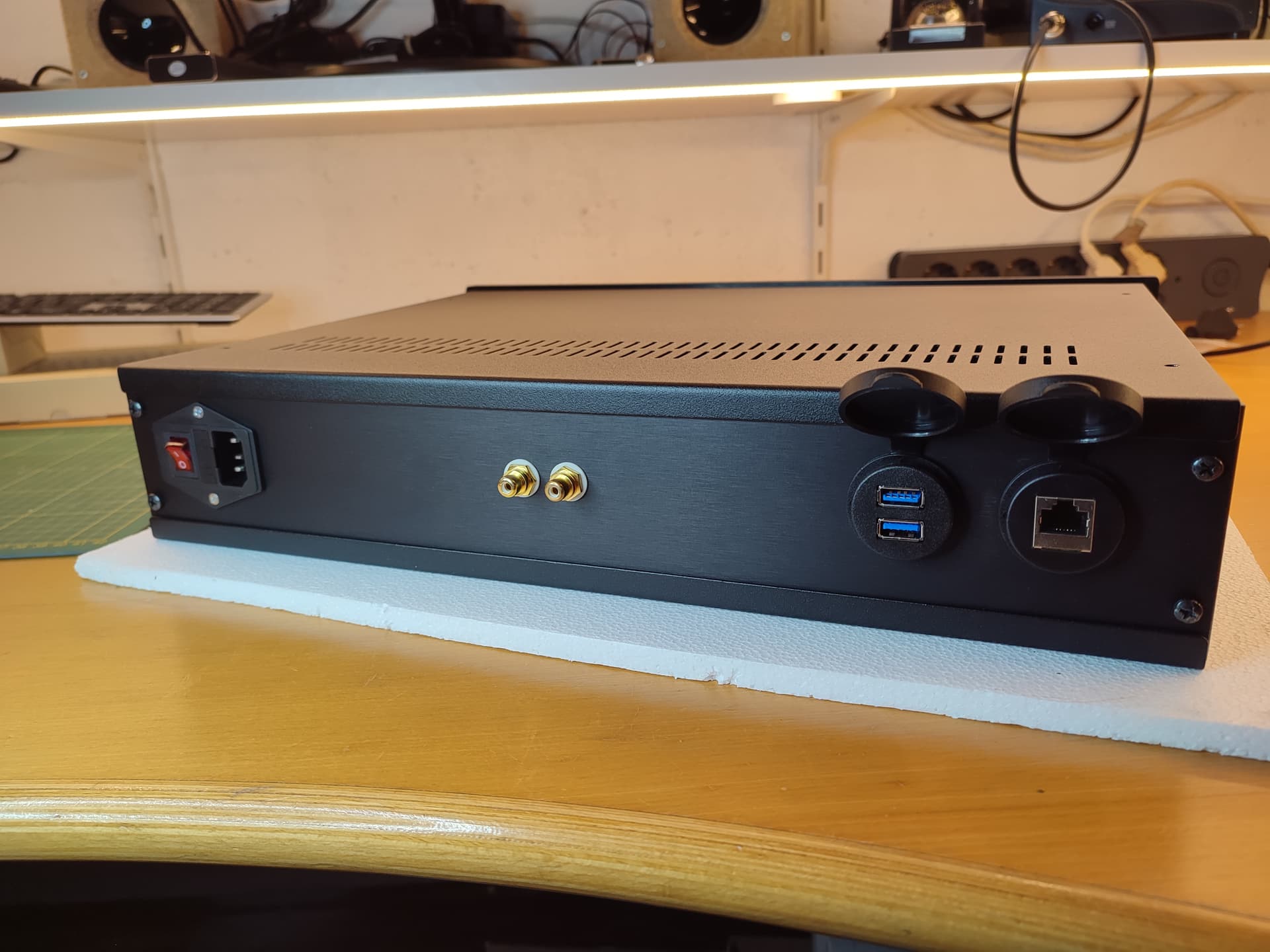

Modushop case Pesante 2U, 10mm black anodized aluminum Front
active USB-Hub
12V and 5V Meanwell switching power supply
RF-Remote with triggerhappy
Happy listening!

That looks absolutely fantastic, Markus.

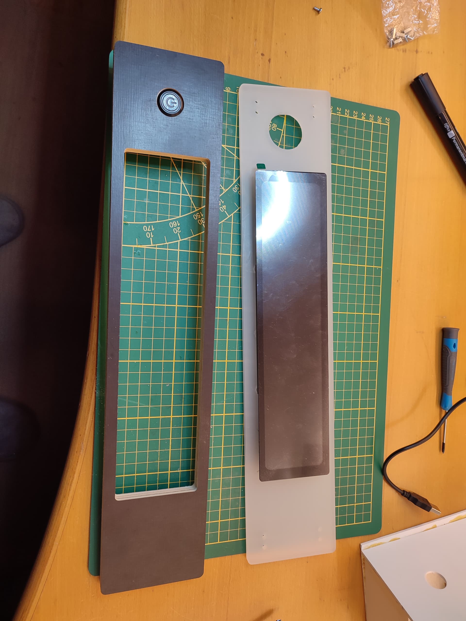

How did you mount the screen? I think that’s my biggest concern about trying something like this :thinking:
Thank you guys!

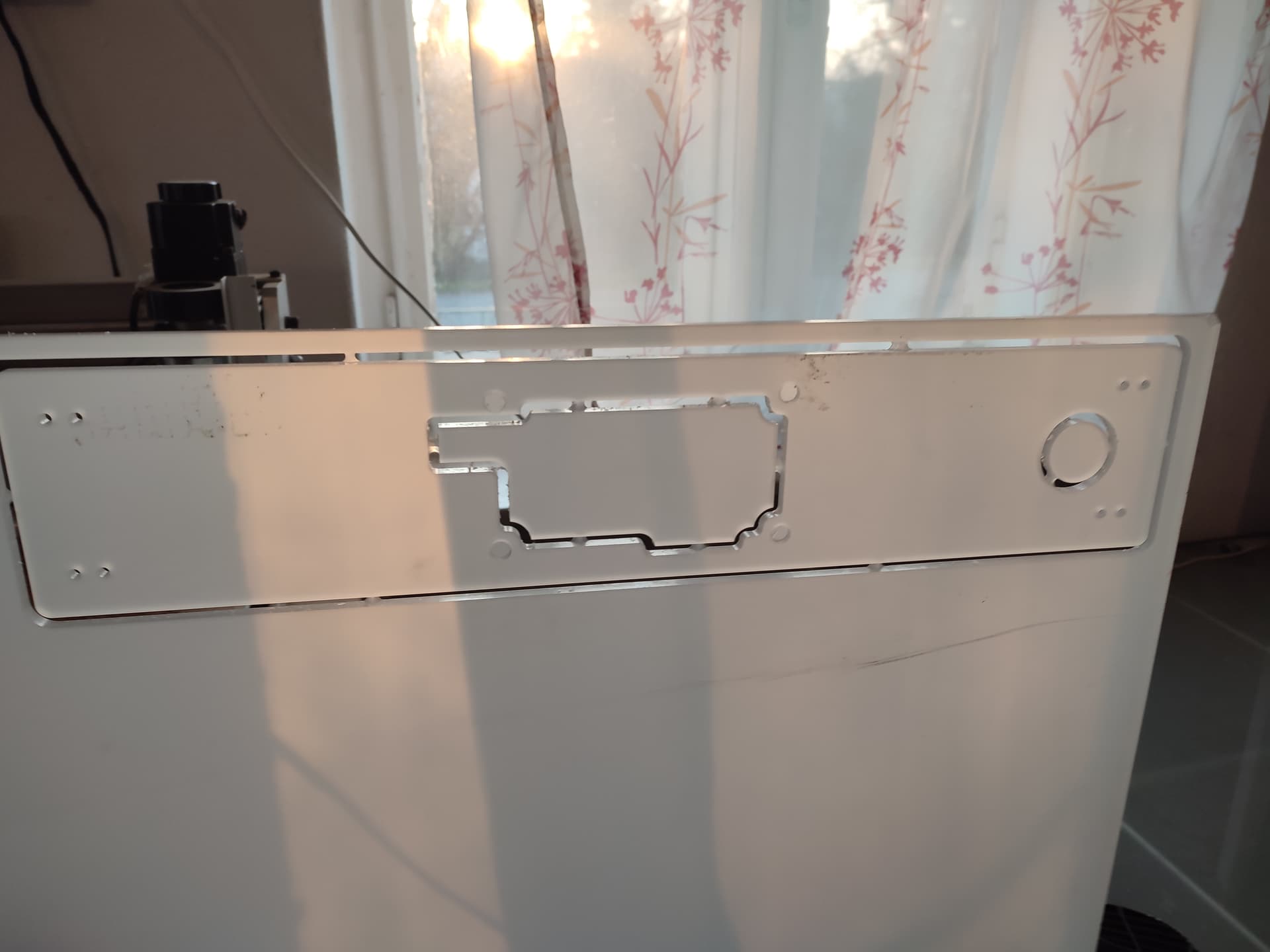

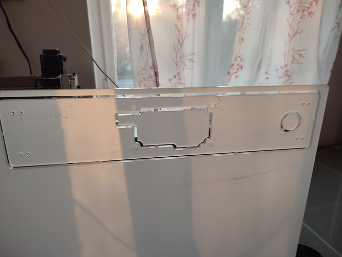

To mount the display is not that easy. The front of the case is 10mm thick, but the display is 13mm deep. So I planned an additional sheet of acrylic behinde the aluminum front to hold the display and then the acrylic sheet is mountet in between the case and the aluminum front.
For sure noboddy wants to do this by hand. luckily I hav got a DIY CNC-mill. By the way, the case manufacturer provides CAD-files from the case.
here are pics of the setup:
the back of the case can be ordered as an upgrade in 2mm aluminum too, so it is easyer to cut it too (standard is a steel-back)

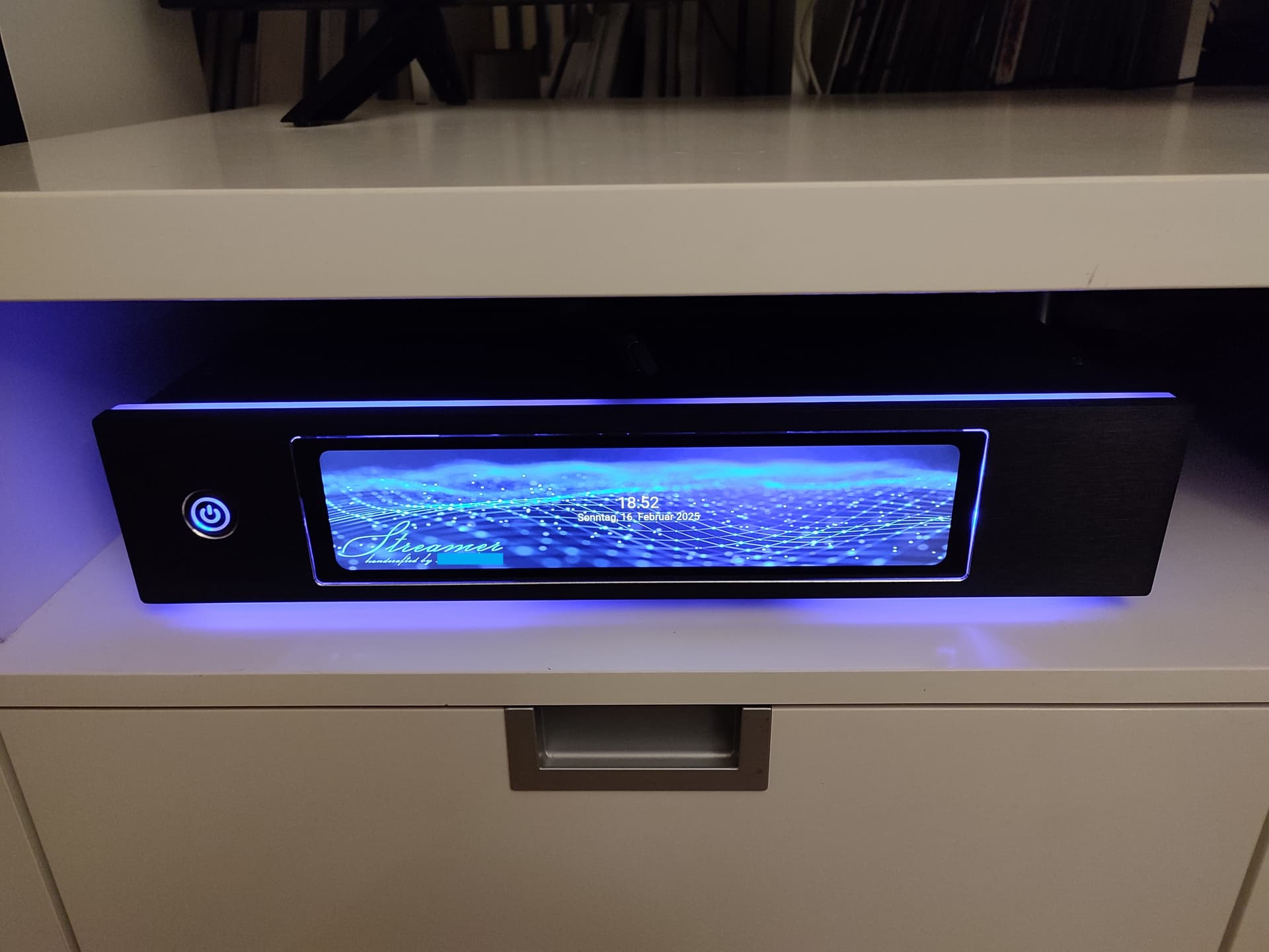

I’m really happy with the look of the final streamer. In addition I have put some LED-strips behind the acrylic.
