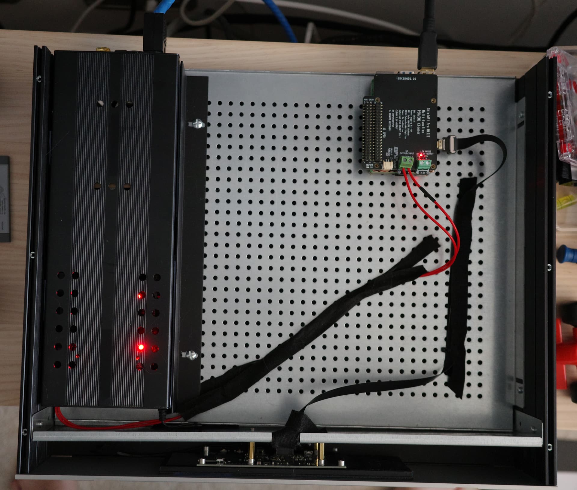

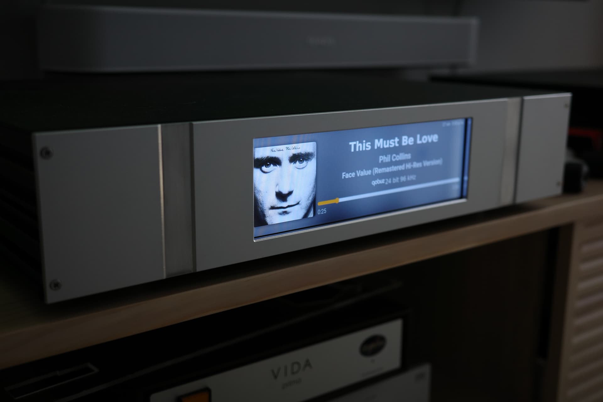

I’m excited to share my new DIY streamer transport with you all.
It’s based on:

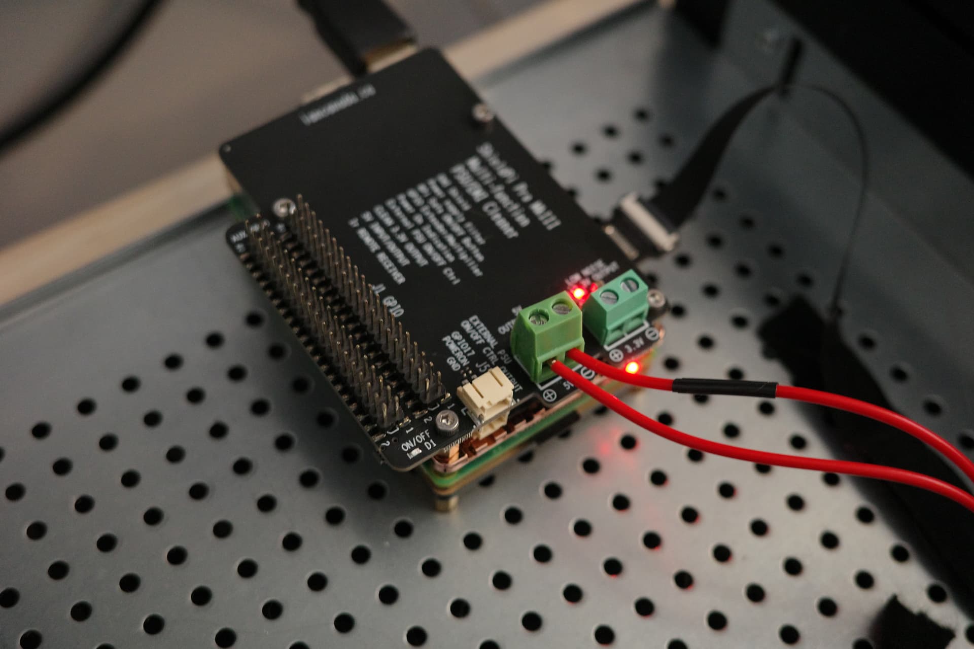

  • Allo Shanti Linear Power Supply, rewired with Neotech Multi-Strand UP-OCC PTFE wiring
  • Waveshare Raspberry Pi 7.9inch LCD HDMI Display 400×1280
  • IanCanada ShieldPro MKIII – simply amazing
  • Raspberry Pi 4 Model B
  • Powered by the one and only Volumio OS
Honestly, I’m truly impressed by its performance—it outperforms streamer transports that cost over $3,000.
The setup is connected via Neotech USB 1020 to my Luxman DA-250 DAC.
It’s been a 7-month journey filled with challenges and improvements, but it was absolutely worth it. The design focus has been on simplicity and on minimizing noise and EMI/RFI as much as possible.
Here you can see some pictures. Hope you like it!
Thanks and long live Volumio!

Some quick questions:
  1. Is the USB audio feed coming off one of the RasbPi USB ports?
  2. The HDMI to the screen - is it a micro-HDMI at both ends?
  3. How are you powering the unit on and off?
  4. How stable is the screen interface? I am running an older RasbPi with the original Pi Foundation screen that often loses connection to the screen and requires rebooting.
  5. Is Volumio installed/booting from a micro SD card?
Thanks!
Hi!
Yes, from the top USB 2.0 (better than USB 3.0 IMHO)
micro-HDMI to the Pi and HDMI to the scree (with the Waveshare U-adapter).
  1. How are you powering the unit on and off?
I use software on-off and the Allo Shanti’s power button to cut the current. The IanCanada has a power control via GPIO but I’m not using it for now.
  1. How stable is the screen interface? I am running an older RasbPi with the original Pi Foundation screen that often loses connection to the screen and requires rebooting.
Not an issue in almost 2 months. I’ve installed Now Playing and Touch Screen plugins.
  1. Is Volumio installed/booting from a micro SD card?
Yes, with no issue at all.
Thanks!

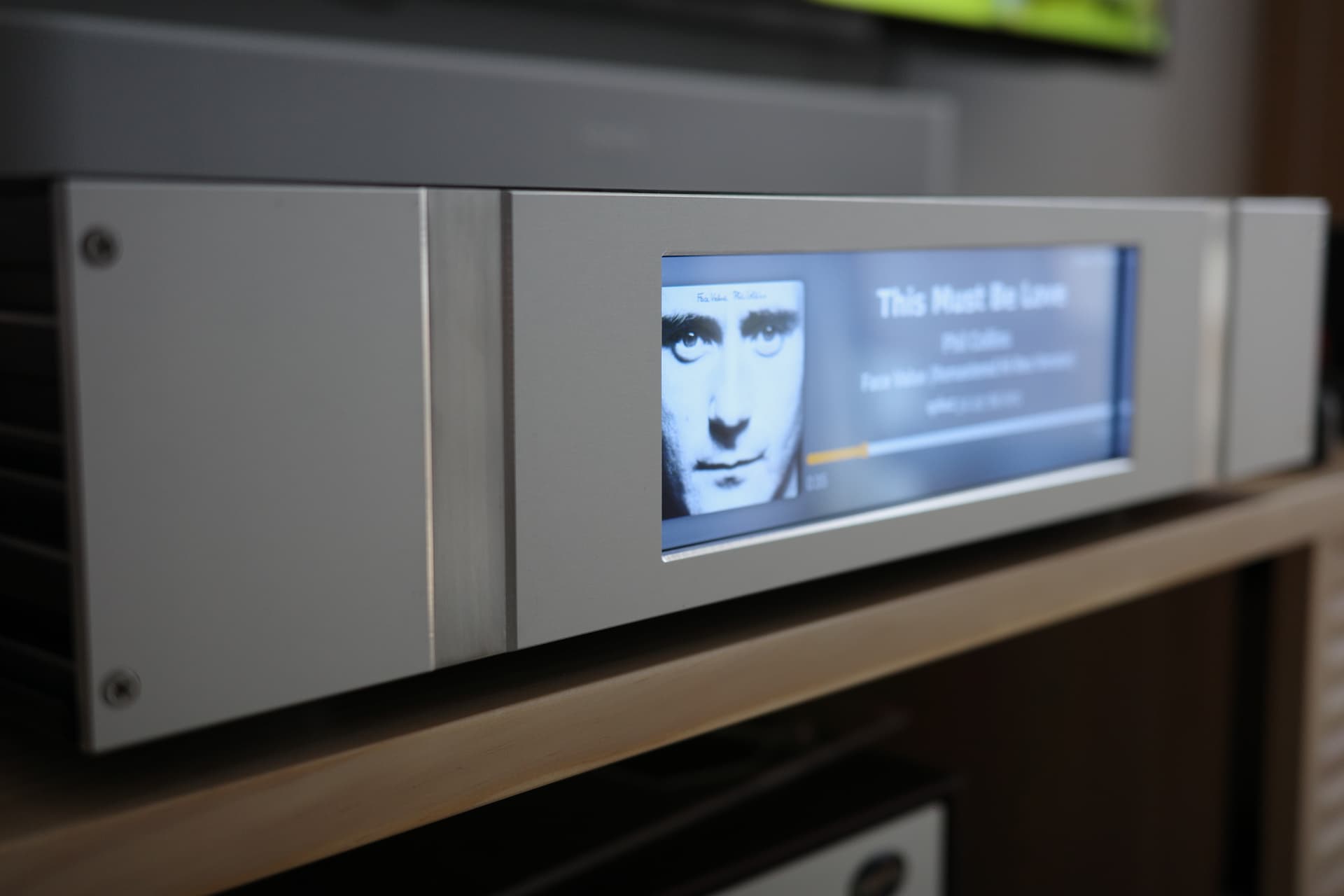

Looks very nice.
Where did you get the case?

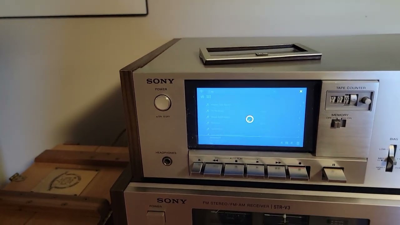

Here is my fun entry into this world with:
HI!
It’s a Hifi2000 case with their 4mm aluminium top +.custom front panel made by schaeffer-ag.
Many thanks!
Your stream is very elegant, what chassis did you use & was the cutout for the screen already there, if not, how did you get the front of the chassis cut with such neat edges?
HI!
