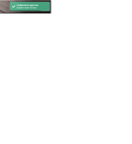

Yes, it works : when I click the SAVE button after a ten of seconds appears on top right of the window the message : “Configuration updated, the player has been restarted”,
but I have to repeat that operation at every boot, because after the first time, at the next boot, the library seems ok, but I can’t start playing anything…

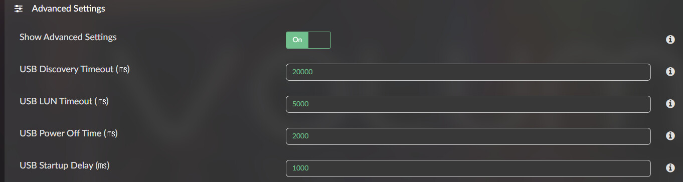

Hi @PeterT
This is most likely caused by the fact that the USB drives haven’t been recognized yet while everything starts booting after a restart. (not a Volumio issue but Hardware (driver chip) issue)
For V4 there is a plugin called “Raspberry Pi EEPROM Config”.
Under Advanced settings you can tweak timings like: USB Discovery, start up delay.
Give this a try and play with increased timings.
thanks for the very fast reply. It seems now to work, but I will need towatch if it is working constantly!
Thanks a lot!
