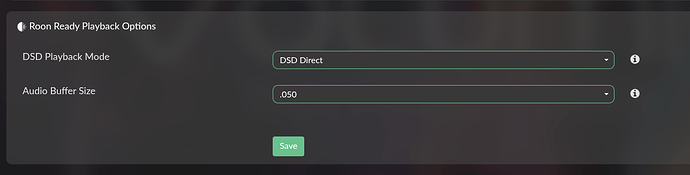

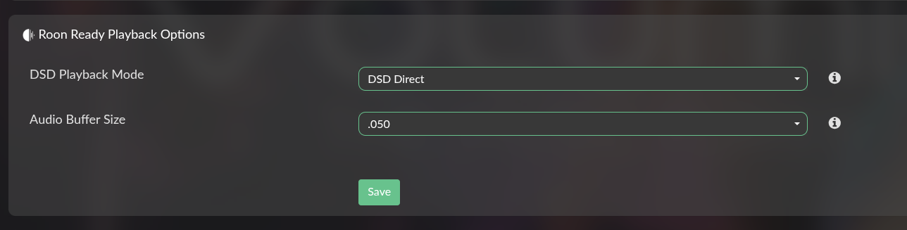

please make sure you have the DSD Direct option set in the Roon ready playback options
I am seeing exactly the same issue. I have set the Roon Playback Options in Motivo to DSD Direct as you suggested. But still in the Roon settings for Motivo there is no indication of DSD capability. Only PCM up to 768kHz is shown and Roon still converts to 32bit/352,8PCM.
Am I missing something here?
