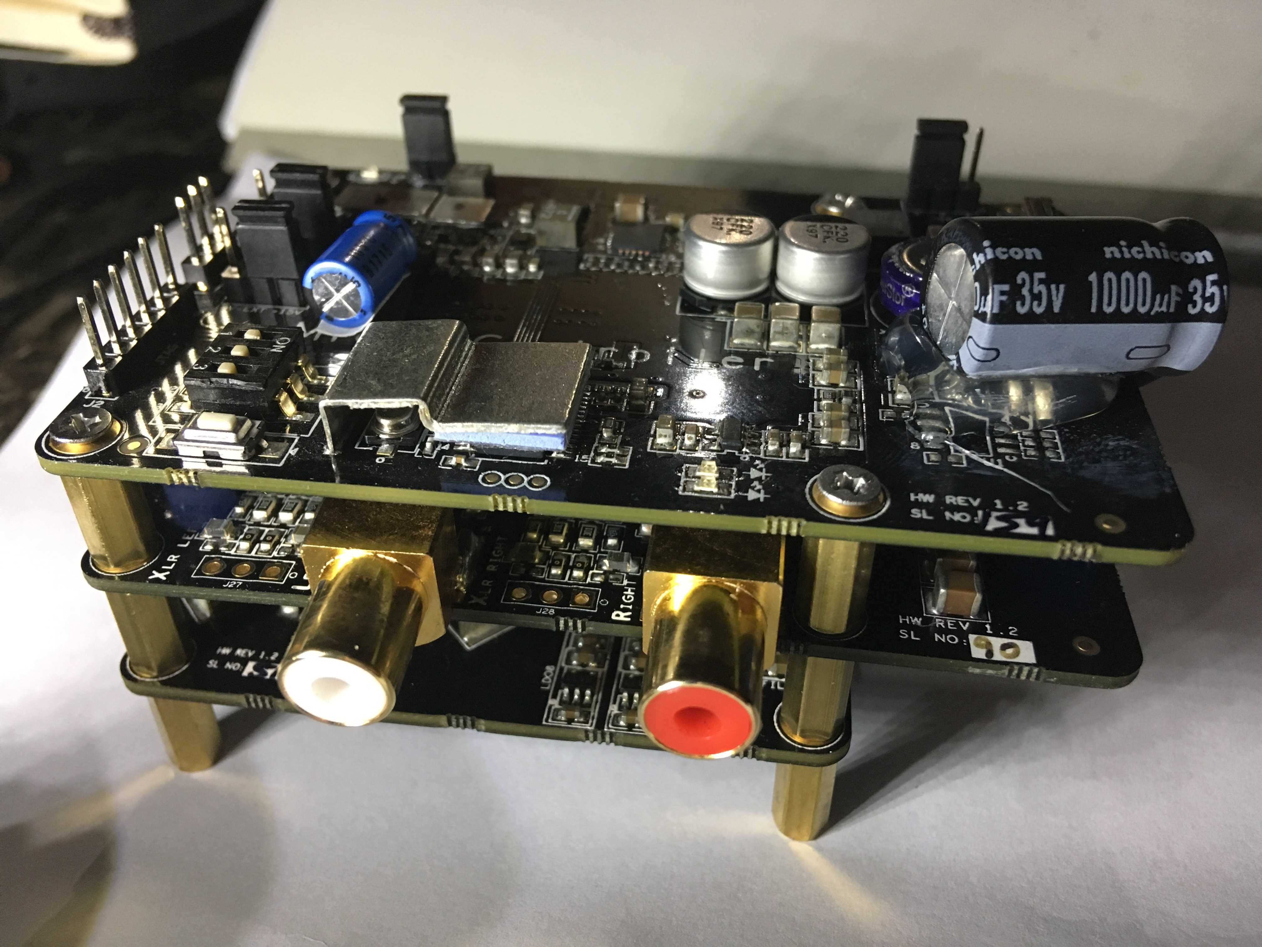

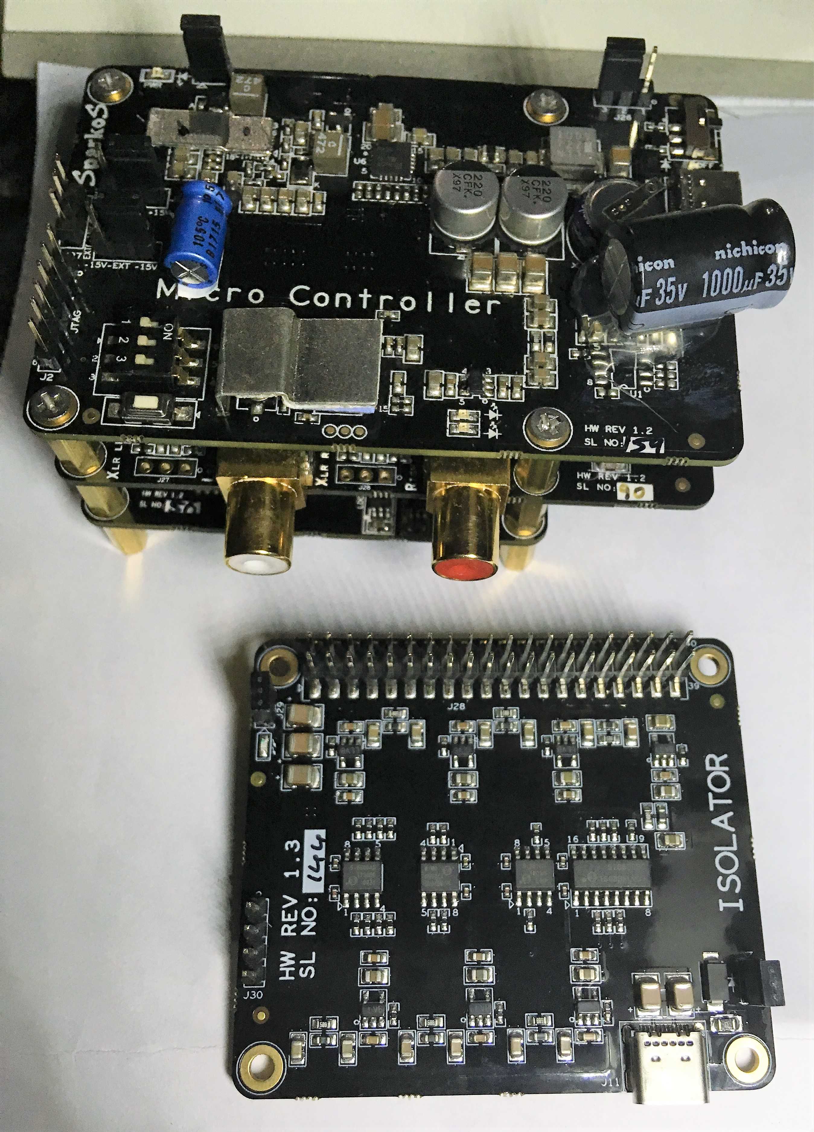

Received the new katana!!
It is beffier than the first version with newer audiophile components
And wollaaaahh…
The complete stack with isolator v1.2.
Well, I’ve no idea whether it sounds better or not, but the sight of that huge capacitor sitting on top of the controller shouts “After-thought” to me. Too complex…

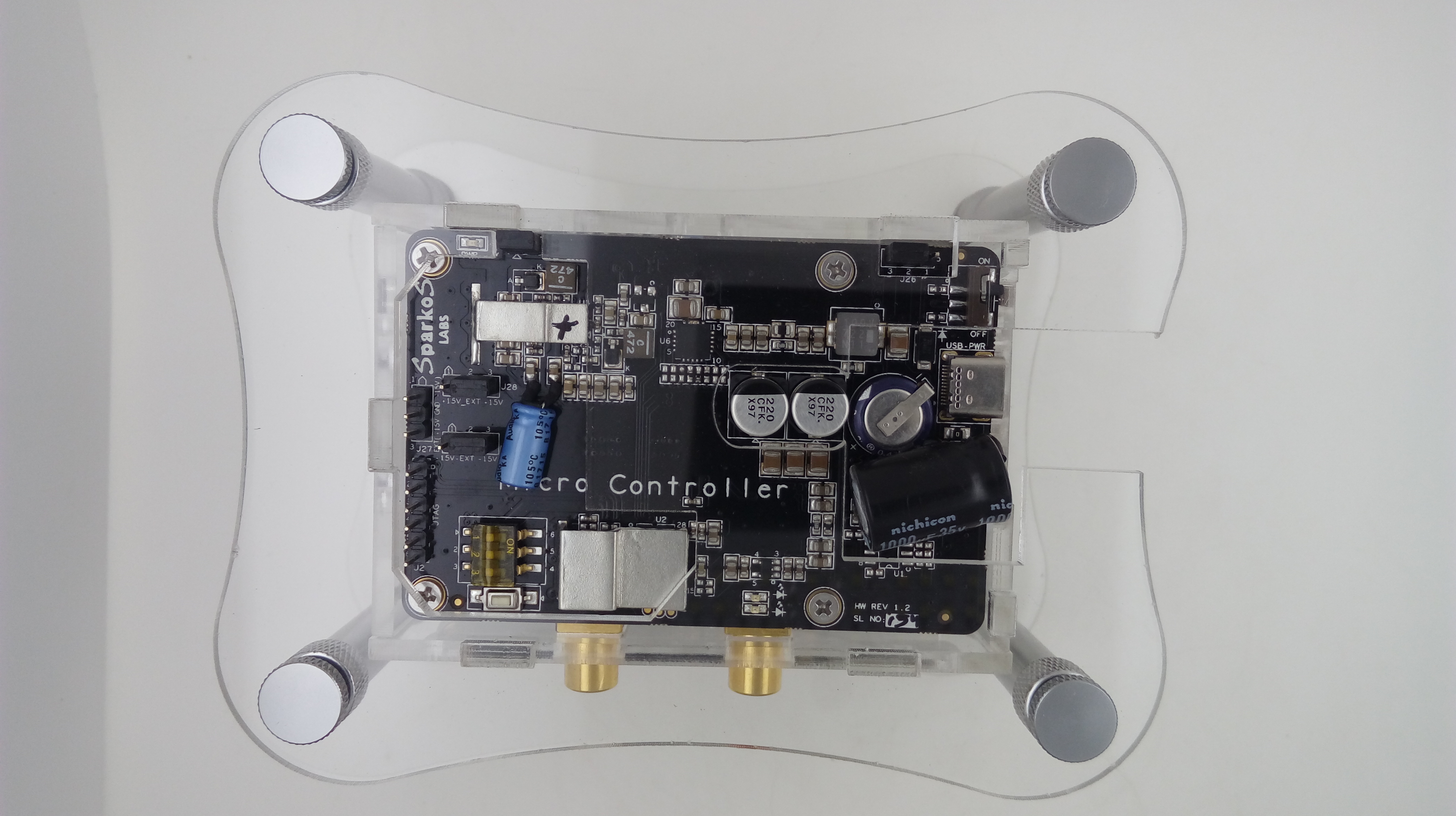

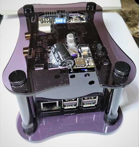

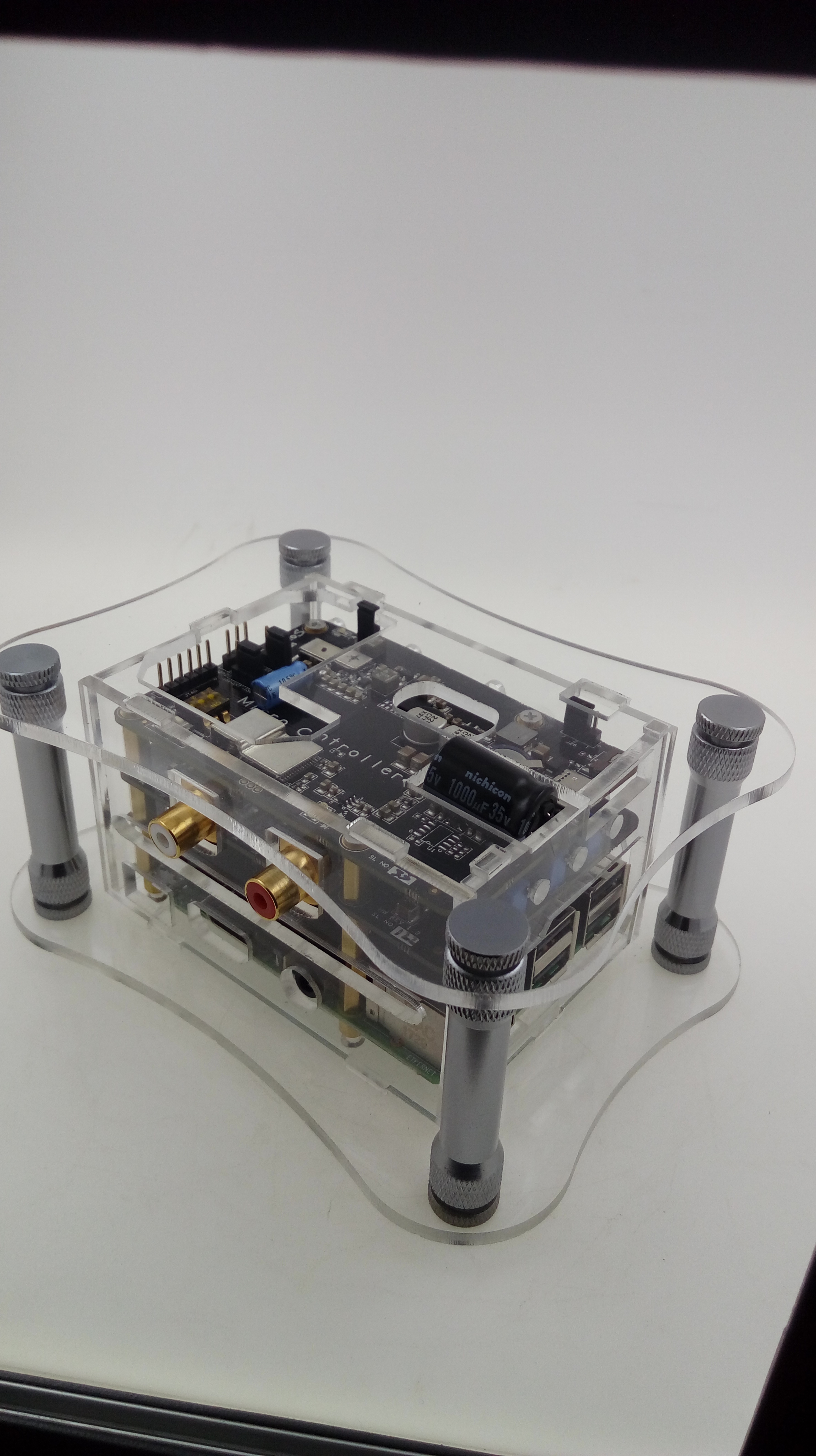

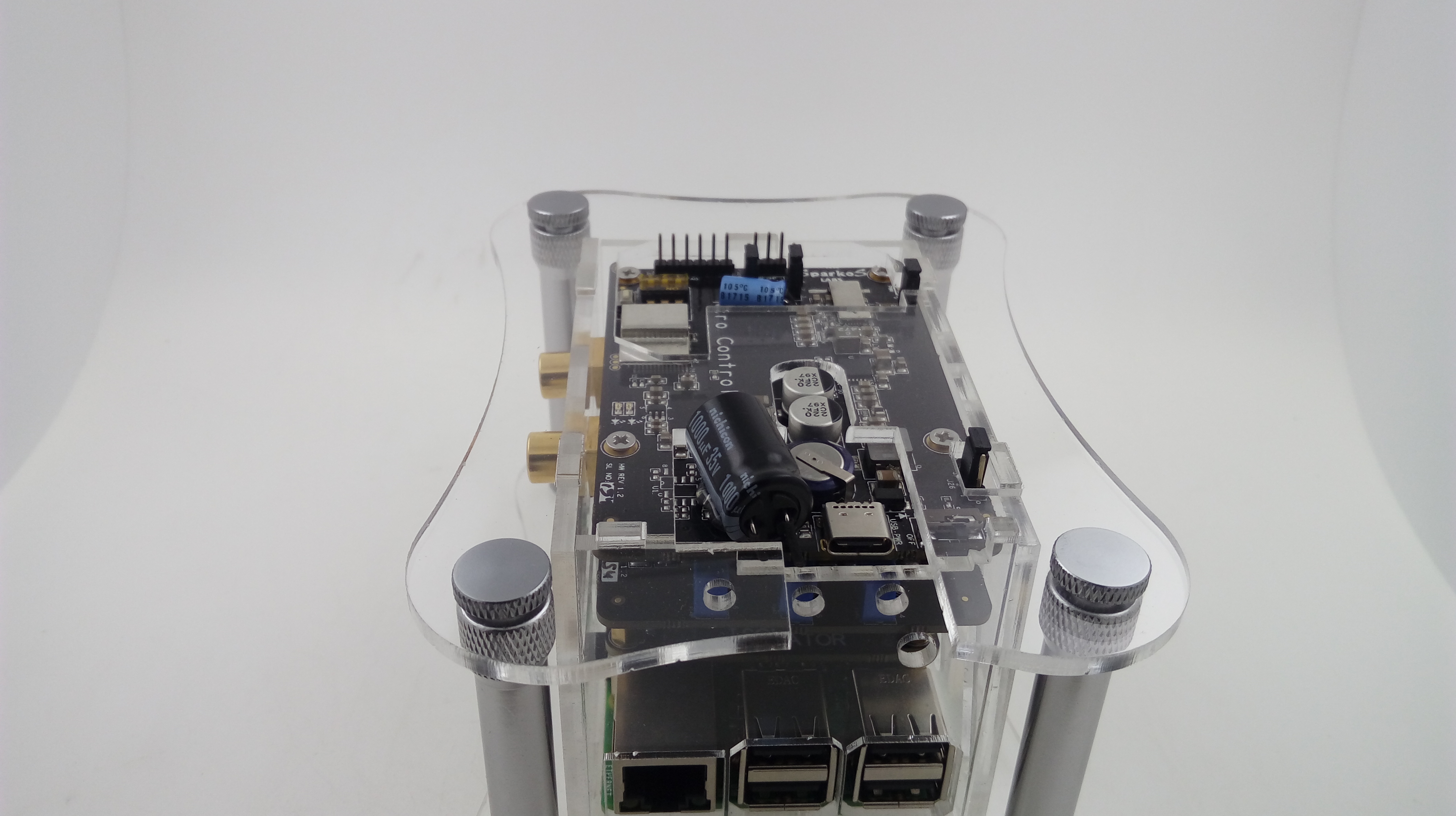

The design of the box was not very easy, especially on the box that had the isolator since we have been constrained by height. Still I will try to get some better pics to show you how it looks. Frankly it wont win any beauty prize but we think it looks at least ok.
The Katana without isolator (box) looks even better.

Hi to all,
see some better pictures of the case.
