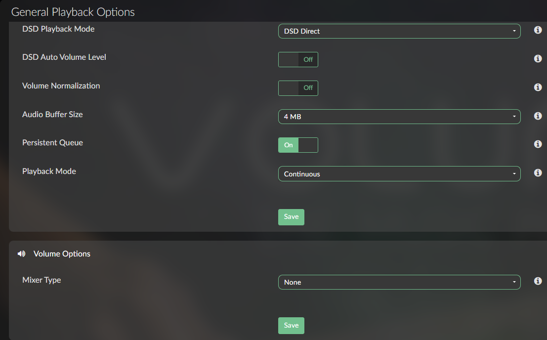

Connected the rPi3 to the Topping E30II, for some reason it displays PCM, even though the same playback settings as used on the x86 (DSD Direct - 4MB).
Connected the rPi3 to the NAD D3045 (DSD Direct - 4MB). It doesn’t display DSD. So it seems the rPi3 mess around with the play back settings.

Test 1: DSD512 - rPi3 - Topping E30II, DSD Direct - 4MB buffer - Mixer Type = None, No issues found,
Display shows 11.28 DSD
Test 2: DSD256 - rPi3 - Topping E30II, DSD Direct - 4MB buffer - Mixer Type = None, No issues found, Display shows 22.57 DSD
(Test 2 was failing before)
http://logs.volumio.org/volumio/CHdhlyl.html
Test 5: DSD256 - rPi4 - Allo Digione, DSD Direct - 4MB buffer - Mixer Type = None, No issues found
Test 6: DSD512 - rPi4 - Allo Digione, DSD Direct - 4MB buffer - Mixer Type = None, No issues found
