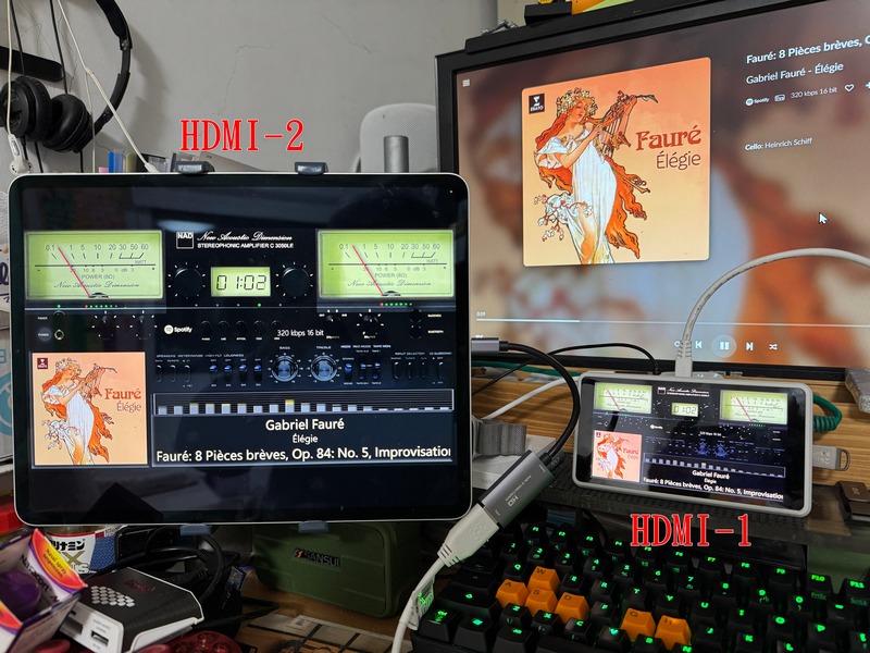

Forcing Touch Display Plugin to Use HDMI 0 and 1 on Volumio (RPi 5)

Alternative: Using Both Displays
If you want to use both screens:
