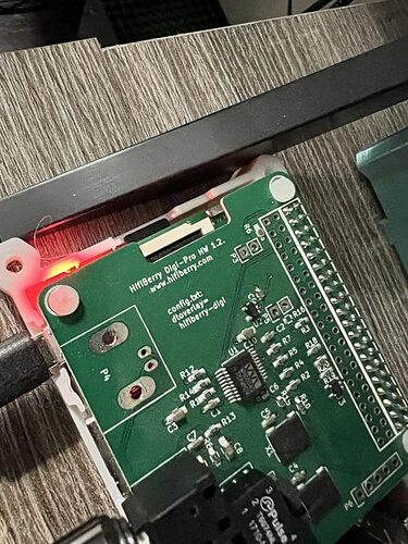

Hardware - some kind of raspberry pi, can’t tell without taking it all apart.
Dac is the Hifiberry Digi-Pro, HW 1.2.

The Hifiberry Digi-pro does not exist, they released the Digi+, the Digi+ Pro and the Digi2 Pro

I’m not sure what you mean by the Digi-Pro not existing - it definitely exists, I have one, and it worked great until upgrading to version 3 of volumio.

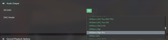

The official name of your HAT is “HiFiBerry Digi+ Pro”, even if the silkscreen on the PCB shows “HiFiBerry Digi-Pro”. Please have a look to the pictures on this link of the manufacturer website:
https://www.hifiberry.com/blog/hifiberry-digi-pro-our-most-advanced-digital-audio-interface/
So the entry to select in the I2S DAC list is “HiFiBerry Digi+ Pro”
