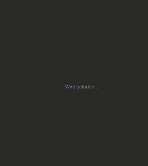

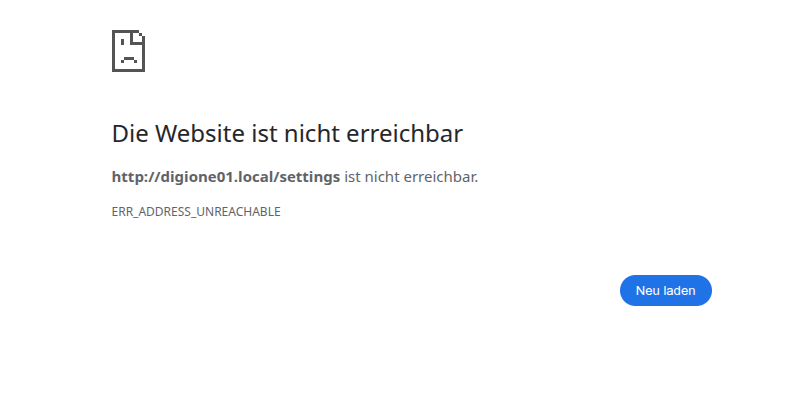

Very often, when I click a function (e.g., Search), ā€œLoadingā€¦ā€ appears first, followed later by ā€œThe webpage is unreachableā€¦ā€
This also affects the /dev page, making it difficult to capture a log at that specific moment—though it did eventually work.
After a few minutes, it comes back online, as if the system had been restarted.
This keeps happening repeatedly.
Manifest works perfectly—fast and without interruption, including /dev.
It’s running on an RPI3B+.
I also reflashed, updated to version 204 again, rebooted… but the problem persists.

I generated a log immediately after the crash.
In this instance, it took about a minute for the interface to become available again. It also just went offline briefly (for about a minute), even though I hadn’t done anything. (log2)
It affects the dev page as well.
On other occasions, it sometimes took significantly longer.
Log1
http://logs.volumio.org/volumio/xjz22Am.html
Log2 (…19:02)
http://logs.volumio.org/volumio/jv40qgf.html
Log after reboot, Website offline (ca. 19:16)
http://logs.volumio.org/volumio/veRmnZ7.html
However, the music continues playing normally. It is not a reboot of the entire system.
Happened again at approx. 19:20
http://logs.volumio.org/volumio/kxwbXoW.html

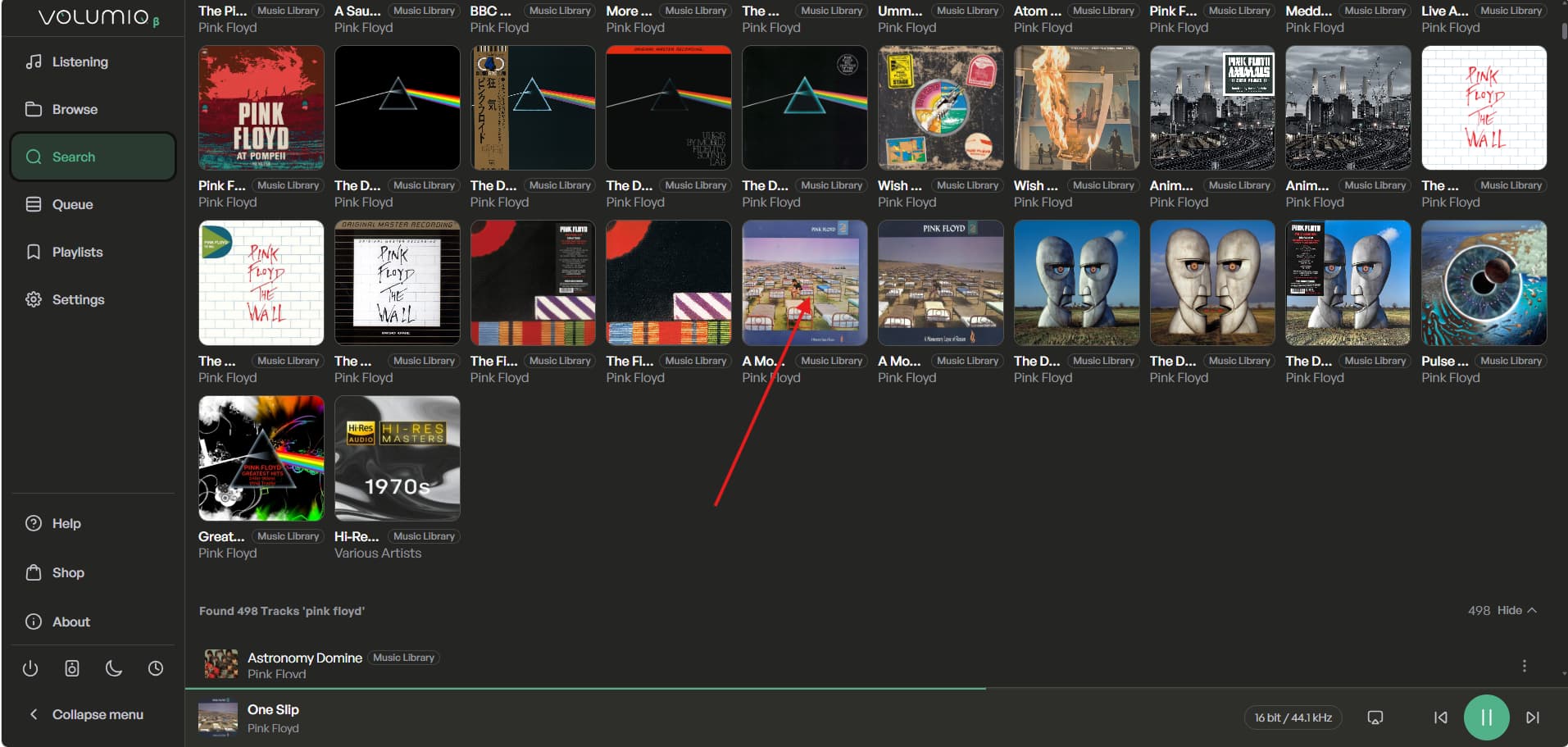

When I search for an artist and albums appear and I select one of them:

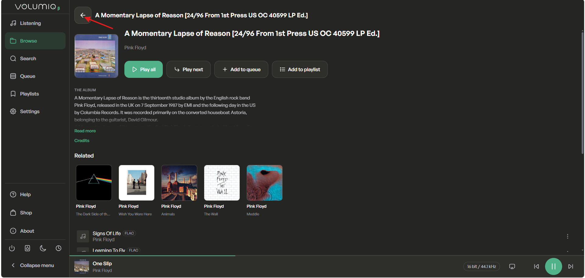

I correctly go to the album selected:

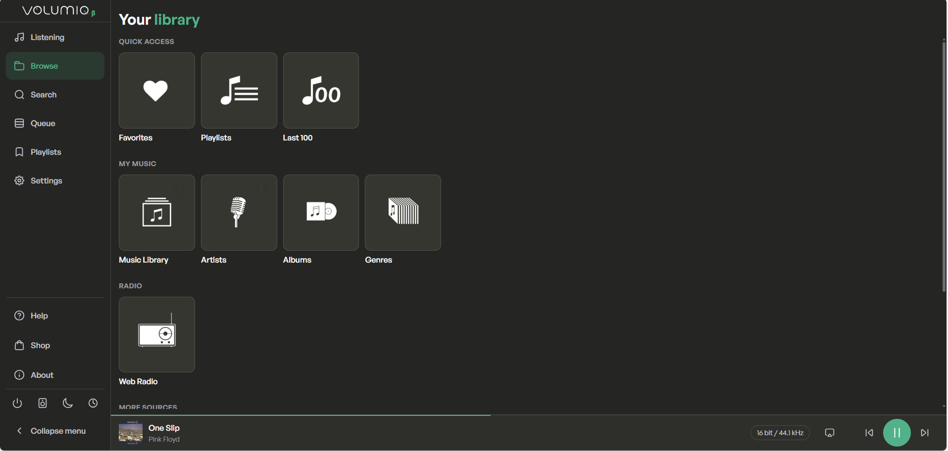

But when I press the back arrow I expect to go to the previous screen I was but it goes to the generic ā€œyour libraryā€ menu:

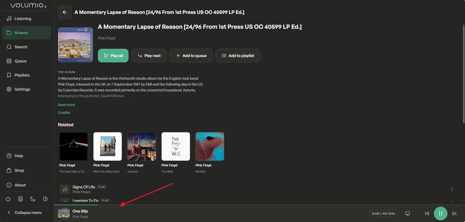

Another aspect which would be a good update is, when we are playing something, the time bar appears at the bottom, but one cannot advance on track on it, it always goes to the full playing album:
Nontheless, would it be possible to add a ā€œback buttonā€ to return to previous screen?
