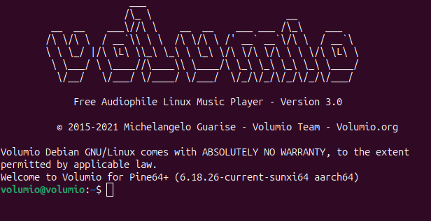

Image of Volumio 3.999 Pine A64+ unofficial
Image of Volumio tested on a working Pine A64+.
Volumio-3.999-2026-05-02-pine64plus.zip
Tested OK

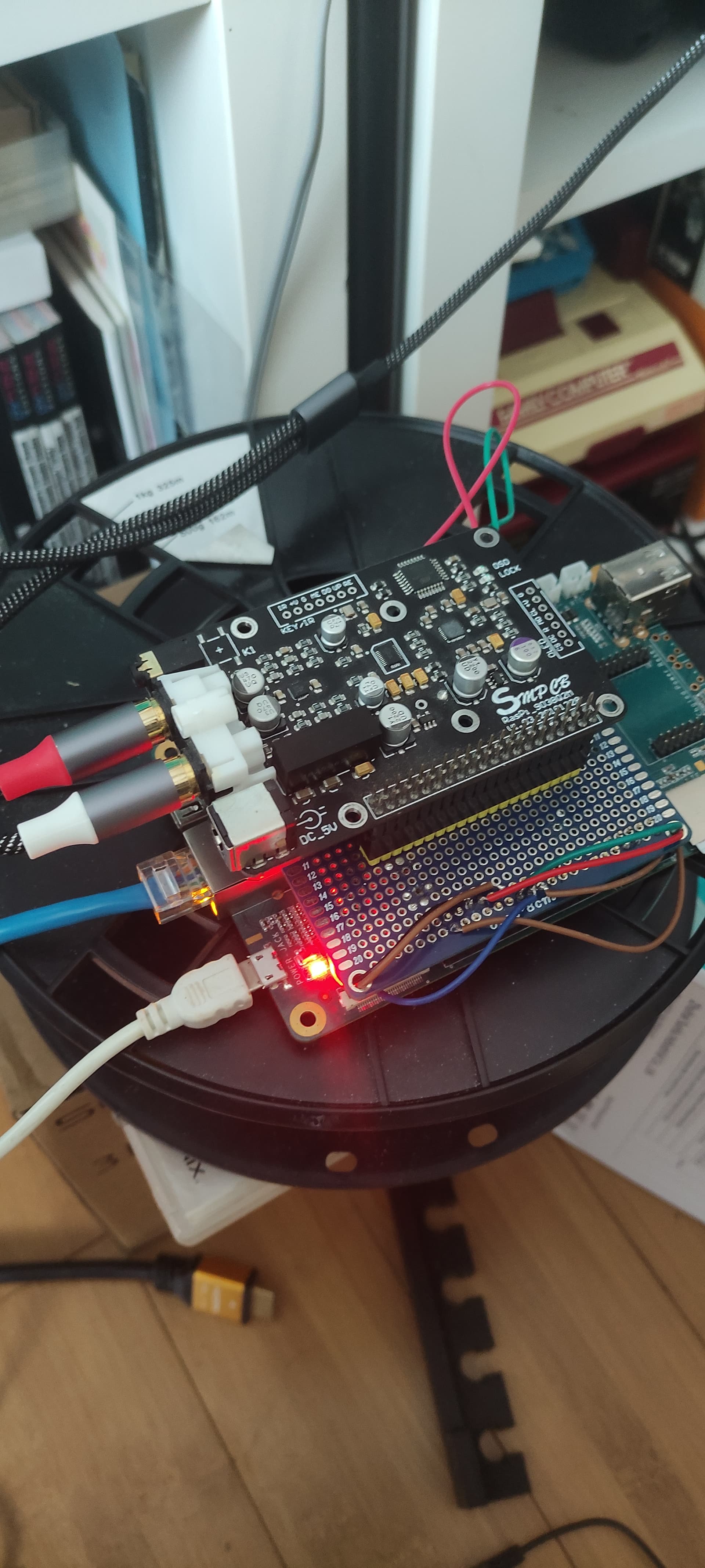

maybe can buy later second pine a64 board for hifiberry; is the i2s difficult to install (wires?)
I am surprised by the sound quality of the jack output of pin a64+, it’s really not bad.

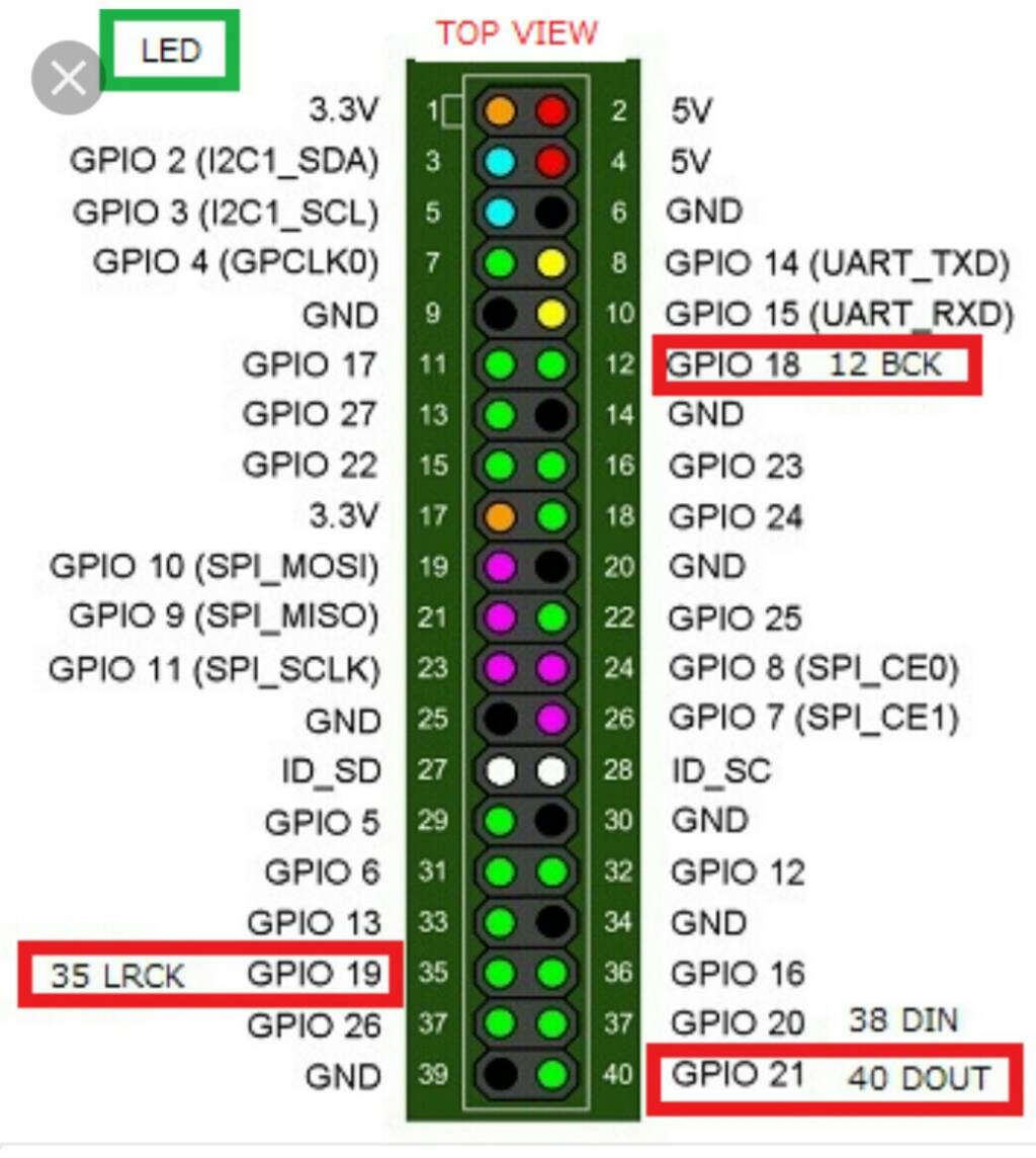

As soon as I have a moment, I’ll post a photo of the pinout for the i2s connection.

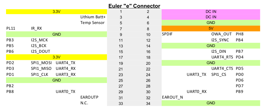

was using it (pine a64+) for libreelec previously for short time and noticed that on hdmi the pine a64 sounded very good imo; so was think it could be ideal candidate for volumio; probably it needs just a dac board as yusuggested; the hifiberry seem easy to install; but as said, here are quite some teeth bent; is it also installable on euler or does it need gpio?
looking forward, mercĂ­ beaucoup.

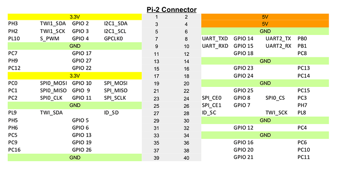

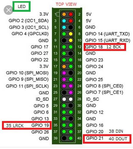

Pine a64+ euler ------------------ Dac PI
5v pin 8 --------------------------- 5v pin 2 or 4
GND pin 6 ----------------------- GND pin 6
BCK pin 13---------------------- BCK pin 12
DATA pin 15 -------------------- DATA pin 40
LRCK pin 12 ------------------- LRCK pin 35
It’s quite simple (it may need 3.3v depending on the DAC you’re using).
For DACs like the PCM 5122, also add this
SDA pin 3 ---------------------- SDA pin 3
SCL pin 5 ---------------------- SCL pin 5
