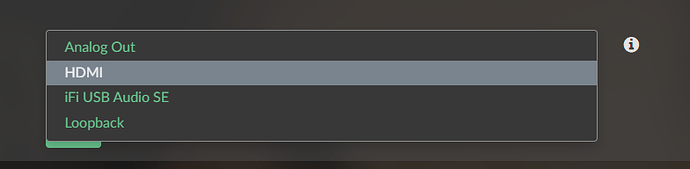

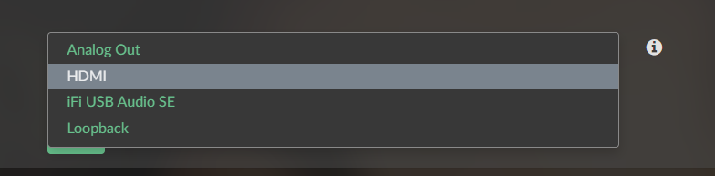

Btw, if you need card5 too here it is, but i guess is just the remote i use to control volumio (it has a microphone, guess that’s why is seen as audio). That said, my first tests were without remote, so i don’t think it can cause conflicts. Also, it doesn’t seems to be in the audio devices (???)
