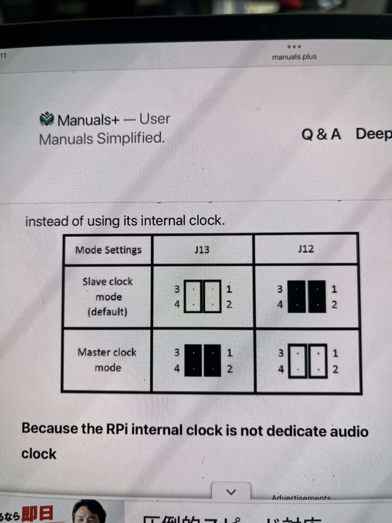

Check jumpers J12 and J13 in #3 IsolatorPi III (they must be set to Master Clock).
Ahhh ok… I never changed them from the default they were shipped as… I will try Master Clock mode…

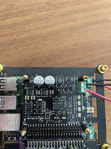

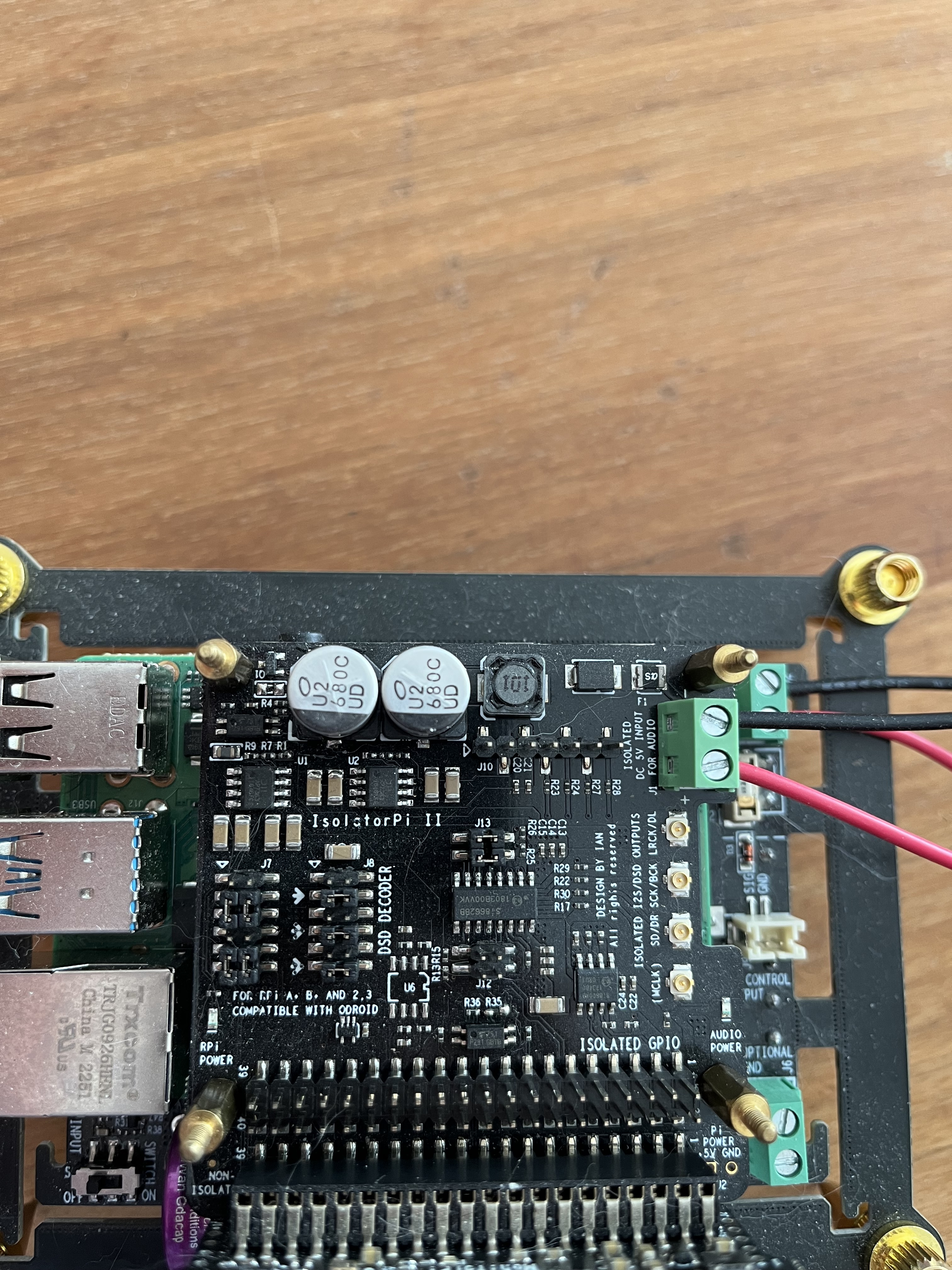

Looking at the manual and the board it looks like it is in master mode. Jumper on J13 and J12 empty (if I’m reading it right).
