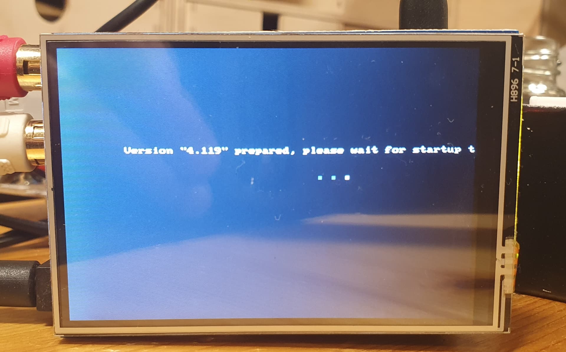

I installed a fresh Volumio 4.119 on a Pi3B with a Waveshare 3,5" touchscreen.
The screen seems to work during boot process as seen in the picture below.
But when the touch plugin is activating i only see a blinking cursor in the upper left corner of the display and then just a black screen. The touchsreen seems to responding to my fingers when i randomly touch it i was able to change the radiostations. I tried install an reinstall different versions of the touch plugin with no luck an now i cant get any further.

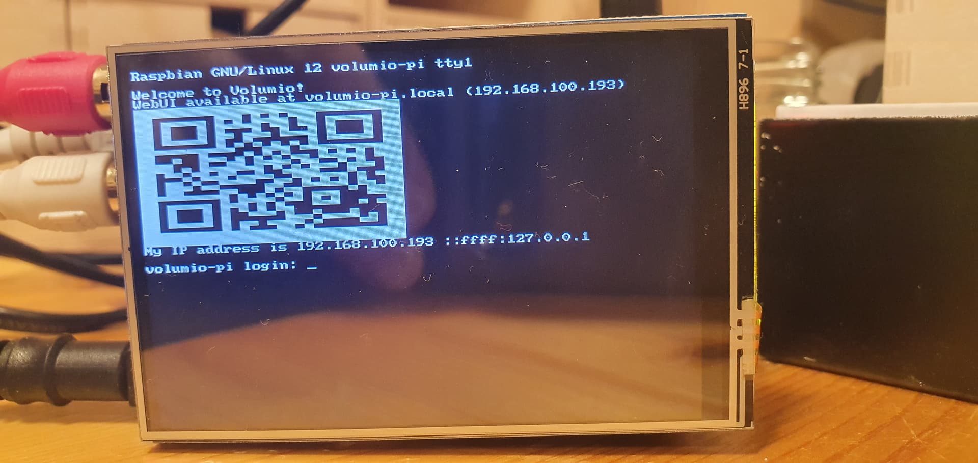

When the plugin is deactivated i see the login srenn for tty1 on the display
with kind regards Matze
when the plugin is deactivated i see the login screen for tty1 on the display.

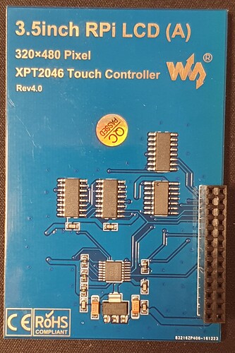

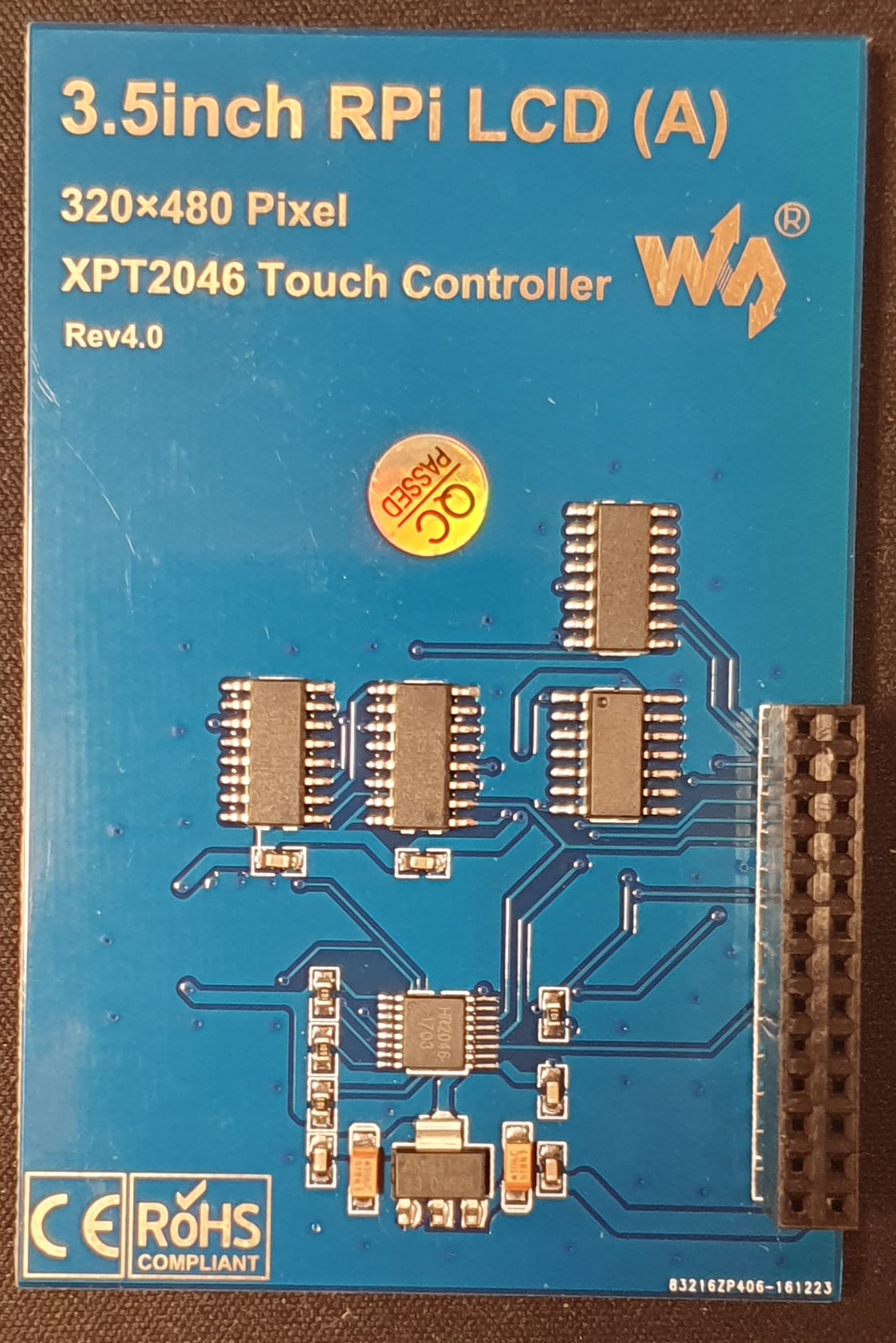

this is the 3,5" display i use

I have an obviously working waveshare touch display here, but when the plugin is loaded the screen just remains black. When i disable the plugin i can see the login scren on tty1 on the display.
The only thing that changed is, when i reboot the system i will see the volumio logo on my screen. ( see the picture the i added )
The Waveshare screen is obviously working, for my understanding there is a problem with the plugin, but i have no idea whats going wrong here.
