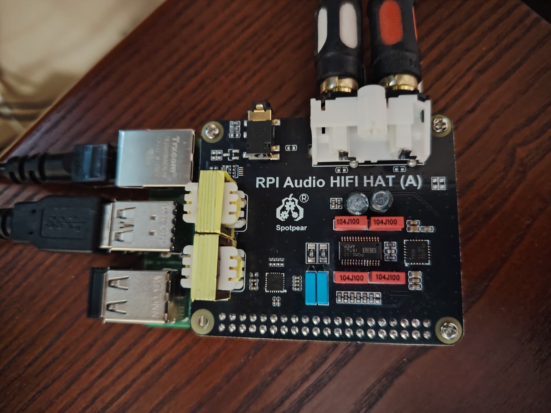

I kindly ask for your help in getting this DAC to work.

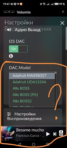

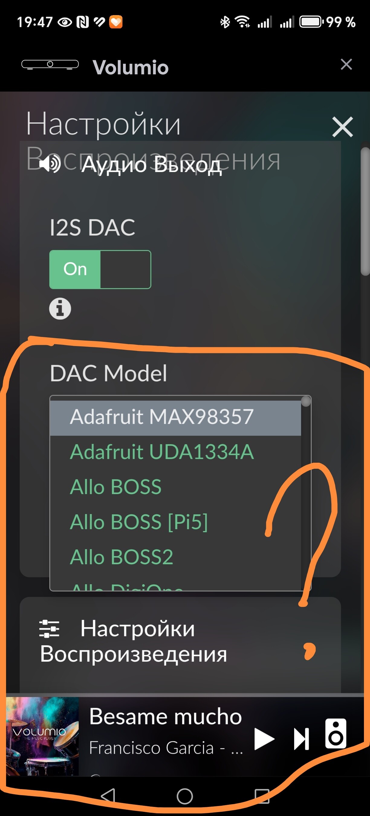

Good afternoon! Dear friends, I have a Raspberry Pi 5 and wanted to install Volumio. For this purpose, I bought a DAC. Upon receiving the DAC, I connected it to the Raspberry Pi 5 and hooked it up to an amplifier, but there was no sound. Although I switched the audio settings in Volumio to the DAC, the list of DAC models there does not include my board. I’ve shown everything in the photo. I kindly ask for your help in getting this DAC to work.

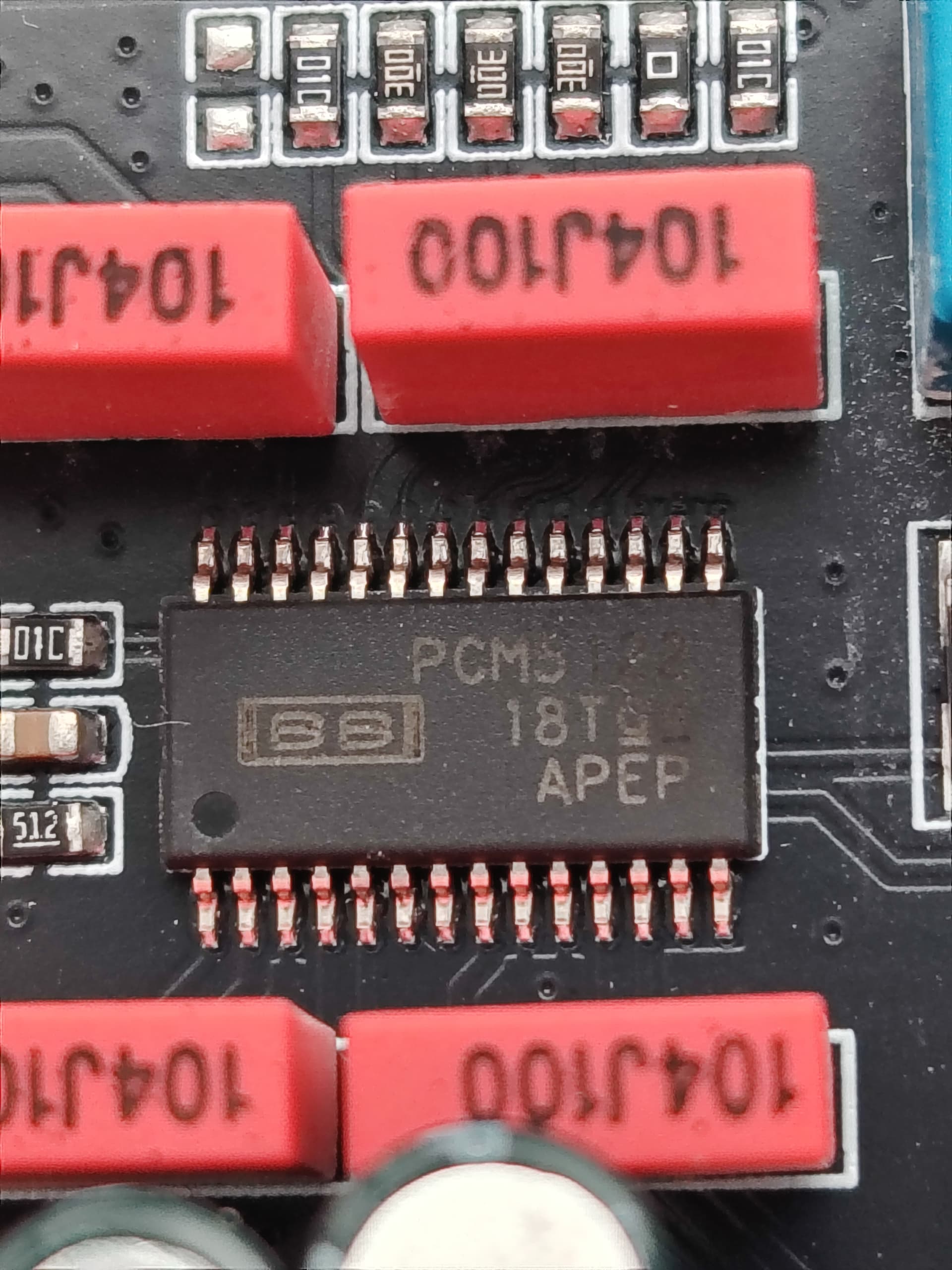

try „HifiBerry Dac plus“ as 5122 is the chipset.
where did you buy ? was sold as Volumio compatible ?
Thanks for the answer, bought it on AliExpress. It was said to be for Raspberry Pi 5.
