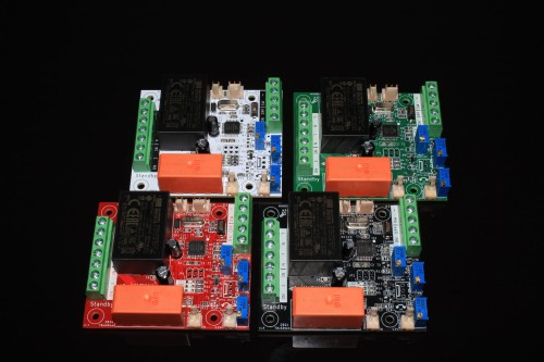

Hello Wil, for the Pi/DAC/SSD side of things, this may come in handy:
Greetings, Timo
