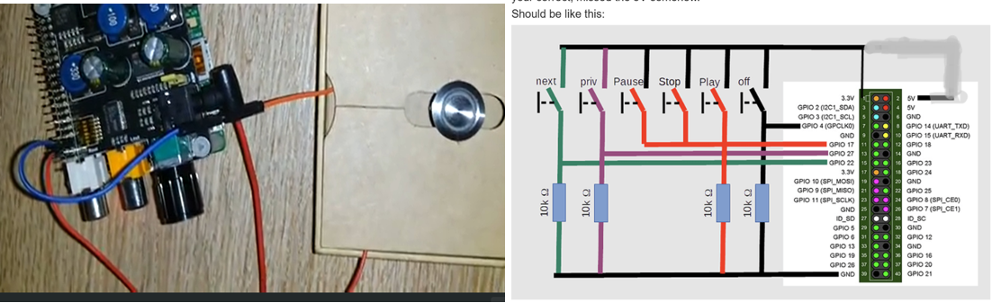

There’s a video on Youtube that appears to show a ‘two wire solution’ for the play/pause function – it appears that PIN 17 goes to GND via a resistor & momentary switch. The image on this forum appears to show that PIN 17 is permanently tied to GND via a 10K Ω resistor and is then ‘pulsed’ with 3.3V via a tact switch or similar to trigger the pause command – which method is correct?
Both, depending on pull-up or pull down approach.
