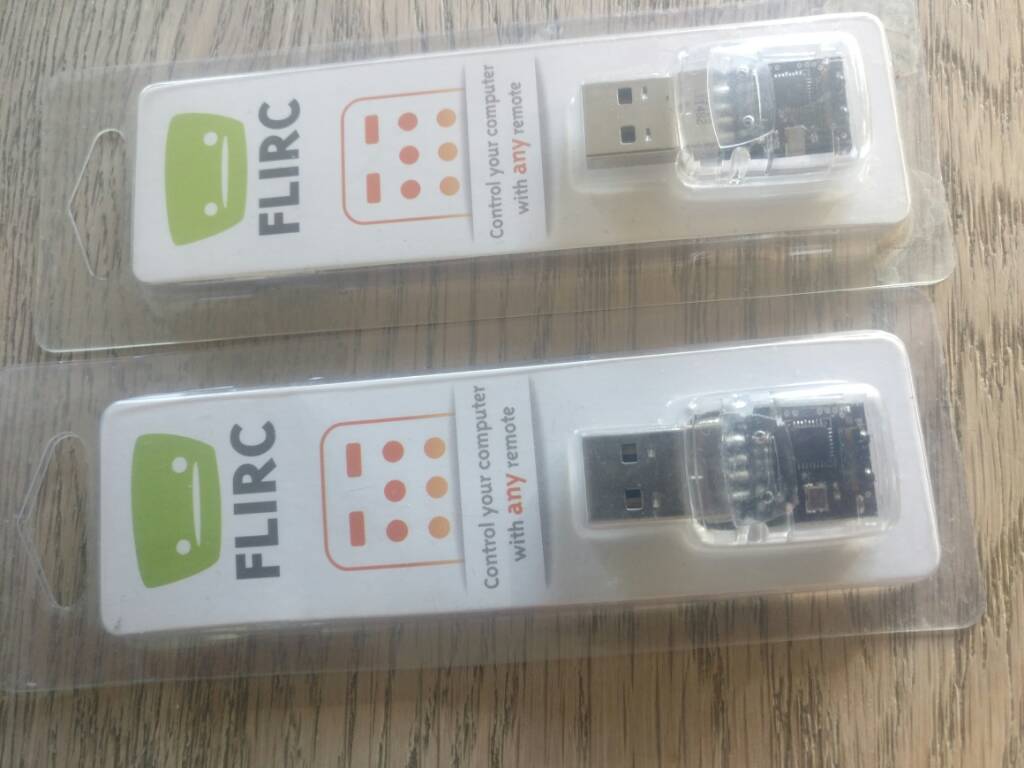

Is it possible to use on of these to control Volumio 2 on a raspberry pi? Also have a allo reclocker and piano dac connected
flirc.tv/flirc-usb
Sent from my ONEPLUS A3003 using Tapatalk
