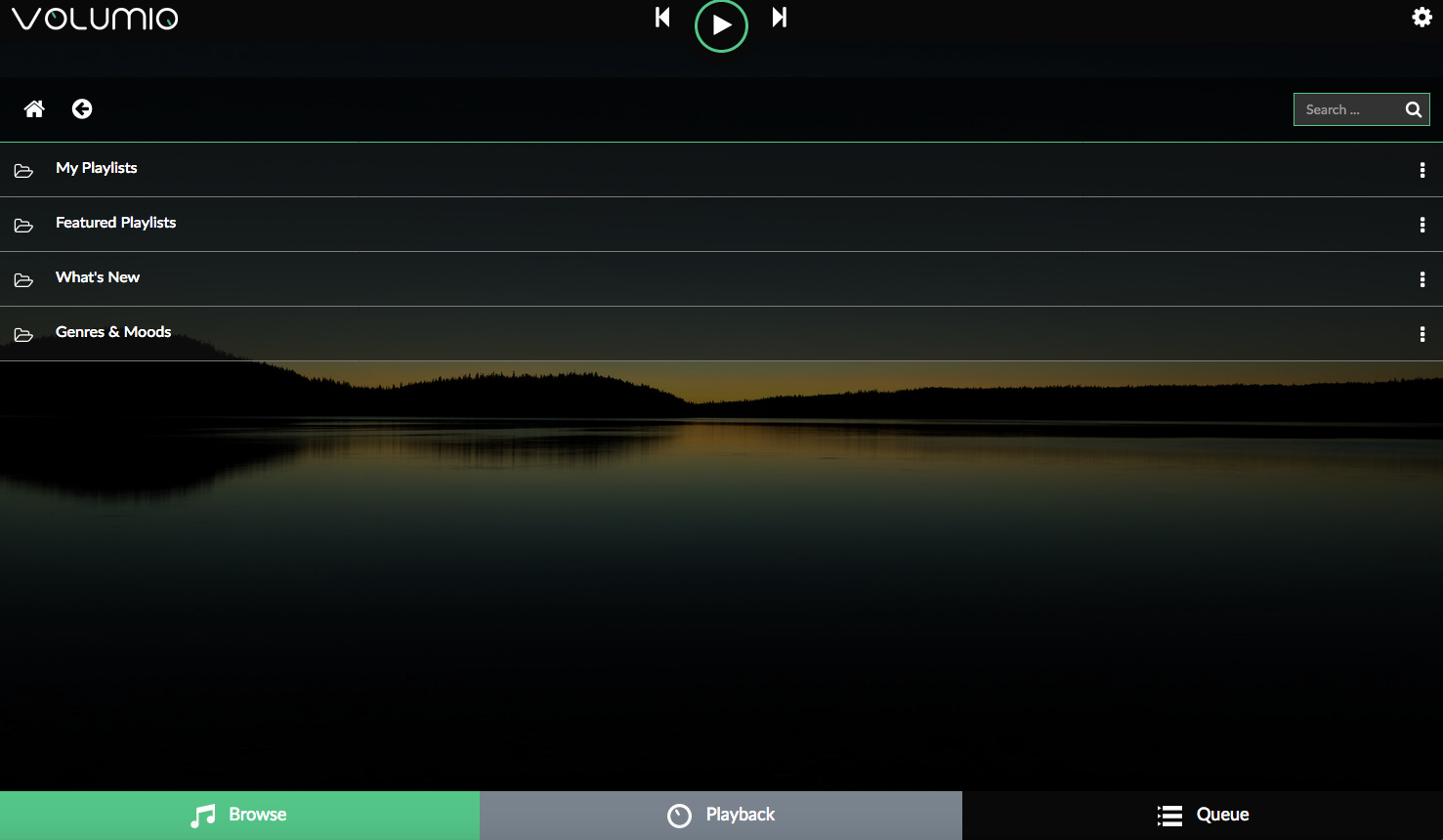

Screen Shot 2018-08-04 at 19.22.50.jpgHi,
just have some success now. I put some additional logging and found that 13 playlists were found but while reading the 10th playlist it looked like the application was stopping without reading anything else.
I checked my Spotify application and I have noticed I had only 9 playlist. So why it was listing 13?
I connected to open.spotify.com/collection/playlists and found I had 4 additional playlists that were black. I think they were some old playlists that I could not see in the desktop application.
I have deleted them, restarted volumio and now I can see my playlist. Hooray!!
I have one additional question. Clicking on sportify I can see the screen above. No saved albums, no saved songs, etc.
Any idea why these are not showing up?
Regards,
Alberto

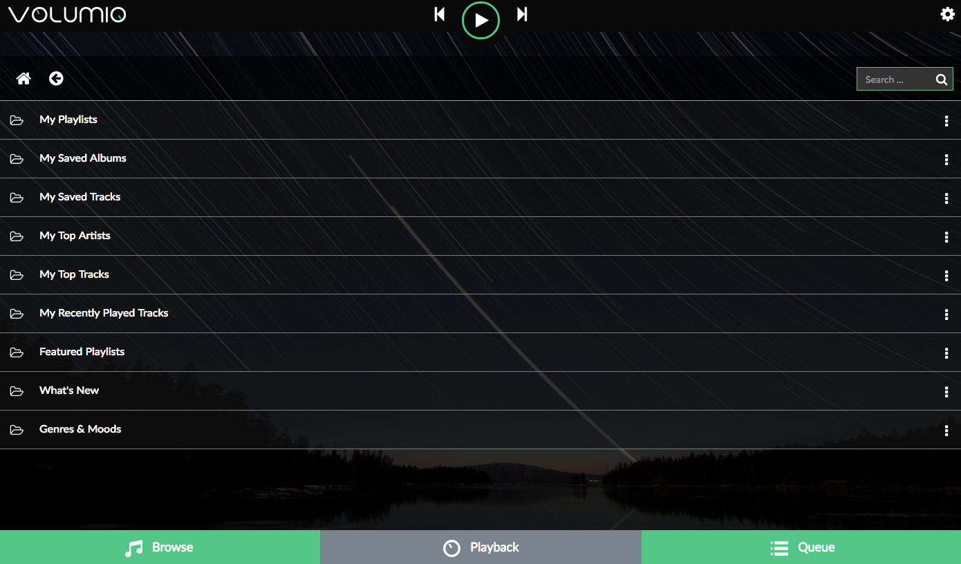

Great job debugging! Looks like I need some additional error checking somewhere.
But now I’m really confused. The updated index.js file I made available on Github that uses the Spotify refresh token also adds “My Saved Albums”, “My Saved Tracks”, … but your screenshot looks like the production plugin. You are using this version of the plugin file, right?
github.com/skikirkwood/volumio- … y/index.js
Hi skikirkwood,
thanks for the hint. I don’t know what I have done but actually the folders were missing in my index,js. I have downloaded the new version, updated everything, reboot and all is working now.

Hi Wilco, you should a screen with these options with the latest Spotify plugin. In addition to your playlists you should have:
My Saved Albums
My Saved Tracks
My Top Artists
My Top Tracks
My Recently Played Tracks
Featured Playlists
What’s New
Genre’s and Moods
Plus after the plug-in is installed you’ll see Spotify content in your search results which include:
Spotify Artists
Spotify Albums
Spotify Playlists
Spotify Tracks
When you click on a result in Spotify Artists you further see for that artist:
Top Tracks
Albums
Related Artists
It’s fun to chain through a set of Related Artists this way.

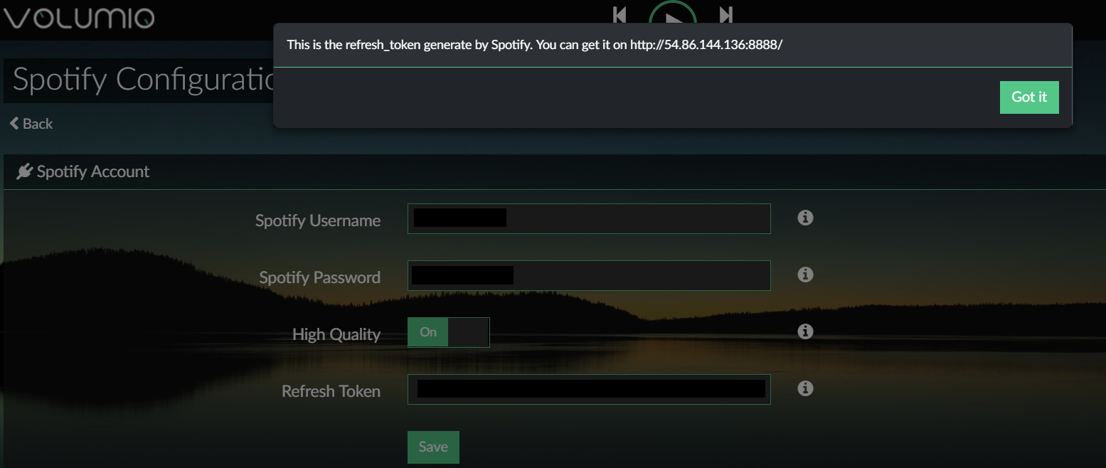

how far is a testing this plugin? Is it stable already? Are you thinking about automating to get refresh token or adding textbox for refresh token to UI?
I believe it’s quite stable. I’d like to add a textbox to the credentials screen where you can add your refresh token, if someone could help me do that it would be great.
I’m going to hold off on integrating the OAuth server part until for now.
I looked into code. It looks not hard. I try add it, but without warnity.
Thanks! I took a quick try a while ago and didn’t get anywhere, so your help is greatly appreciated.
drive.google.com/drive/folders/ … sp=sharing
here is my little help. I have issue with github. I cannot publish my branch with changes, therefore I send link to zip with sources.
How I use this
  • install plugin from volumio store
  • replace
    UIConfig.json
    config.json
    index.js
    spop.conf.tmpl
  • enable plugin
  • enter credentials
    -disable plugin
  • change
/data/configuration/music_service/spop/config.json
add text
"refresh_token": { "type": "string", "value": "cccc$ },
-enable plugin
  • NOW, entering credentials works properly
You can check if it work with sudo journalctl -f . Relevant log messages contains text DAVE.
I don’t know how to create plugin zip packages for better test :frowning:
Great work! I’ll try it out in the next couple of days and then merge your changes into a new branch and issue a Github PR to the Volumio folks. Thanks for this!
I hope, it will be usefull. My biggest issue was with self.config.get('refresh_token') , therefore the log messagess and changing /data/configuration/music_service/spop/config.json
