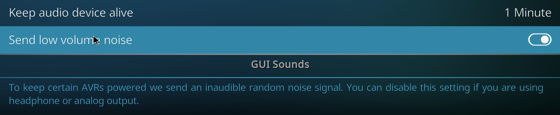

Some devices and software players have an option to send a very low volume audio signal to the HDMI port to keep it alive. Is there any way to do that in Volumio?

This would be very easy to fix if Volumio were to always send a very low volume noise signal (so low that most people wouldn’t even hear it), which is what Kodi does:
Now, is there a way to maybe edit some config file in Volumio to make this happen, or is it impossible since it needs additional code to be written for it to be available?

Kodi solves this with exactly the feature you screenshotted - it keeps the audio device open and sends inaudible noise to prevent the receiver from dropping the connection. This is a well-understood solution that has existed in media players for years.
Volumio does not currently have this feature in its UI.
The underlying audio engine (MPD) does support it natively. MPD has a parameter called always_on which, when set to “yes” in the audio output configuration, keeps the ALSA device open even when playback is stopped and sends silence to the output. This would keep the HDMI audio link alive, and the Onkyo would never lose lock because it would continuously see a valid audio stream. The infrastructure is there. It just needs to be exposed.
