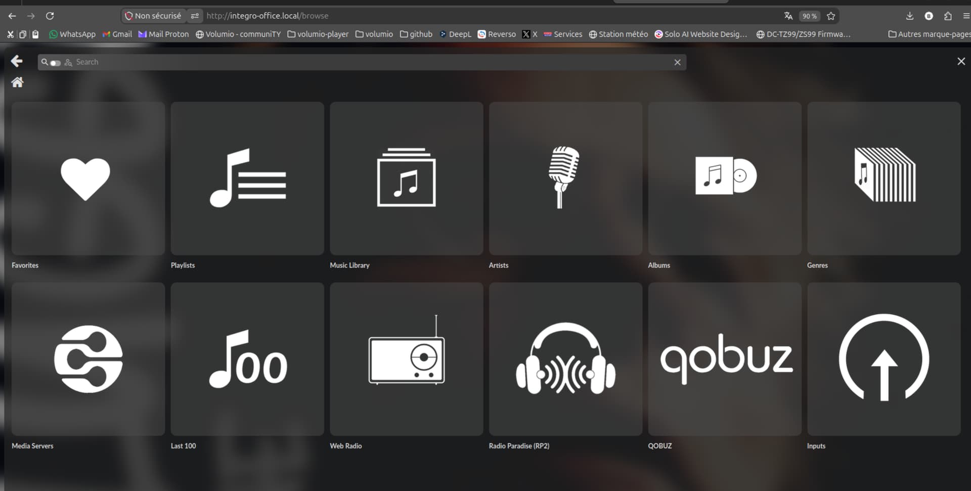

@balbuze,

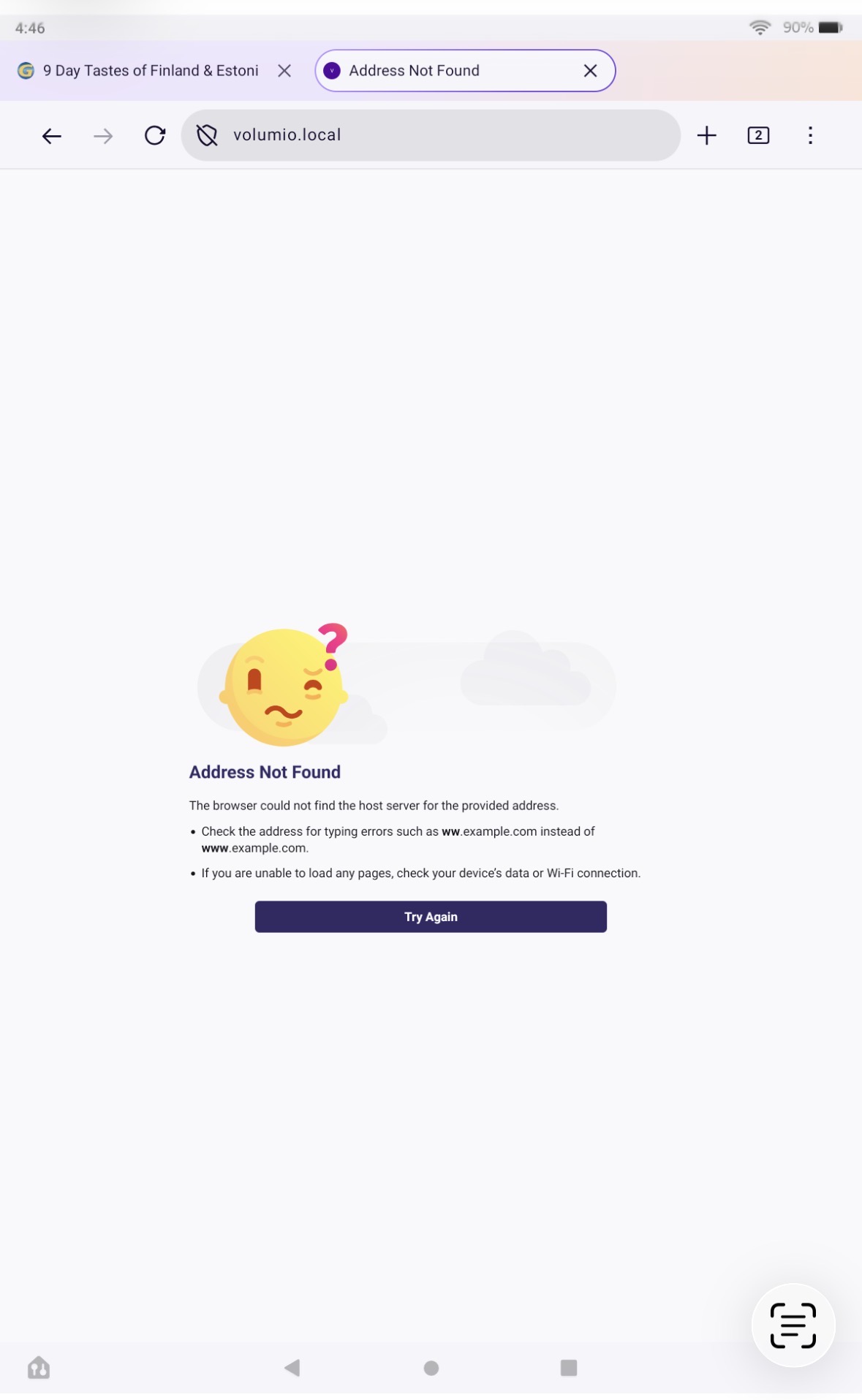

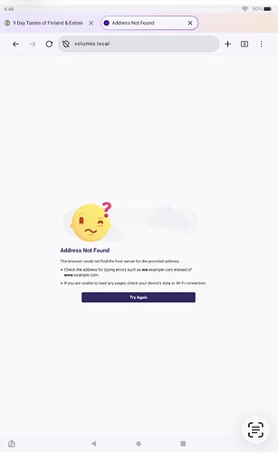

It also works for Android. (Pixel, Android 17)
@rost21A ,
Sorry it doesn’t work on my Amazon Fire Tablet which runs Android. The IP address works fine however as does the Volumio app for Android.
