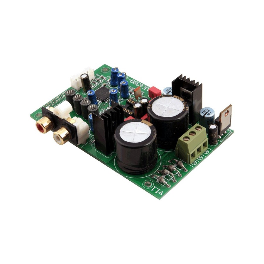

Another one AK4399 based (i love the sound of this chip) :
Not tested yet …

A big new one …
Diying to try i love Sabre DAC …
No embedded clock on this DAC. The AK4399 needs a MCKL signal which is not provided by the PI.
I bought an USB to I2S interface with MCLK to make this DAC working.
Sounds very nice.
