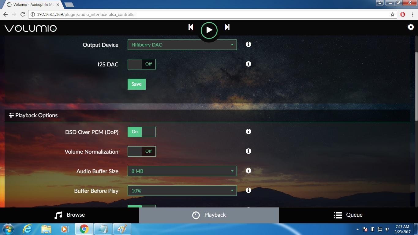

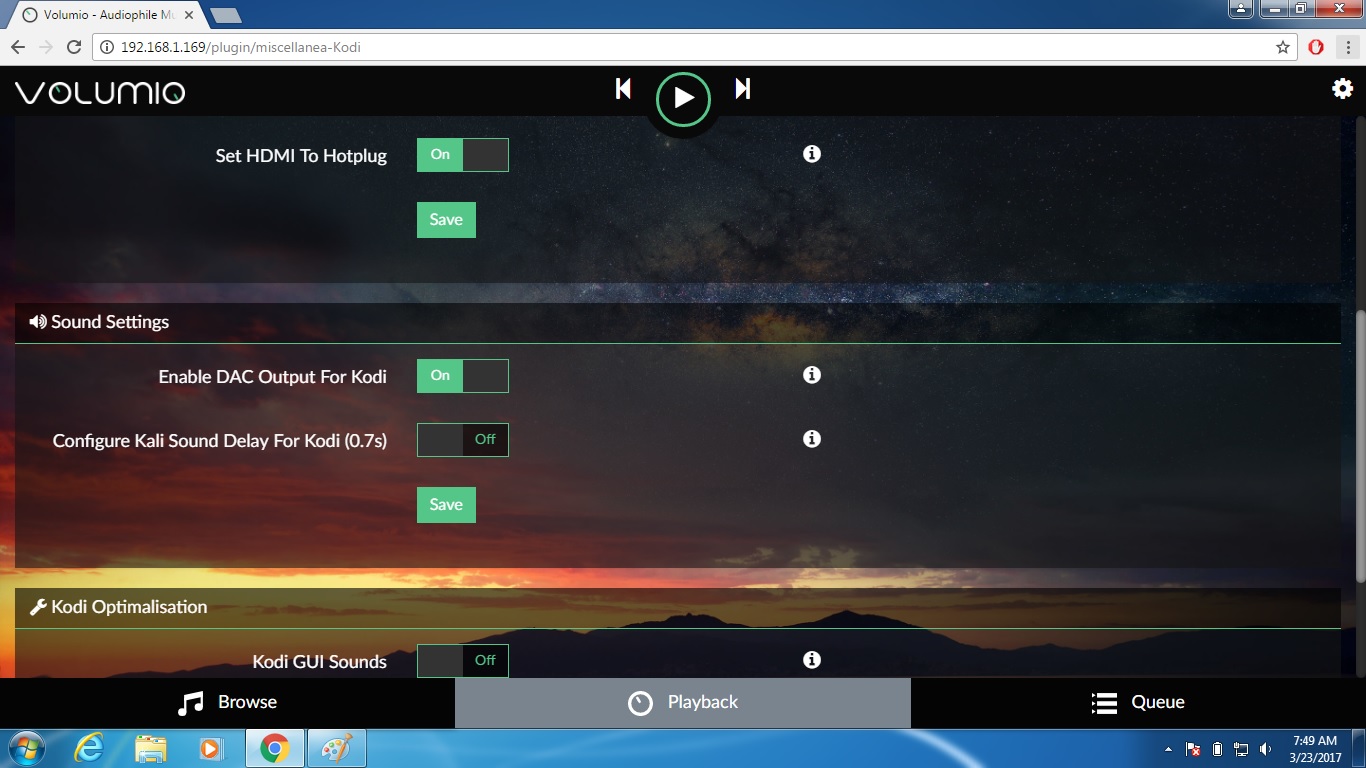

Thanks! :slight_smile: Due to Volumio rewriting the complete (yes all of it) config.txt you need to either:
  1. Setup your DAC before installation
  2. Setup your DAC afterwards and
    2a. Edit one value in the Kodi config (settings page of the plugin) and save (this will write all settings to the config.txt file)
This should cover having the correct config.txt and thus being able to run Kodi and have a DAC installed. Enabling the DAC in Kodi requires some more steps:
  1. Make sure the DAC is enabled for output in Kodi → go to the settings page of the plugin and switch ‘Enable DAC output for Kodi’ to ON.
  2. You will need to restart Kodi for the above change to take effect, you can do this by stopping and starting the plugin.
  3. Lastly you will need to select the DAC in Kodi, go to settings > system > audio and select the correct DAC.
That should cover it.

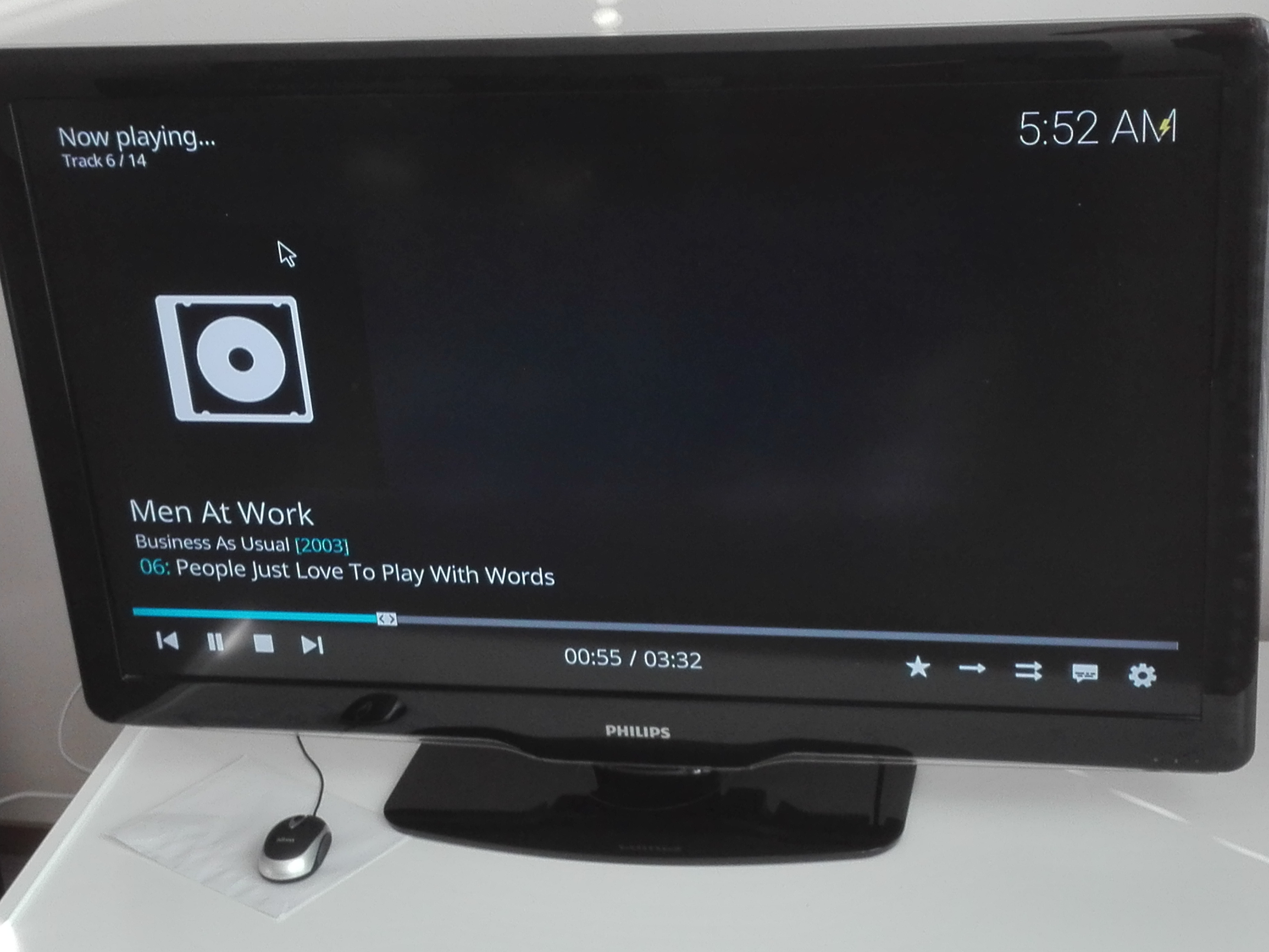

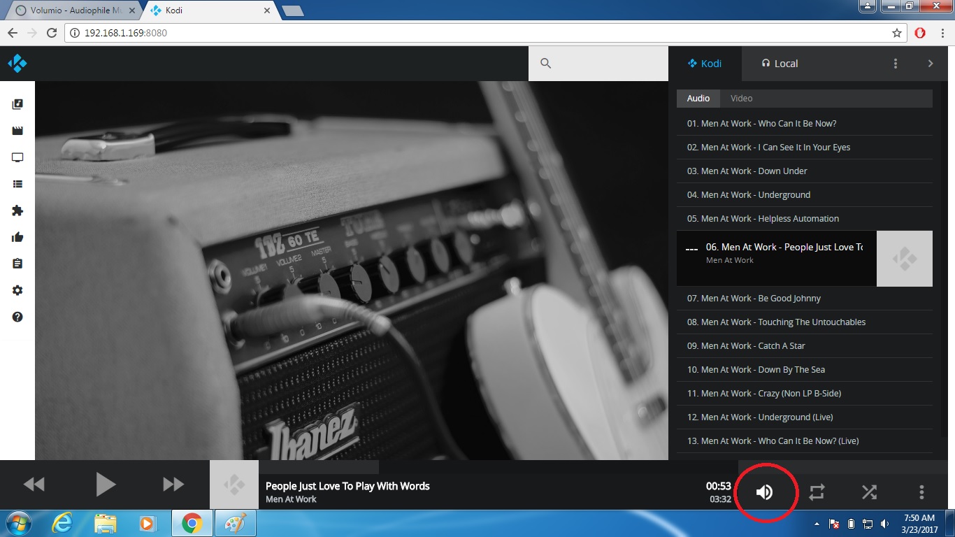

Maybe you have any idea where i messed up? I took few screenshots from the volumio settings, as well as from the view of kodi player on tv and on browser.
is this TV screen the whole screen that you guys see when you launch player? because i see no volume control. On web browser i can see volume button but it doesn’t allow me to reduce it, only works as a on/off button either sound is on on full volume or completely off. Also have bluetooth remote control, it works well for navigation but again Kodi doesn’t react to its sound buttons. Any hints?
