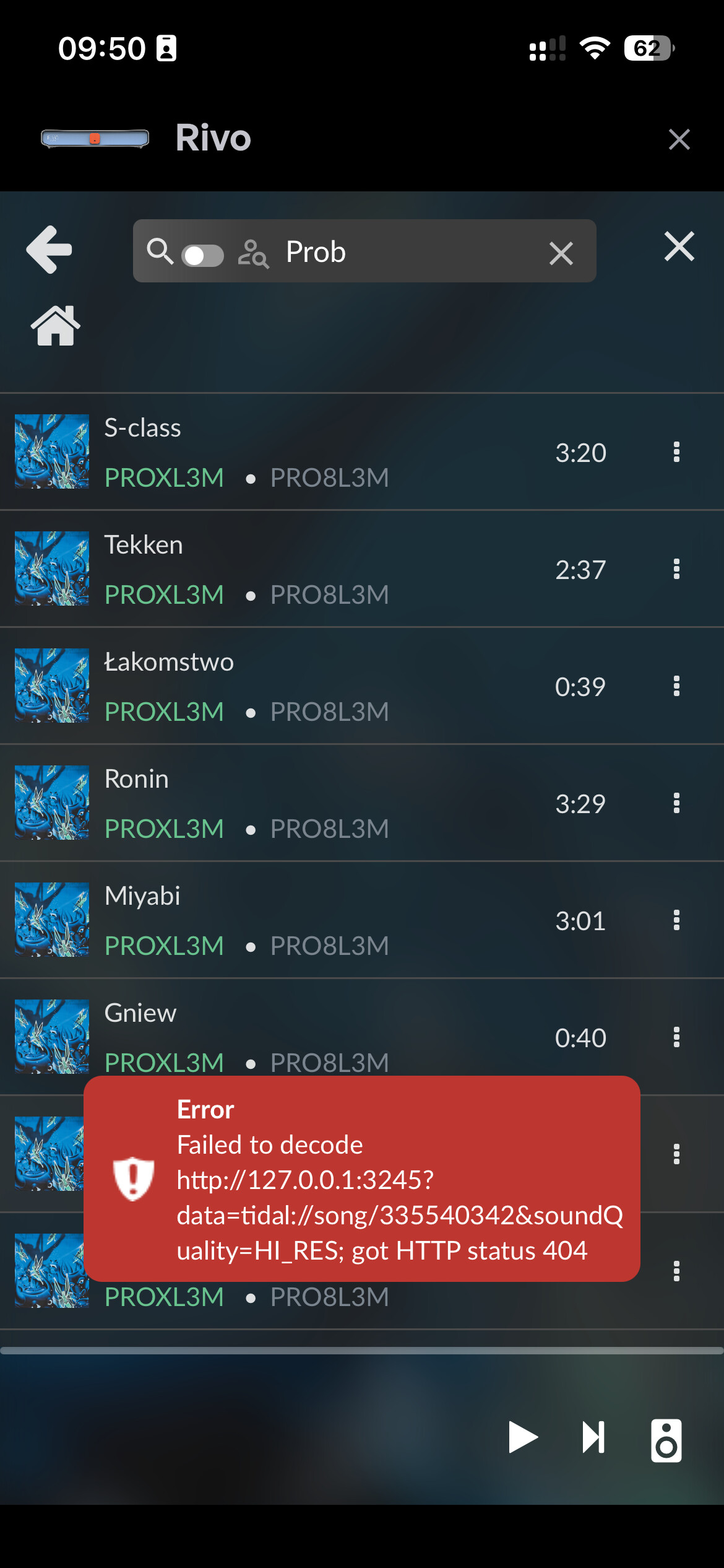

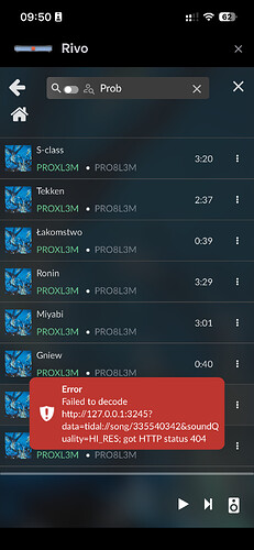

"failed to decode" error message on Volumio Tidal-Connect
Running v3.779 (11/08/2024 update), all the sudden I am getting “failed to decode” while trying to play a Tidal-Connect song??
Can’t use Tidal-Connect, local files on USB drive working fine. RP3b/Orchard Audio
PecanPi DAC
Note: Volumio updated just now to 3.782 (12/02/2024 release).
Live Log: " info: ------------------------------ 1ms
info: sendMpdCommand play took 2 milliseconds
STREAMING PROXY: Handling url /?data=tidal://song/381831871&soundQuality=HIGHEST_POSSIBLE
info: Executing endpoint getStreamUrltidal
info: CoreCommandRouter::executeOnPlugin: tidal , getStreamUrlAPI
info: getStreamUrl took 209 milliseconds
error: Failed to retrieve real stream URL Could not get TIDAL Stream URL: failed to get stream from provider tidal: rpc error: code = NotFound desc = failed to get track playback info: got 404: {“status”:404,“subStatus”:2001,“userMessage”:“Resource not found”}
STREAMING PROXY: Error: Failed to retrieve proper real streamUrl: {“success”:false,“error”:“Could not get TIDAL Stream URL: failed to get stream from provider tidal: rpc error: code = NotFound desc = failed to get track playback info: got 404: {"status":404,"subStatus":2001,"userMessage":"Resource not found"}”}
info:"
GOT IT WORKING! SMH…Ok…that was a total waste of time :frowning: …logged out and back into Tidal-Connect and it seems to work??? What the heck happened??
Same issue. Logging out didn’t help. Any advice would be appreciated.
