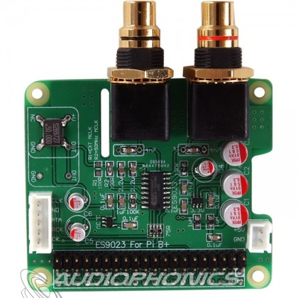

Hi guys, I’m very interested in buying a dac for my pi 2 and I’m thinking about a Sabre based dac, Audiophonics have 2 versions of them, the one you tried :
audiophonics.fr/en/kits-modu … -8396.html
and this one, that cost 3 times the first one:
audiophonics.fr/en/kits-modu … -9341.html
I contacted Audiophonics and they said that the second one is plug and play and have the clock installed
Have someone ever tried the second one? does it work well? it seems built a bit better…
I’m a newbie in the diy and raspberry field so I prefer the easiest solution, but in your opinion is the second one a waste of money compared to the first one?

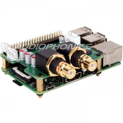

I own both of them. They are actually the same!
The “version 2” is HAT compatible so plugs and bolts directly on the A+ and B+. Bolts and risers are included.
Very convenient and sturdy setup
They both work with the Hifiberry driver.
I bought the “version 2” for approximately 30$ (agent handling and shipping included) on Taobao.

I finally bought the HAT version but received the new superior version with TCXO , don’t know why and I doubt that the greater clock provides a very different experience… anyway… thanks Audiophonics!
I’m using it with Volumio, plug and play connection, with only 3 tap I choose the Hifyberry drivers, 3 minutes and I was listening my music
