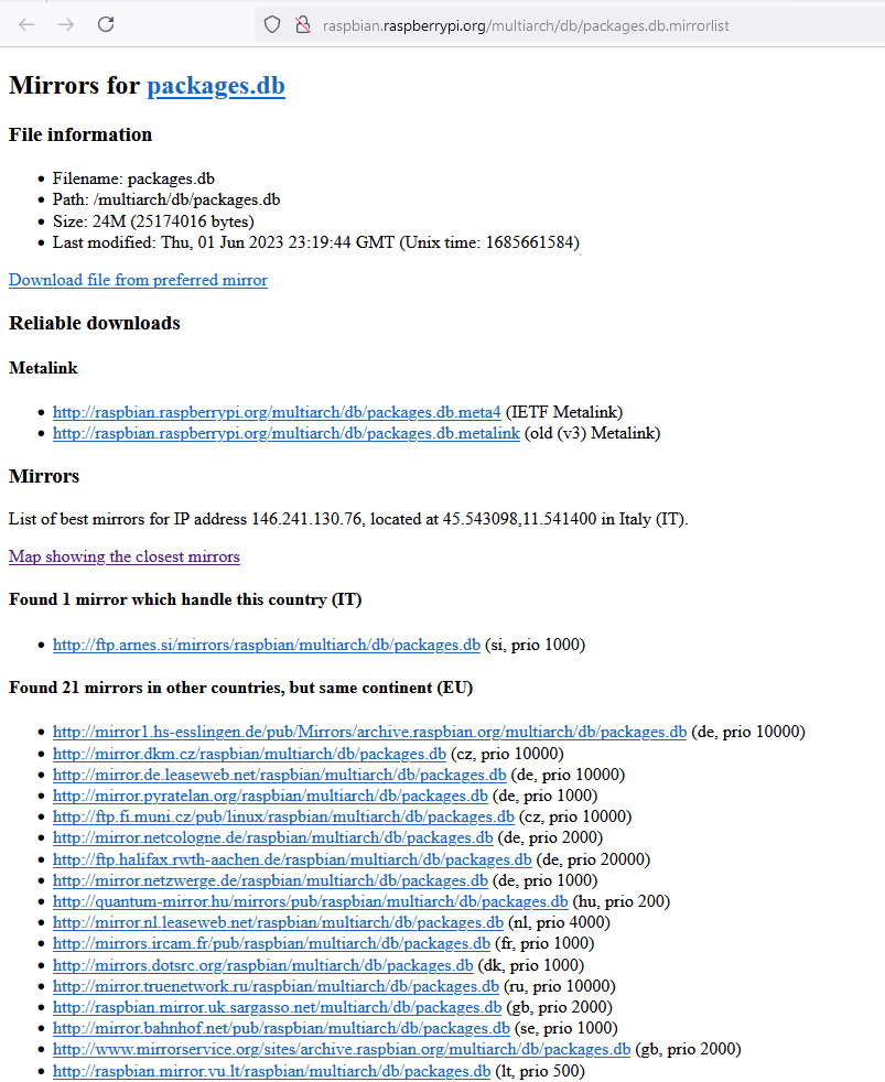

Err:8 http://raspbian.raspberrypi.org/raspbian buster/main armhf keyboard-configuration all 1.193~deb10u1
Could not connect to raspbian.raspberrypi.org:80 (93.93.128.193), connection timed out
Err:9 http://raspbian.raspberrypi.org/raspbian buster/main armhf libxxf86dga1 armhf 2:1.1.4-1
Unable to connect to raspbian.raspberrypi.org:http:
Err:10 http://raspbian.raspberrypi.org/raspbian buster/main armhf libwayland-server0 armhf 1.16.0-1
Err:11 http://raspbian.raspberrypi.org/raspbian buster/main armhf libepoxy0 armhf 1.5.3-0.1
Err:12 http://raspbian.raspberrypi.org/raspbian buster/main armhf libevdev2 armhf 1.6.0+dfsg-1
Err:13 http://raspbian.raspberrypi.org/raspbian buster/main armhf libfontenc1 armhf 1:1.1.3-1
Err:14 http://raspbian.raspberrypi.org/raspbian buster/main armhf libgudev-1.0-0 armhf 232-2+rpi1
Err:15 http://raspbian.raspberrypi.org/raspbian buster/main armhf libwacom-common all 0.32-1
Err:16 http://raspbian.raspberrypi.org/raspbian buster/main armhf libwacom2 armhf 0.32-1
Err:17 http://raspbian.raspberrypi.org/raspbian buster/main armhf libinput-bin armhf 1.12.6-2+deb10u1
Err:18 http://raspbian.raspberrypi.org/raspbian buster/main armhf libmtdev1 armhf 1.1.5-1+b2
Err:19 http://raspbian.raspberrypi.org/raspbian buster/main armhf libinput10 armhf 1.12.6-2+deb10u1
Err:20 http://raspbian.raspberrypi.org/raspbian buster/main armhf libpciaccess0 armhf 0.14-1
Err:21 http://raspbian.raspberrypi.org/raspbian buster/main armhf libunwind8 armhf 1.2.1-10~deb10u1
Err:22 http://raspbian.raspberrypi.org/raspbian buster/main armhf libutempter0 armhf 1.1.6-3
Err:23 http://raspbian.raspberrypi.org/raspbian buster/main armhf libwacom-bin armhf 0.32-1
Err:24 http://raspbian.raspberrypi.org/raspbian buster/main armhf libxt6 armhf 1:1.1.5-1+b3
Err:25 http://raspbian.raspberrypi.org/raspbian buster/main armhf libxmu6 armhf 2:1.1.2-2+b3
Err:26 http://raspbian.raspberrypi.org/raspbian buster/main armhf libxpm4 armhf 1:3.5.12-1+deb10u2
Err:27 http://raspbian.raspberrypi.org/raspbian buster/main armhf libxaw7 armhf 2:1.0.13-1+b2
Err:28 http://raspbian.raspberrypi.org/raspbian buster/main armhf libxcomposite1 armhf 1:0.4.4-2
Err:29 http://raspbian.raspberrypi.org/raspbian buster/main armhf libxfont2 armhf 1:2.0.3-1
Err:30 http://raspbian.raspberrypi.org/raspbian buster/main armhf libxft2 armhf 2.3.2-2
Err:31 http://raspbian.raspberrypi.org/raspbian buster/main armhf libxkbfile1 armhf 1:1.0.9-2
Err:32 http://raspbian.raspberrypi.org/raspbian buster/main armhf libxmuu1 armhf 2:1.1.2-2+b3
Err:33 http://raspbian.raspberrypi.org/raspbian buster/main armhf x11-utils armhf 7.7+4
Err:34 http://raspbian.raspberrypi.org/raspbian buster/main armhf x11-xkb-utils armhf 7.7+4
Err:35 http://raspbian.raspberrypi.org/raspbian buster/main armhf xauth armhf 1:1.0.10-1
Err:36 http://raspbian.raspberrypi.org/raspbian buster/main armhf xbitmaps all 1.1.1-2
Err:37 http://raspbian.raspberrypi.org/raspbian buster/main armhf xfonts-encodings all 1:1.0.4-2
Err:38 http://raspbian.raspberrypi.org/raspbian buster/main armhf xfonts-utils armhf 1:7.7+6
Err:39 http://raspbian.raspberrypi.org/raspbian buster/main armhf xfonts-base all 1:1.0.5
Err:40 http://raspbian.raspberrypi.org/raspbian buster/main armhf xinit armhf 1.4.0-1
Err:41 http://raspbian.raspberrypi.org/raspbian buster/main armhf xserver-xorg-video-amdgpu armhf 18.1.99+git20190207-1
Err:42 http://raspbian.raspberrypi.org/raspbian buster/main armhf xserver-xorg-video-radeon armhf 1:19.0.1-1
Err:43 http://raspbian.raspberrypi.org/raspbian buster/main armhf xserver-xorg-video-ati armhf 1:19.0.1-1
Err:44 http://raspbian.raspberrypi.org/raspbian buster/main armhf xserver-xorg-video-fbdev armhf 1:0.5.0-1+b2
Err:45 http://raspbian.raspberrypi.org/raspbian buster/main armhf xserver-xorg-video-nouveau armhf 1:1.0.16-1
Err:46 http://raspbian.raspberrypi.org/raspbian buster/main armhf xserver-xorg-video-vesa armhf 1:2.4.0-1+b1
Err:47 http://raspbian.raspberrypi.org/raspbian buster/main armhf xserver-xorg-video-all armhf 1:7.7+19+b8
Err:48 http://raspbian.raspberrypi.org/raspbian buster/main armhf xserver-xorg-input-libinput armhf 0.28.2-2
Err:49 http://raspbian.raspberrypi.org/raspbian buster/main armhf xserver-xorg-input-all armhf 1:7.7+19+b8
Err:50 http://raspbian.raspberrypi.org/raspbian buster/main armhf xserver-xorg-input-wacom armhf 0.34.99.1-1+b6
Err:51 http://raspbian.raspberrypi.org/raspbian buster/main armhf xserver-xorg armhf 1:7.7+19+b8
Err:52 http://raspbian.raspberrypi.org/raspbian buster/main armhf xterm armhf 344-1+deb10u2
Fetched 8023 kB in 30s (264 kB/s)
Installation of xinit failed
Plugin failed to install!
Seems something is wrong with your internet connectivity?
Another reason can be unreachable repositories, e.g. because of DNS blocking. Sometimes changing the repository mirror as described here helps.

Err:9 Index of /raspbian buster/main armhf libxxf86dga1 armhf 2:1.1.4-1
Could not connect to raspbian.raspberrypi.org:80 (93.93.128.193), connection timed out [IP: 93.93.128.193 80]
Sembra che intervenga un problema di rete con la connessione che si interrompe.
Purtroppo non so come porvi rimedio.
Ti ringrazio

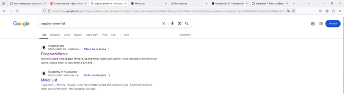

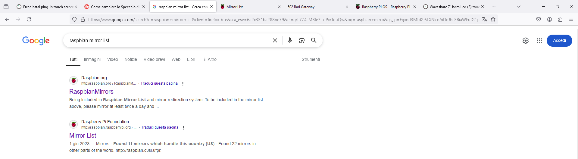

Se vado con il browser a cercare http://raspbian.org/RaspbianMirrors mi da il seguente errore :
Se invece uso il link https://www.google.com/url?sa=t&source=web&rct=j&opi=89978449&url=http://raspbian.raspberrypi.org/multiarch/db/packages.db.mirrorlist&ved=2ahUKEwiwsMjRhdWMAxVpxQIHHR2QOzIQFnoECBgQAQ&usg=AOvVaw2ucROE2NZrZQh9If1wlkWC
mi ritrovo questi mirror :
