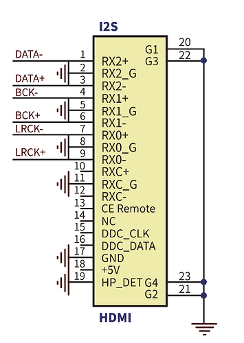

Pegasus v II has the ability to switch pin out, I don’t see that for the V1. They do have a diagram for the pin out in the manual, so maybe Volumio can help you with that.
Also Important to set the output device in the playback options to s/pdif +aes/ebu + i2s if it was on USB. Those are separate and won’t work simultaneously.

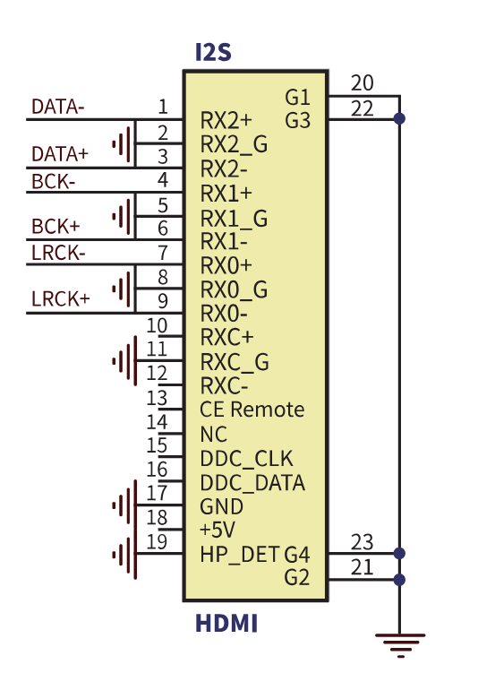

Many thanks. Is that the pins for v1, where did you find it? I could not find it at musician-audio.com.
But seems to not match, I think.
Yes. Thanks. Also I use a AQ cinnamon HDMI. Should work I hope.
I googled for the manual of the musician Pegasus version 1 manual. musician audio R2R DAC PEGASUS Discrete Balanced User Manual
