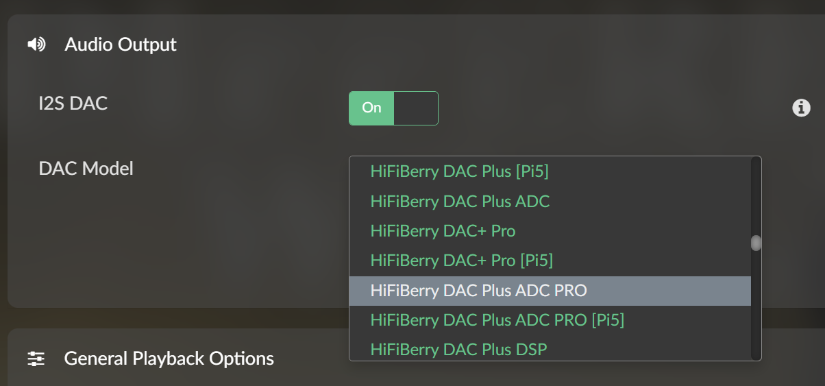

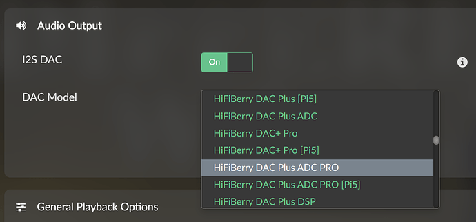

looking at the datasheet, the HiFiBerry DAC2 ADC Pro makes use of the same dt-overlay of the older HiFiBerry DAC Plus ADC Pro
dtoverlay=hifiberry-dacplusadcpro
The latter one is supported with Volumio, so if you select this model the HiFiBerry DAC2 ADC Pro will works just fine with your RPi3B+
For simple playback, even the Volumio free subscription is enough.
For making use of the ADC input, the Premium subscription is required
