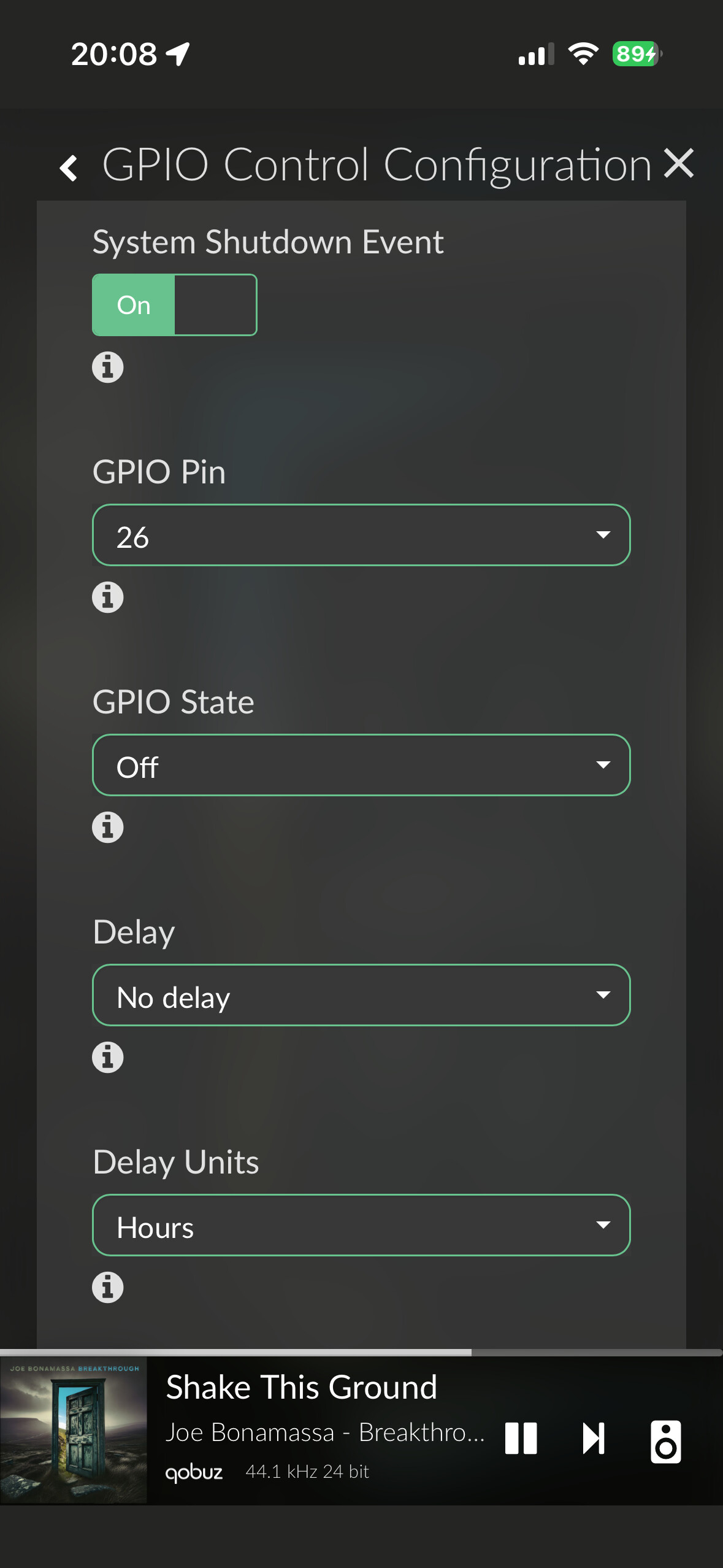

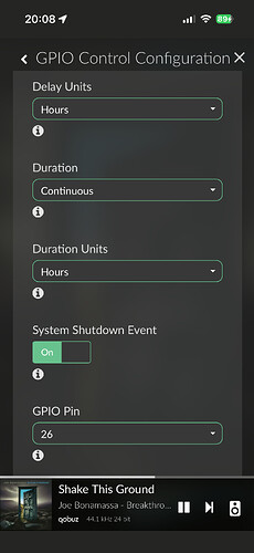

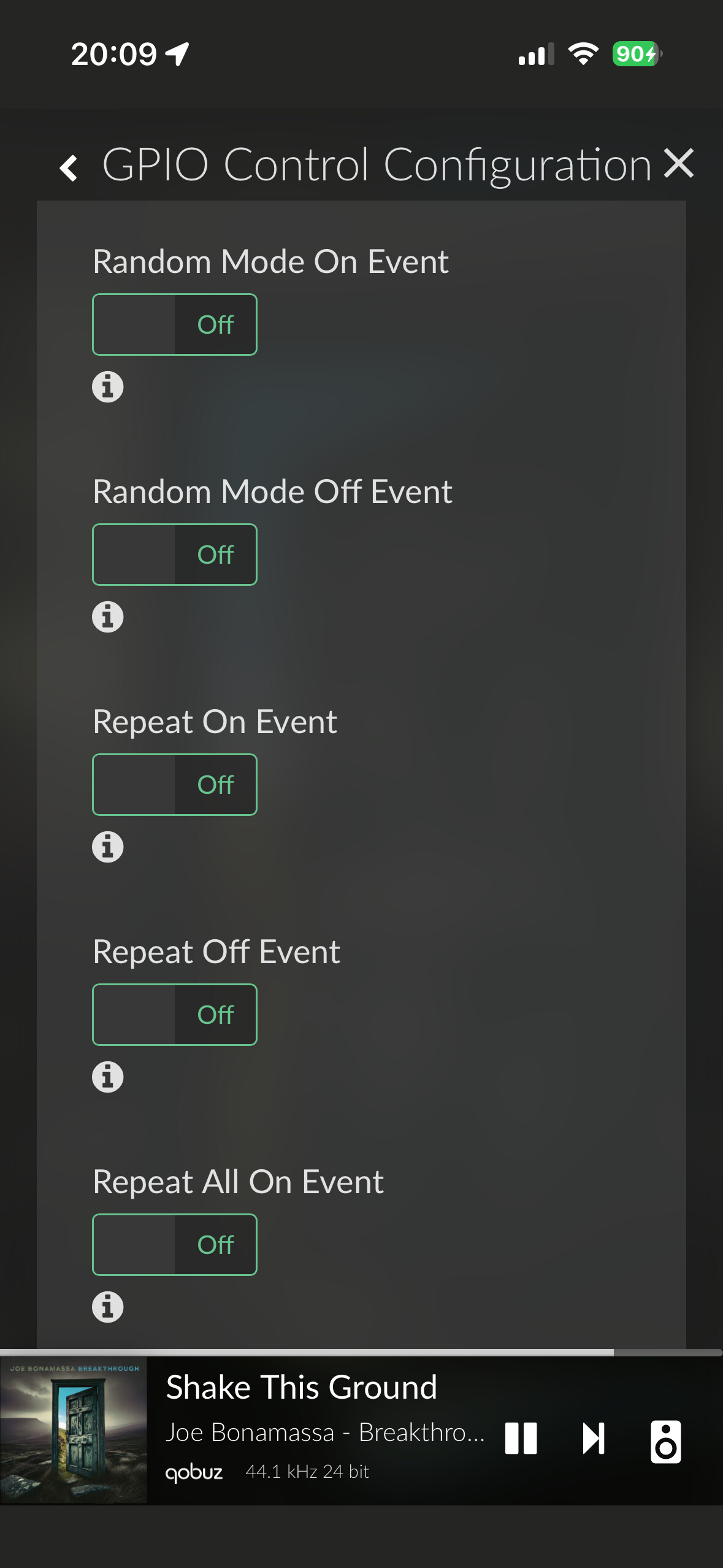

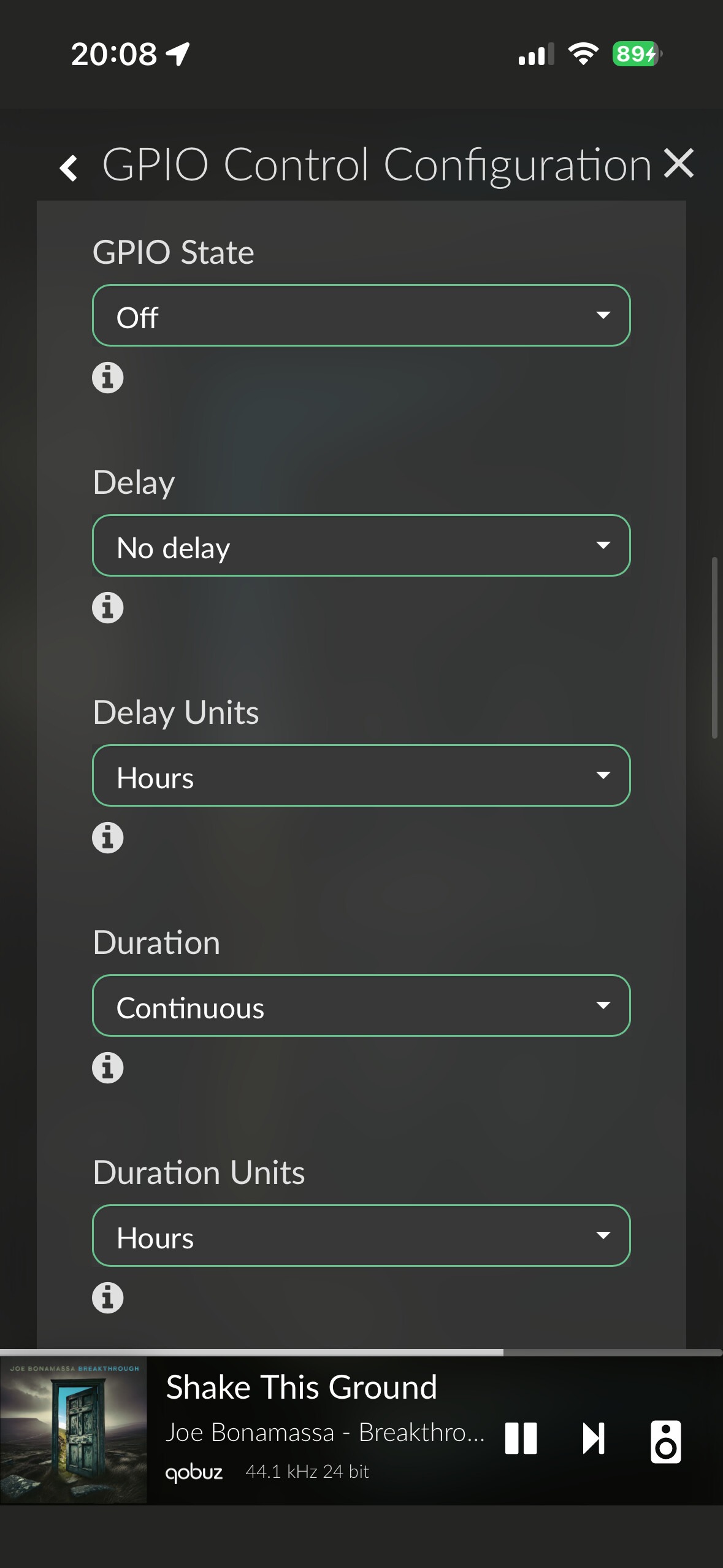

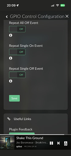

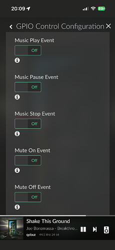

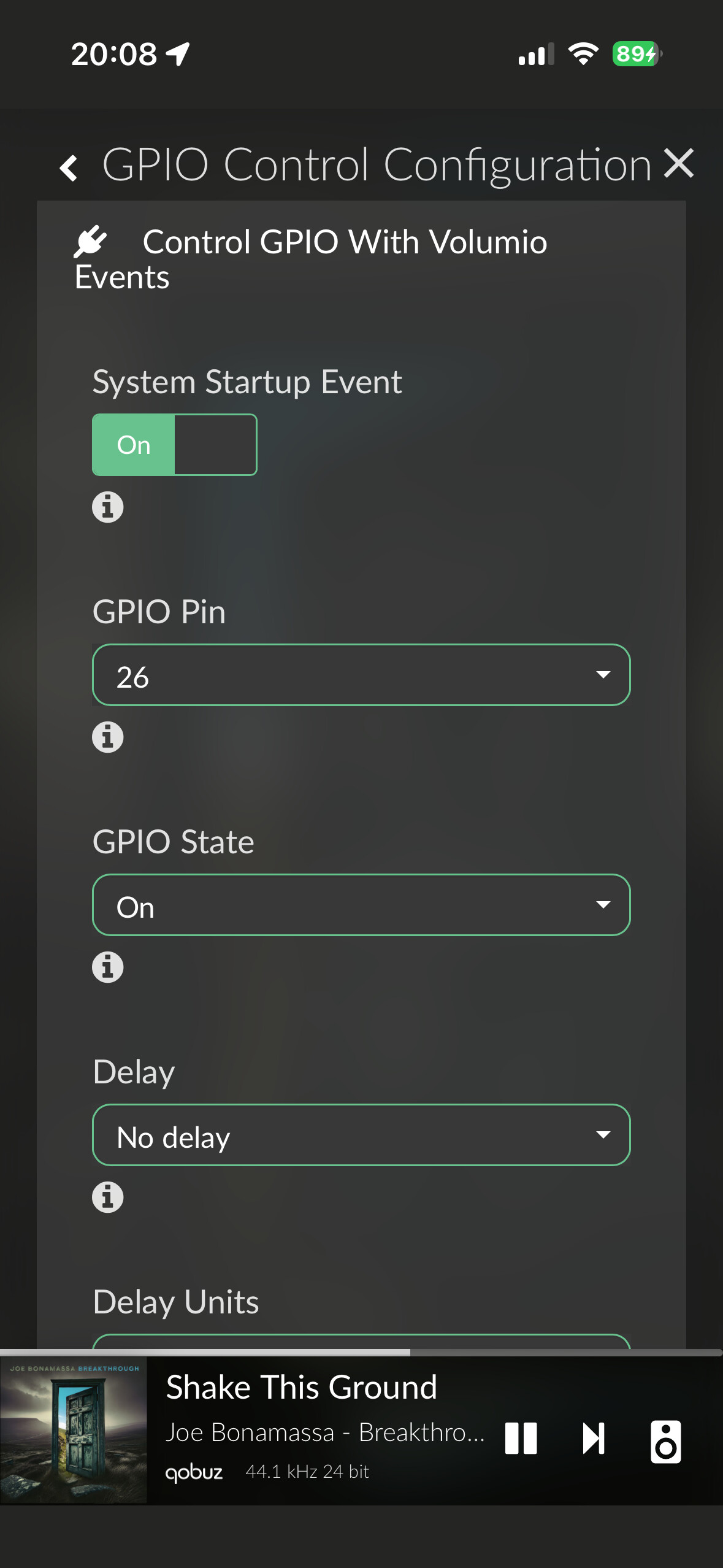

Hi mchief,I implemented the same project, but in a less professional way :slight_smile: I’m also using a Pi5 and Hifiberry. I tried to control a ‘status LED’ via GPIO 26 using the plugin, but there’s always at least 2.7 V present—even when it’s ‘on’ it’s only 3.3 V. How do you realize this?
Concrats to your project!
P.S.: Took your config files but display didn´t rotate from start on. After Volumio is up, the touch plug-in works fine.
Hi Michael
I use GPIO 26 and GND next to it.
My configuration in the plugin is as follows
Hi mchief,
thanks for your reaction. That´s strange I take the same configuration…
regards Michael
Maybe a mistake on the board of the Pi
