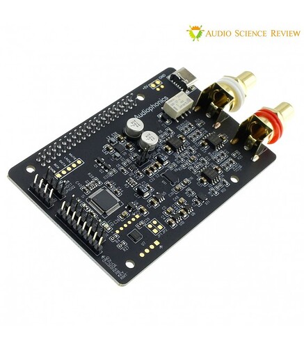

I have the following Dac card Saber ES9038Q2M
which is from Audiophonics, wondering if anyone here knows how to do it or what is needed to be able to run S/pdif from the dac card?

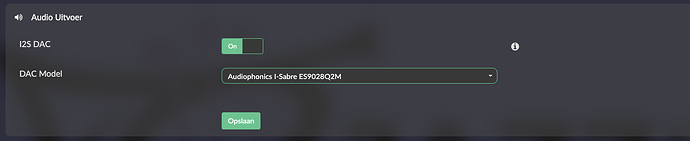

Install from the plugins:
Audiophonics Evo Sabre
Coincidentally, I recently made such an audiophonics dac hat for someone.
If you only have the DAC card, you can only select SPDIF via a small OLED screen with a rotary encoder.
another way is via ssh (alsamixer) and select the sound card and activate spdif.
I then used this i2s output.
and this dac hat.
I also took a few pictures at the time.
normal i2s
encoder push (spdif)
Thanks for reply
but do I need any S/pdif card for the following dac card ES9038Q2M, or how else do I connect a s/pdif signal
is SPDIF in, so connect a CD or other device with a coax out signal and then switch to SPDIF and you will then get sound via the Ess Sabre DAC left and right stereo output.
