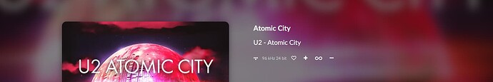

On both applications the tracks show high resolutions but on DAC still 44.1

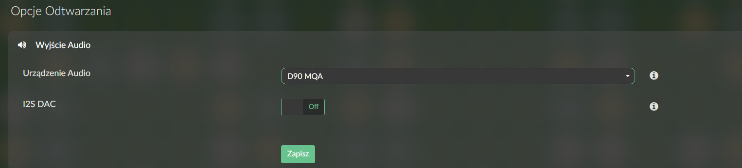

I assure you that the DAC is visible in the settings and is set up.
As you see below i play hi res song via Volumio app
