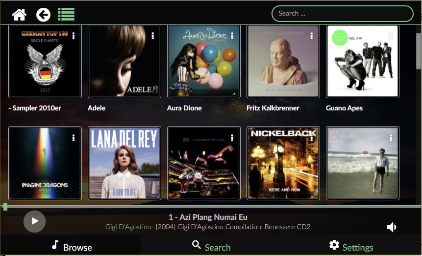

Hi together, now I’m ready with the new css files v3.
The follow things are implemented:
- albumart border and shadow
- trackinfo container now complete moveable and sizeable
- title, artist, album, rate complete separat sizeable
- play buttons sizable
- textwrap instead dots… at the end of line
- border for album cards at main view
- background darkness configurable to make the background a little bit lighter or darker
- all settings are configurable as variables, no more search is needed
It’s now useable for all small displays 3,5" 7" and large 1920x1080 or 1920x480
here a little sample how it looks:

I have make a little bugfixing for some display resolutions. And in addition now the landscape view is complete dynamical. You can resize the albumart and the title view use the empty space on the right side. No more overlapping.
All settings find you on the top of css. Have you already installed the UI-support only the css are changed.
Here is the v4

Hi 2aCD, with your 2nd file, this is what I got.
1st picture is from my computer screen which I change the font to be a little bigger which I like.
2nd picture is from my show screen 15.4" 1280x800 that attached to TBS. It doesn’t change on font size on both Title and Sample rate. The album artwork is also square and no shadow.
